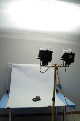

Here's another improvisation just to get you thinking. I pulled out a set of 1,000-watt halogen work lamps from the storage room and aimed them at the model from a safe distance. Even with a two-unit setup, such high-intensity light without any diffusion created harsh shadows. Next I shone the lights on the white ceiling above the models. This is called reflective or bounce lighting and has the same effect as the diffuser. It spreads and softens the lighting.
I wouldn't recommend buying halogens specifically for model photography as they're too hot and clumsy, but if you already have something like this and only shoot your models a couple of times a year, you might be able to refine a solution.

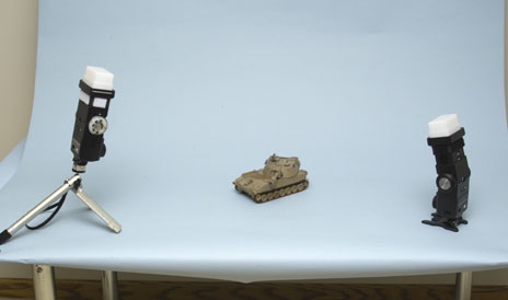

I've shown some common, inexpensive light-diffuser/reflectors you might try. I use the Stofen Omni-Bounce diffusers on top of my flashes. Watch the photographer pool during the next Presidential photo-op or keep an eye on the paparazzi's gear as they're chasing Paris Hilton around New York. I bet half the cameras there will be adorned with these little plastic devices. The Omni-Bounce is basically a diffuser like my vinegar-jug bottom. It may help when you're shooting a celebrity across the street. However, flash puts out an enormous amount of light in a brief burst, and up close on models, I find the Omni-Bounce to be less-than-perfect at providing the soft light we'd like.
Another setup includes Lumiquest 80/20 bounce reflector. This light modifier emulates the effect of ceiling bounce flash by placing a reflective surface in the path of the flash and diffusing the reflected light with the translucent covering. The results are about like the Omni-bounce, and still not as good as my hardware-store reflectors or ceiling bounce.

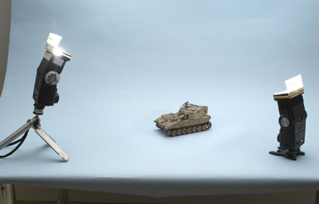

A little experimentation will turn up a workable setup for your equipment. I found the best hack with these old boys was to bounce them off the ceiling and throw in the oldest press-photographer's trick in the book. I attached a piece of white card stock to the back of the flash head (it's an FSM business card). The card catches some of the light spilling out of the flash head and directs it toward the subject. Presto, I had both soft bounce light from the ceiling and just enough fill light reflected from the card to lighten up shadows around the tracks and behind all the gear tanks carry.
Senior Editor Matt Usher, a former news photographer, says he's also seen photographers "rubber-band" spoons to the backs of their flash units to make the mini-reflector in a pinch.
