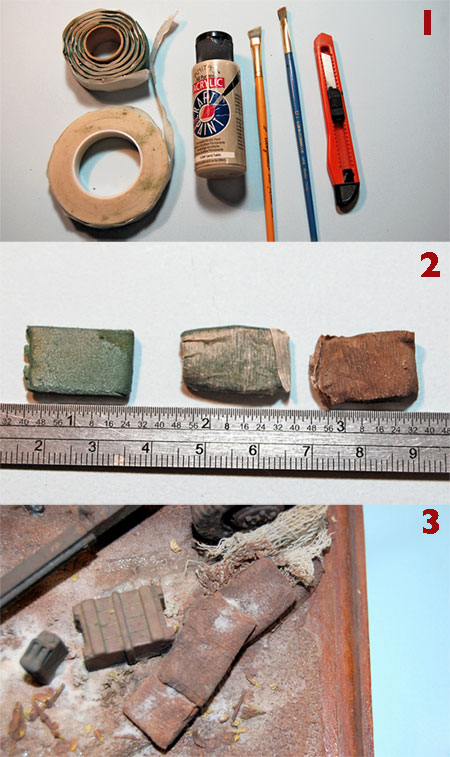

Here’s what you’ll need:
• Green floral putty or clay (It’s sold in rolls or bricks, but rolls work best for sandbags. The rolls are about 2' long and 1⁄2" wide.)
• Green floral tape
• Scissors and hobby knife
• Paint for sandbags (typically tan or olive drab)
