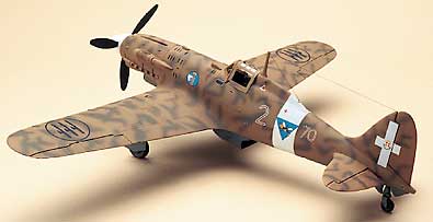

I assembled the kit according to the instructions, but I found that in most cases, fit was a problem. Large gaps required filling at the wing roots and horizontal stabilizers. The cockpit floor had to be narrowed to fit inside the fuselage. Noticeably misshapen is the lower cowl for the 202; it is not deep enough, creating a drastic step to the fuselage. You would have to shim and fill the back end to make a smooth transition to the fuselage. It could be that my sample was malformed. Few of the photoetched parts fit into their appropriate places without modifying either them or the surrounding resin. The instructions specify a 1/8" hole for mounting the tail-wheel assembly, but this should be 1/16".
The white-metal landing-gear oleo scissors and the pitot tube were missing from my sample. I found the white-metal canopy frame to be fragile and hard to keep in proper shape. Attaching the clear plastic windscreen panes to the metal frame is a real bear. The finished windscreen isn't angled properly and looks too upright. You're on your own when it comes to the right height of the sliding canopy section. Repeatedly test fit and trim until it looks right on the fuselage.
I painted the kit overall Polly Scale Earth Yellow and Neutral Gray, with a disruptive pattern of Fokker Dark Green. After a coat of clear gloss, I started decaling. What a difference from the rest of the kit! These decals are a dream; they are thin and laid down into every panel line without setting solution. There's little clear carrier film that needs to be trimmed away, and when the decals are dry, they look painted on! I wrapped up the model with a monofiliment antenna wire and a shot of clear flat.
The overall dimensions of Craftworks' C.202 scales well with the data and drawings in La Bancarella Aeronautica's Aer Macci C.202.
I spent 30 hours on my model, most of that on figuring out part locations, then cleaning up the parts to fit. Expert modelers will want to spend much more time to make the quality of the fit match that of the detail. I recommend this kit only to experienced modelers.
