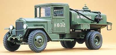

I started assembly with the chassis. Fort provides a one-piece frame, but locations for the alignment pins on the suspension parts are vague. Take care so that all tires touch the ground when final assembly time comes along.
It is not clear how the additional spring units (part Nos. 6 and 7) attach to the main springs and frame. The truck body and fuel tank are made from many panels, so take care to align them during assembly. I left off the rear section of the cab until everything was painted, so I could detail-paint the cab's interior. I also left off the roof and windows until final assembly.
The fuel tank fit well, but some filling was required on the end caps and the upper side seams. Don't bother filling the lower side seams, as they are covered by the fenders. The tank supports (63) have some sinkholes, but they are barely noticeable when the tank is installed onto the frame. I added all of the details to the tank except the pump assemblies, and I was ready to paint.
I airbrushed my subassemblies with Testor Acryl Medium Green as a base coat. When it was dry, I sprayed the decal areas with Future floor polish. The decals looked like trouble, especially with their flat finish, so I was pleasantly surprised to find that Micro Sol softened them enough to snuggle down into the engravings. A coat of Future was applied over the dry decals, and then the entire model was sprayed with Polly Scale flat finish.
During final assembly, I discovered that the spare tire would not fit in its rack. I had to nip off the small tabs on the inside of the rack supports (43) to provide enough room. The windows were tough to fit on my sample; advanced modelers might want to replace them with clear sheet stock. I used Bare-Metal foil on the insides of the headlights, but the clear lenses were too big and needed a lot of sanding.
Finally, the pump hoses were added after they were painted Polly Scale satin black. The instructions show two hoses being applied to one pump, but the box art shows a hose on each side on the top fitting of each pump. I decided to attach them to one pump and loop the excess around on the top of the vehicle.
I spent about 15 hours building my tanker, a little less than normal due to the simplified detail and one-color paint scheme. I could not locate references on the fuel truck version of the ZiS-5, but a measurement of the wheelbase and track width matched exactly to the specifications of the cargo truck version in The Illustrated Encyclopedia of Military Vehicles by Ian Hogg and John Weeks.
While there is nothing difficult about building the kit, the quality of the moldings and fit make it a model for the intermediate builder. It looks good out of the box, but devoting additional effort (especially removing many of the ejector pin marks) could really turn the kit into a showpiece.
