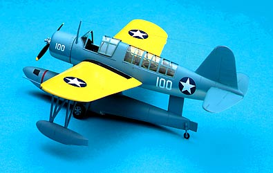

I liked the unusual training scheme of blue-gray over light gray with chrome yellow wings, and airbrushed the model with Testor Model Master enamels. The decals look good, but are brittle and translucent; even the low contrast between the camouflage colors can be seen through the white "100" on the fuselage sides.
I had one more problem: The plastic prop blades were a little too long, and the propeller collided with the top of the float.
In the end, the model looks pretty good. I spent nearly 50 hours on this one and could have spent more if I had succumbed to the suggested interior detailing. The finished model scales precisely to the dimensions in my references: Squadron/Signal's OS2U Kingfisher in Action, and Phalanx's Fantail Fighters.
