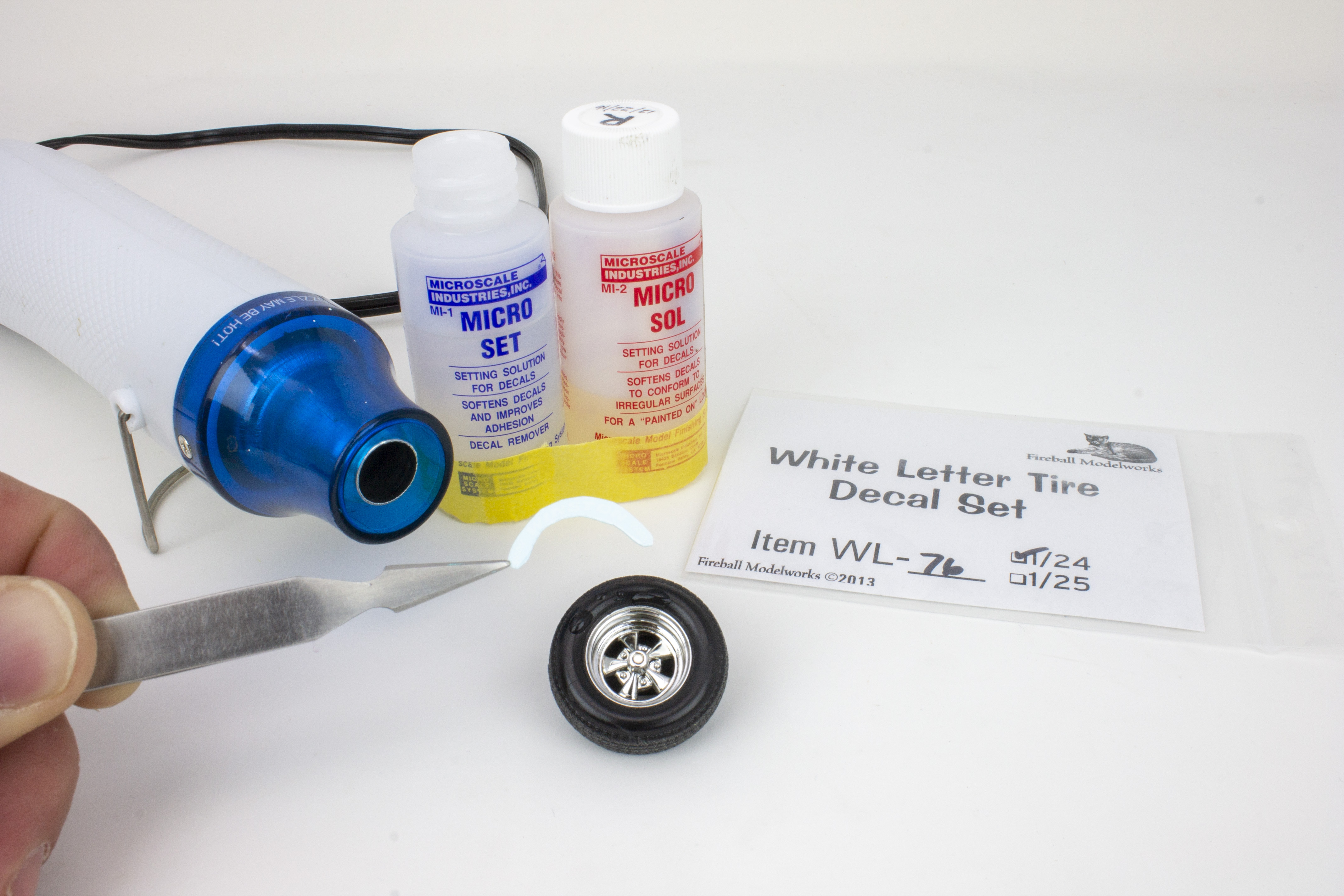

While water-slide decals have been common in automotive model kits for decades, placing them on tires is difficult. It is a good idea to apply the decal late in the build to avoid handling and flexing the tire. Here are a few tips to achieve that and better-looking tires overall.
Begin by scuffing the tire tread (not the sidewalls) with a 100-grit sanding stick. This will turn the tread slightly gray with a worn look. This Cragar mag wheel was treated with a light coat of Tamiya Smoke (No. X-19) to give it a realistic sheen.

Using a raised white-letter decals, such as this Winston Winner G/T set (No. WL-76) from Fireball Modelworks, trim each decal as close to its edges as possible. These decals lay down nicely using a generous amount of Micro Set and a little heat from a heat gun.
