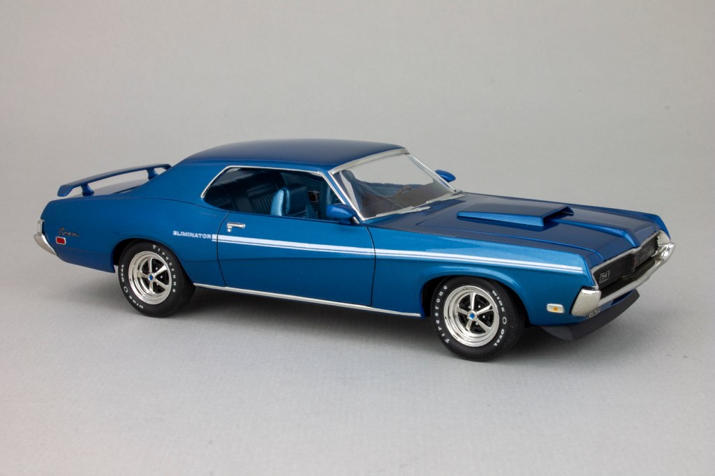

Building model car kits can be a satisfying pastime and hobby, enjoyable for young and old alike. To successfully complete plastic car model kits, you’ll need to develop skills and techniques that are transferable to other types of scale model kits. But the hobby also strengthens forethought, ingenuity, creativity, and determination.
When you pick your first kit, there are a few things to keep in mind:
  • Make sure the model car kit is all plastic. Do not buy one with photo-etched metal or resin parts — those are for experienced builders.
  • Pick a car whose finish can be a single color. Painting with spray cans is a good way to learn how to paint model car kits, and a single-color body and interior will be helpful.
  • There are thousands of plastic car model kits available. Choose one that interests you, so you’ll want to finish it.
In this case, we’ll use an AMT 1/25 scale 1969 Cougar Eliminator because it has a limited number of parts and isn’t too difficult to build.

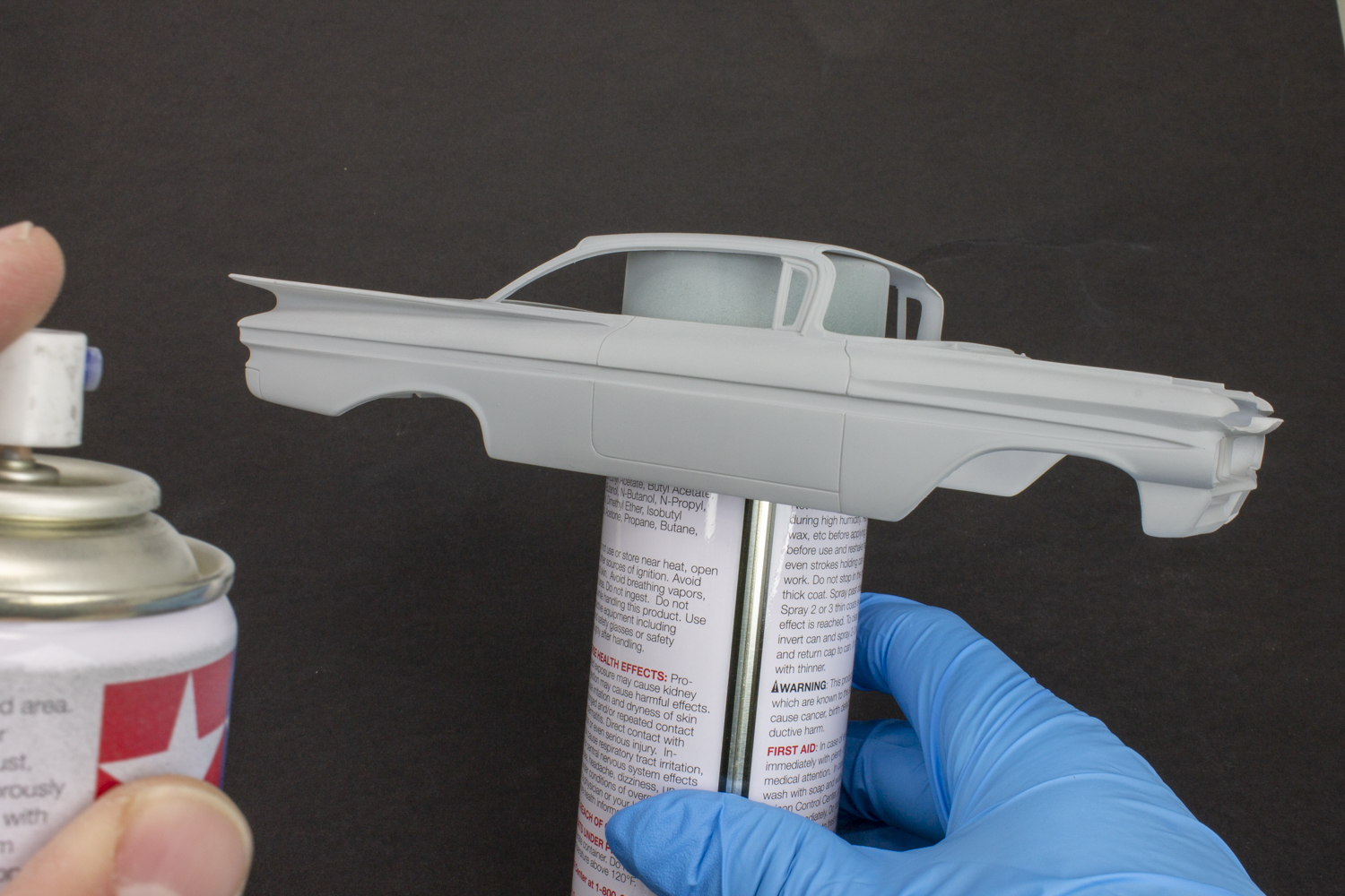

Apply double-sided tape to the cap of a spare spray-paint can to hold the car body in place; you can use the same technique with craft sticks for smaller parts. Alligator clips are great for grabbing a tab, such as on a driveshaft. Are you painting something tiny with little or no place to grab it? Heat the tip of a metal pin with a lighter and insert it into an inconspicuous spot on the part.

Primer is recommended to help reveal any imperfections on the car’s body and to promote better adhesion of paint. Hobby paints are recommended because they are formulated specifically for use on plastic, although some automotive paints work, too. One rule of thumb is to stick with the same brand and line of paint to avoid mishaps. Tamiya primer and lacquer paints are readily available from hobby shops and online and work well. Priming the other subassemblies (engine, interior, suspension, etc.) is less critical and up to you.
FSDBC0323_10
When spray painting the body, I like to work from the bottom up in a snaking path until I reach the roof and repeat on the other side. I then spray the trunk, roof, and valances. Always begin and end the paint flow pointed away from the body, not directly at it, to avoid paint spatters. Typically, two or three coats of primer should sufficiently cover the body. If it feels too heavy or too light, experiment with the pace of your passes or the can’s distance from the model, which should be 6 to 8 inches.
