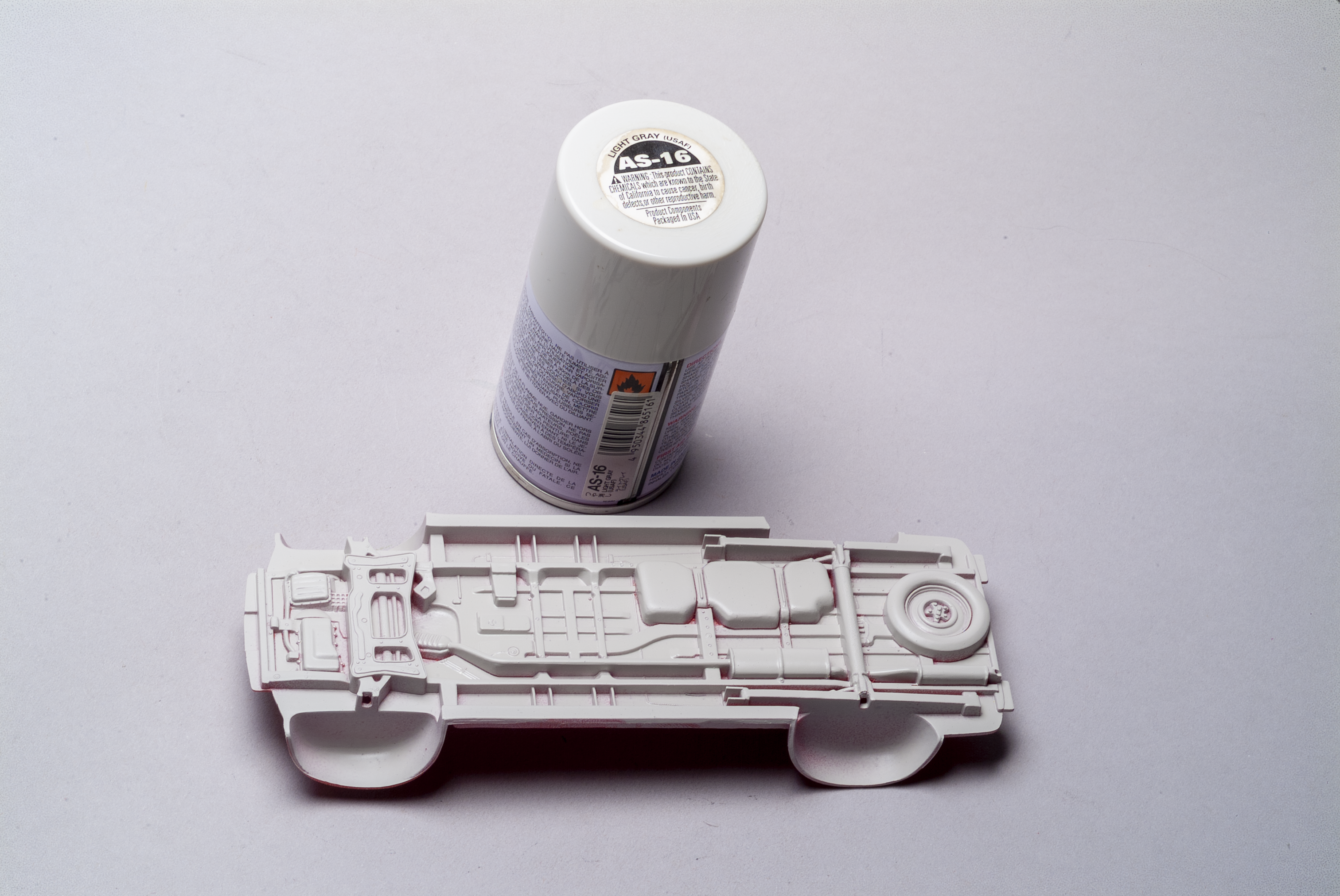

Older or basic kits often have detail molded into a single-piece chassis. It might be more work than some builders want to deal with to cut out or add detail pieces. A simple alternative is paint, and you don’t even need an airbrush!
FSDSNAP052_01
This chassis is from the Lindberg Dodge Caravan kit. It’s not particularly detailed, but it has enough to work with. Other kits with additional molded-in details will benefit even more from the following techniques.
FSDSNAP052_02
Typically, the body is the same color as the chassis, without gloss. It doesn’t have to match exactly, and coverage doesn’t have to be perfect because there will be weathering. If you can use an acrylic base coat, seal it with lacquer or enamel clear before moving on.
