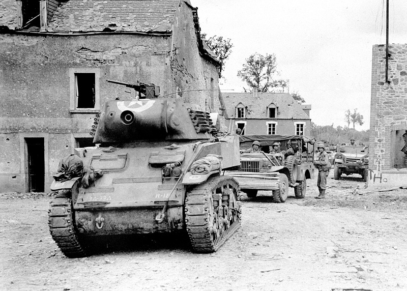

An M8 75mm HMC leads a column from Reconnaissance Company, 33rd Armored Regiment, through Montreuil-sur-Lozon, France, on July 26, 1944, during Operation Cobra. This vehicle closely resembles the one modeled in the story.
