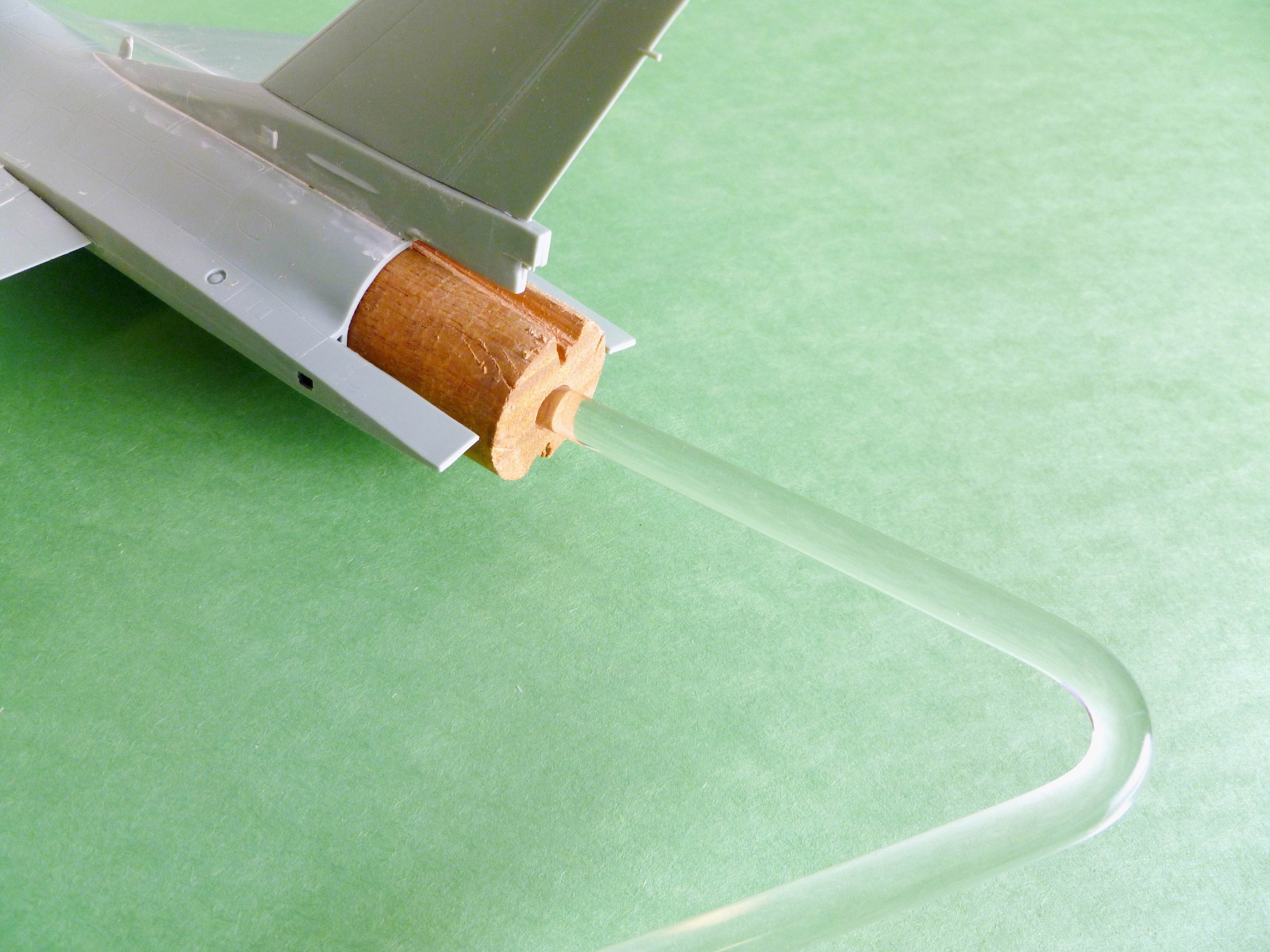

I drilled a hole in the wood plug to receive the rod. It’s a friction fit, so I can remove it from the model for transport. It also made a good grab handle during the decal process.
Epoxy holds the other end of the rod in a hole I drilled in a sufficiently weighty wood base. After a coat of Tamiya white primer, I sprayed Testors black gloss acrylic. Each tiger stripe is a separate decal; overall, it took eight hours and a lot of decal solution.

To bend the rod, I clamped a heat gun to a table and, wearing heavy-duty gloves, heated the rod in one spot until I could bend it. If you want a gentler curve, heat a larger portion of the rod and bend it around a round object.

A 1/4-inch clear acrylic rod holds the aircraft aloft and is anchored in a wood dowel in the model. The grooves were cut to allow the plug to clear internally. I used epoxy to attach the plug before installing the tailpipe — but make sure everything fits before applying epoxy.
