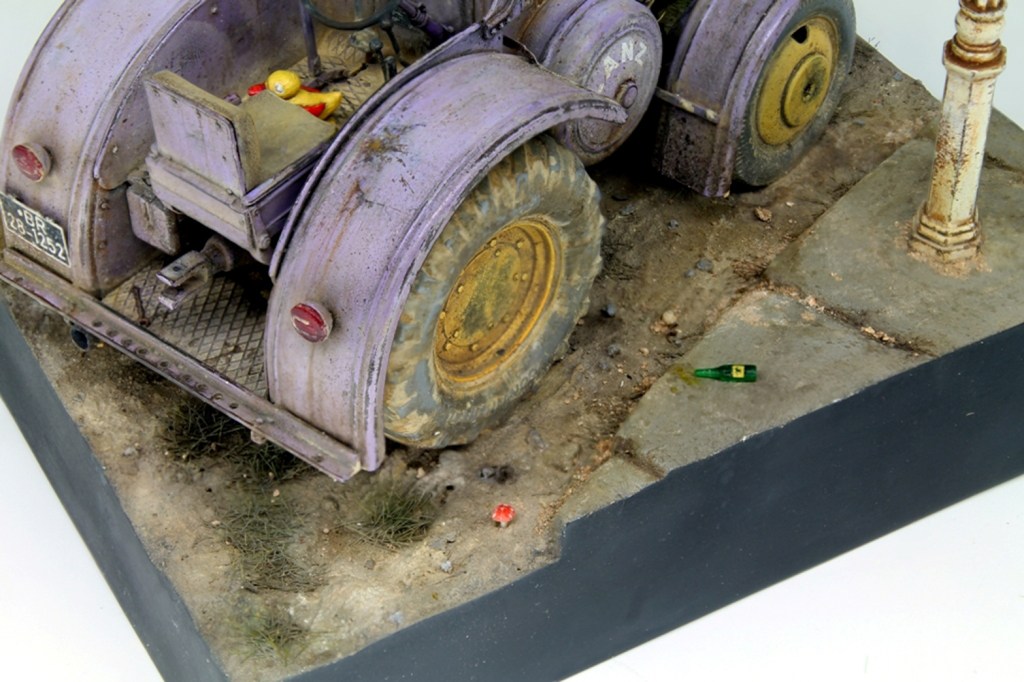

I imitated dry dust on the floor with a combination of Ammo pigments, including Light Dust (No. A.MIG-3002), Airfield Dust (No. A.MIG-3011), Africa Dust
(No. A.MIG-3003), and Sand (No. A.MIG-3012). Drops of fuel, oil, and water were added with Ammo Oilbrusher Dark Brown and Effects Brusher Fuel Stains (No. A.MIG-1801) and Fresh Engine Oil (No. A.MIG-1800).
Rust and grime streaks were added using Ammo Streaking Brusher Medium Brown (No. A.MIG-1250) and Grime (No. A.MIG-1253), as well as Streaking Rust Effects (No. A.MIG-1204) and Rainmarks Effects (A.MIG-1208) blended and shaped with enamel thinner on a fine-tipped brush.
To enhance and layer the mud and dust, I flicked on enamel products from Ammo, including Splashes Dry Earth (A.MIG-1750), Nature Effects Dark Mud
(No. A.MIG-1405), and Heavy Mud Wet Mud (No. A.MIG-1705) by raking a toothpick across the bristles of an old brush.

To tie the base into the tractor, I used the products used on the vehicle, too. New Ammo products used on the base were Middle East Dust (No. A.MIG-3018) and Splashes Dry Earth (No. A.MIG-1750), Turned Earth (No. A.MIG-1753), and Dry Steppe (No. A.MIG-1751).

When I glued the tractor to the base, I had to adjust the texture around the wheel to ensure it sat right. Diorama guides suggest adding vertical elements for visual appeal, so I opted for a MiniArt clock, an item whose height and style fit the scene. Smaller accessories by MiniArt and 3D MicroCosmos, as well as a child’s toy from Plus Model finalized the project.
I airbrushed the soil with Tamiya Deck Tan (No. XF-55) and Buff and the grass with mixes of Park Green (No. X-28), Light Green (No. X-15), and Yellow Green (No. XF-4). Stones were picked out with contrasting shades of Vallejo acrylics.
For context, the tractor needed a base. I blocked in a section of insulation foam with black styrene sheet and added a raised section that will be concrete slabs at one corner. The crosshatch pattern adds texture for the groundwork to attach to.
I applied a layer of Ammo Acrylic Sand Beach Sand (No. A.MIG-2106) to the foam. Stir this paste well before use or it won’t dry properly. While it was still damp, I sprinkled on stones and sand and added static grass.
