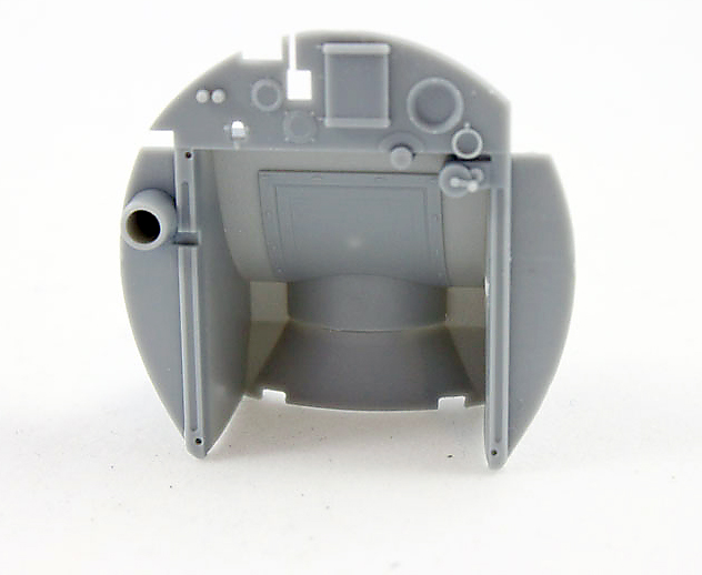

Wingnut Wings has acknowledged this importance by including a USAS boxing of its brand-new Salmson 2-A2 in 1/32 scale (along with the French boxing). Typical high-quality Wingnut Wings engineering and molding holds true throughout the kit, with sturdy attachments, lots of detail, pre-molded rigging holes, and five marking options (all for U.S. aircraft).

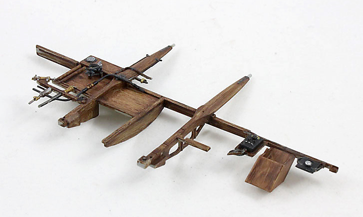

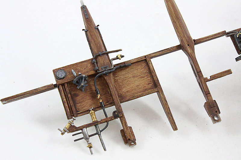

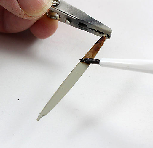

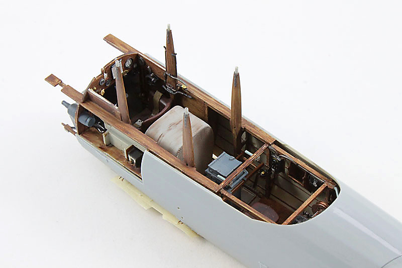

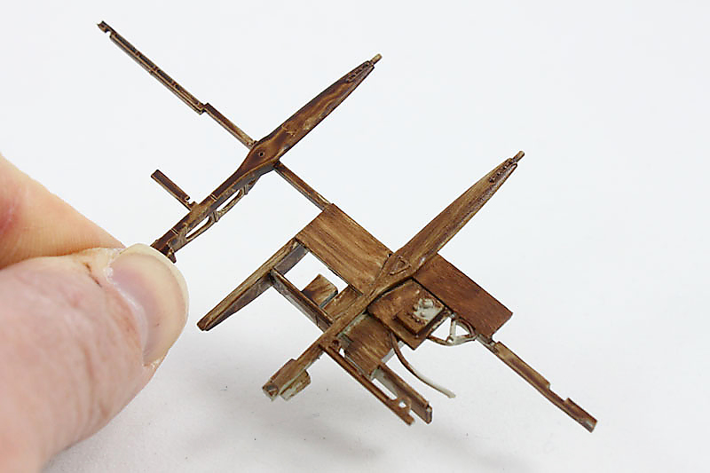

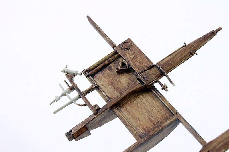

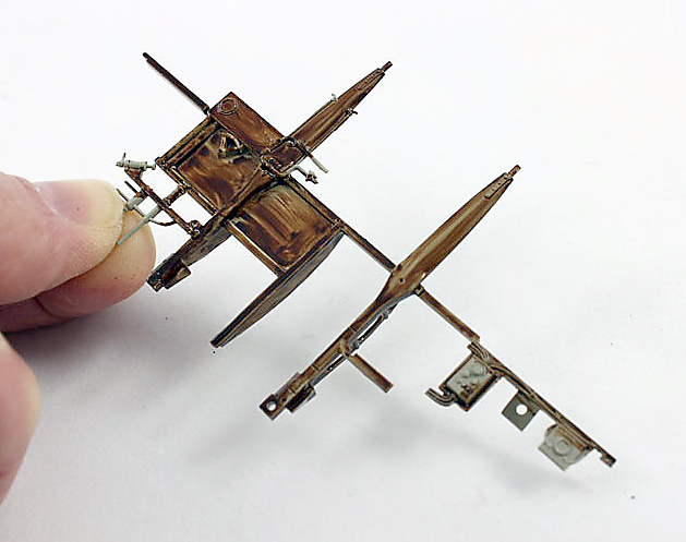

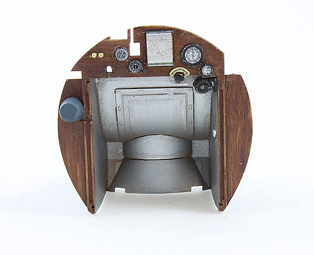

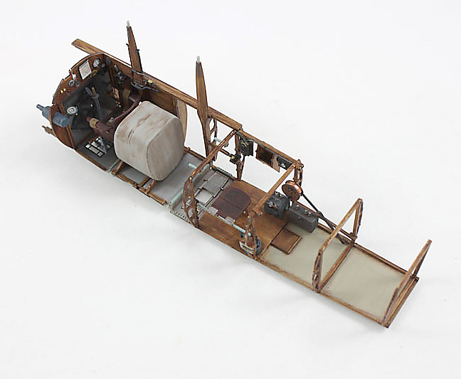

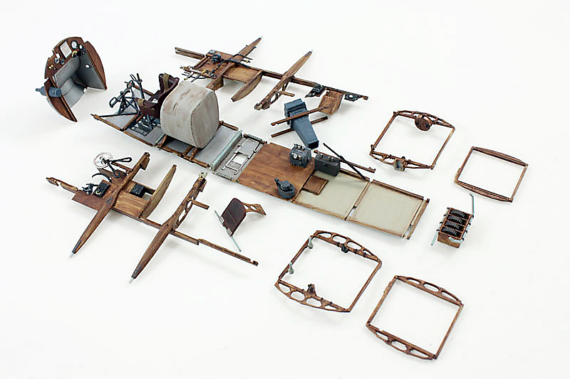

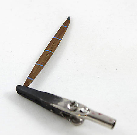

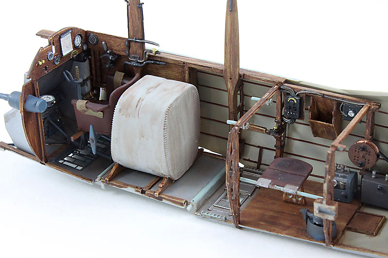

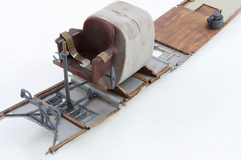

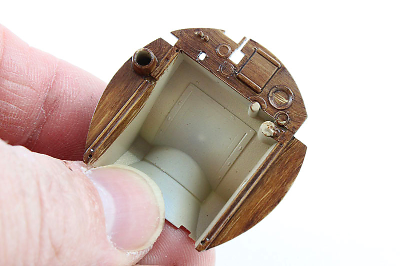

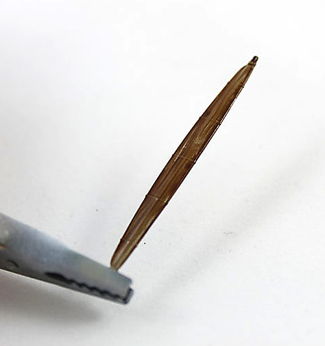

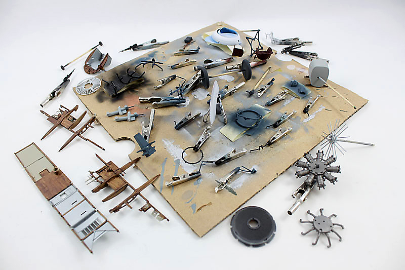

As with most aircraft of this era, you’ll need to “go native” and paint things in their naturally occurring colors. That means lots of wood treatment for the interior of the Salmson. I did so with various shades of Tamiya tan, using oil paint for faux grain. Details like the two-piece radio with knobs on the back and a clear front panel really show the thought that has gone into design. Photoetched-metal seat belts are included for the pilot — apparently the gunner just had to hang on and hope for the best.

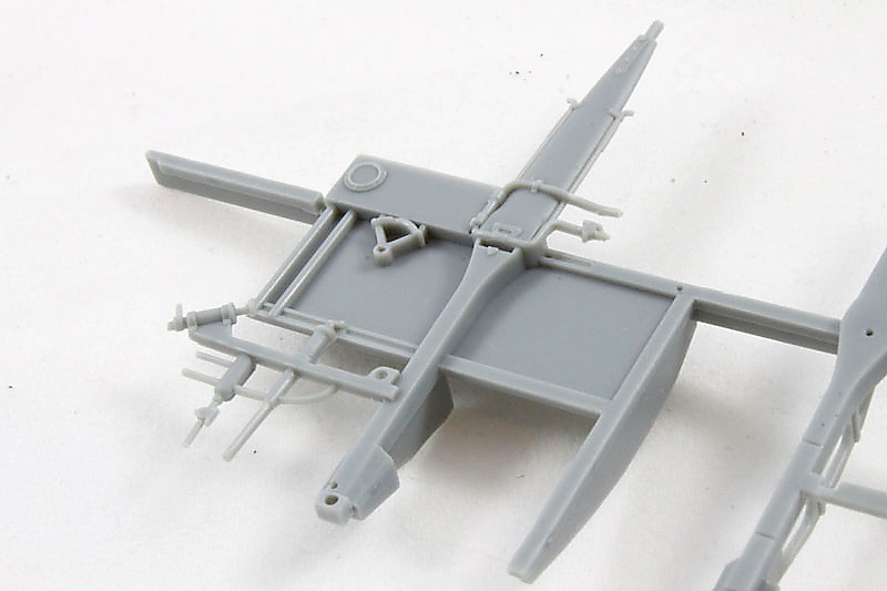

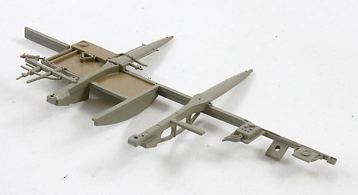

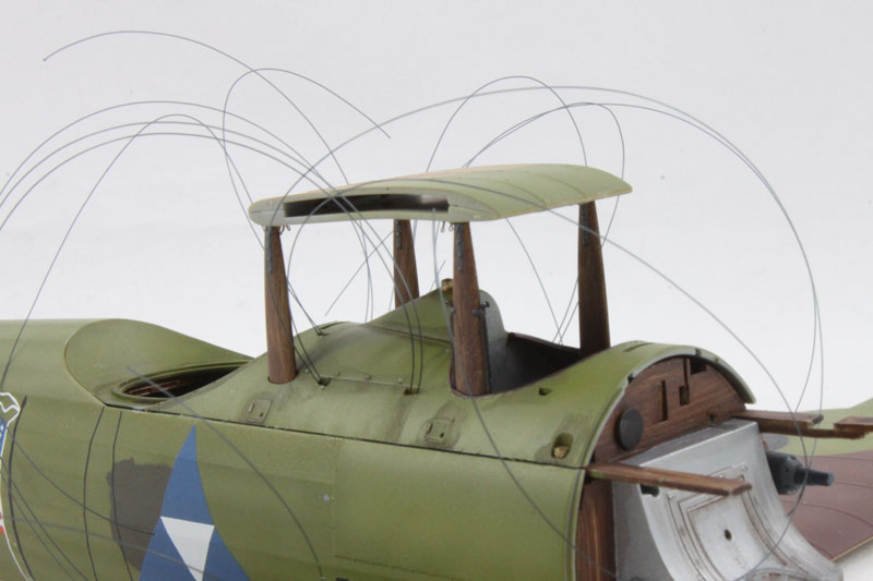

Another sign of good engineering is the inclusion of the center section struts as one-piece affairs already attached to the side panels of the interior. This removes a prime cause of misalignment for the upper wing and makes the build easier for those with less experience building biplanes.

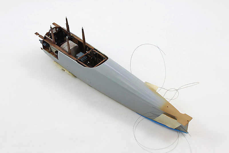

Once the various interior furnishings were complete and installed, I put the cockpit into the fuselage halves. The fit was so good I did not apply glue, preferring to allow a bit of “float” while installing the center-section turtle deck later.

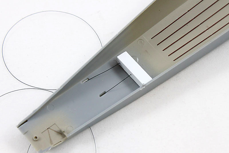

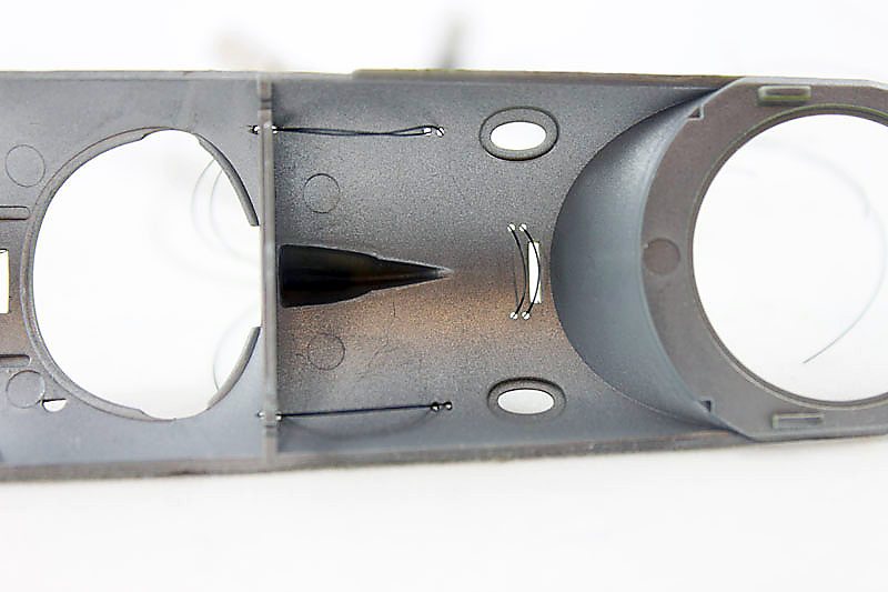

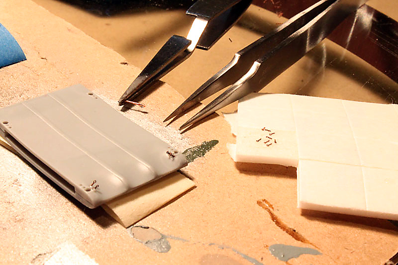

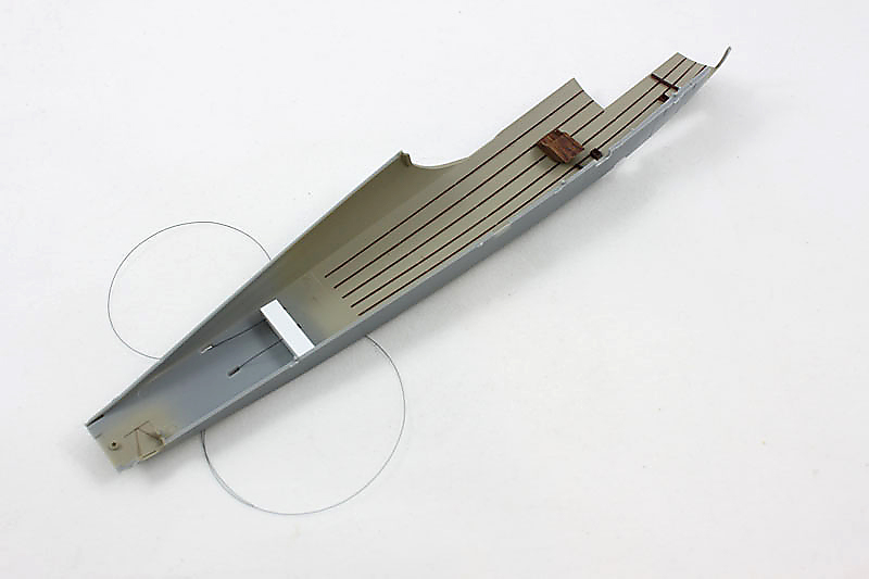

One thing I do before building any biplane is stare at the rigging diagram to plan my wiring. In this case, I added a .188″ square length of plastic inside the rear of the fuselage as an anchor point for the elevator control wires prior to closing up the fuselage. I also drilled and added wires to the various engine cowling panels using knotted pieces of nylon monofilament (.007″ medical suture).

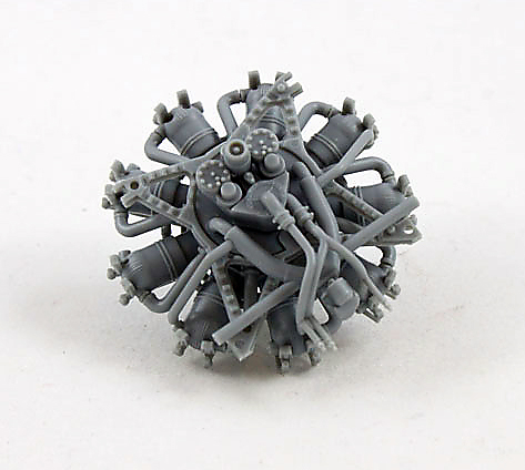

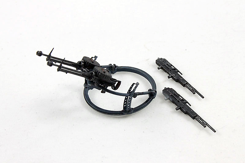

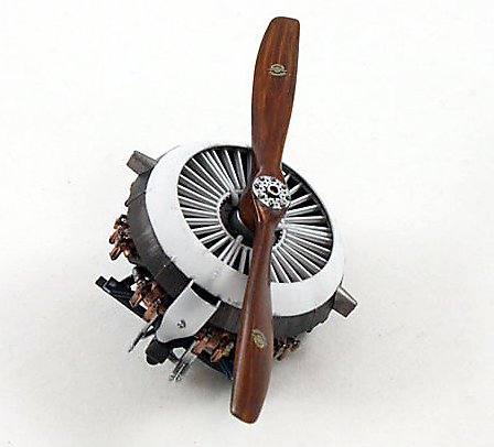

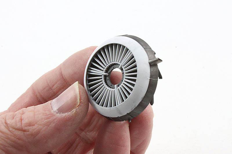

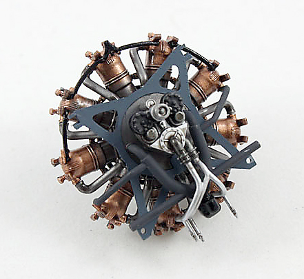

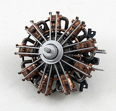

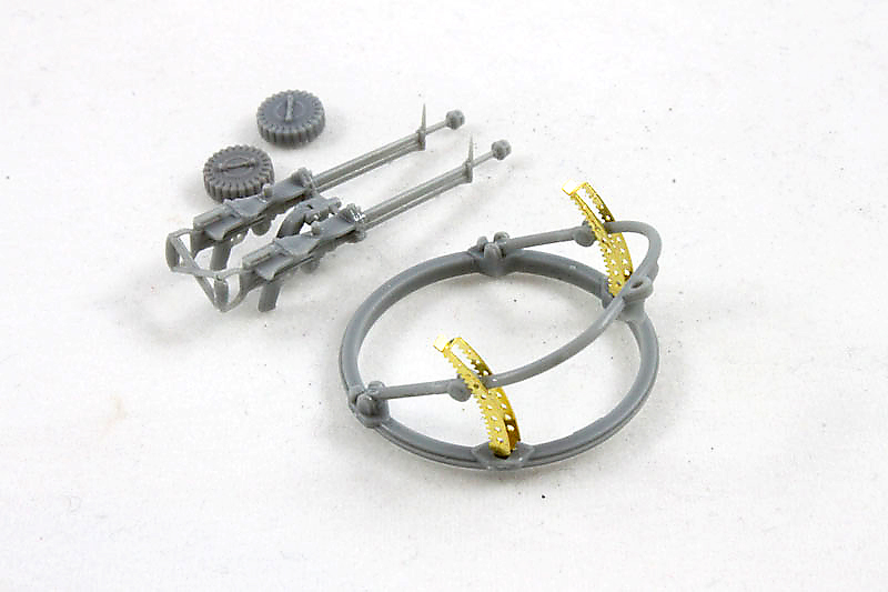

Construction proceeds rapidly once the interior is fitted out, aided by excellent fit of all the major components. I did leave the elevator off until near the end of the build because it is so thin and the mount is so small. As is the norm for Wingnut kits, the Salmson’s engine is fully detailed and includes numerous exhaust and other connections. It’s worthy of careful painting, especially if you leave any of the many cowl panels off for display. Wingnut Wings has included a Salmson armed with the rarely seen Marlin machine gun as one of the five options. I chose it for the novelty. Also included is a pair of well-molded Lewis guns for the gunner. They were the last parts added, for fear of damaging them.

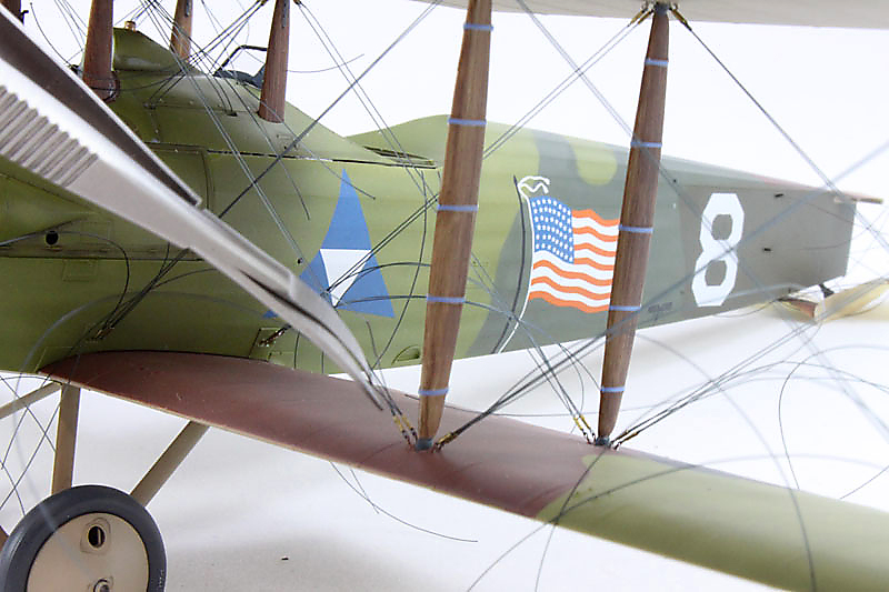

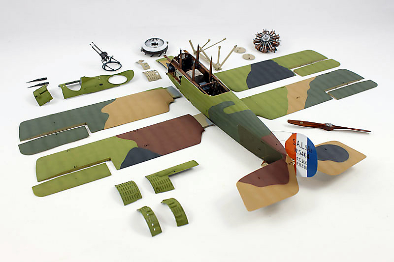

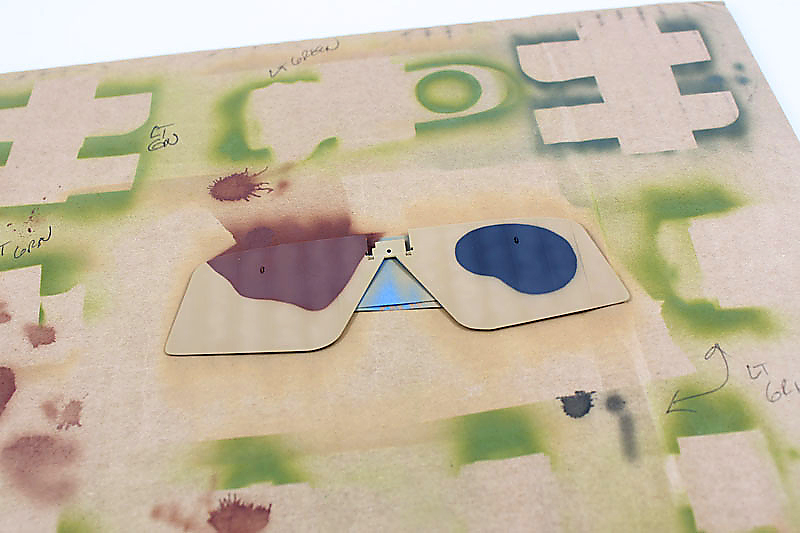

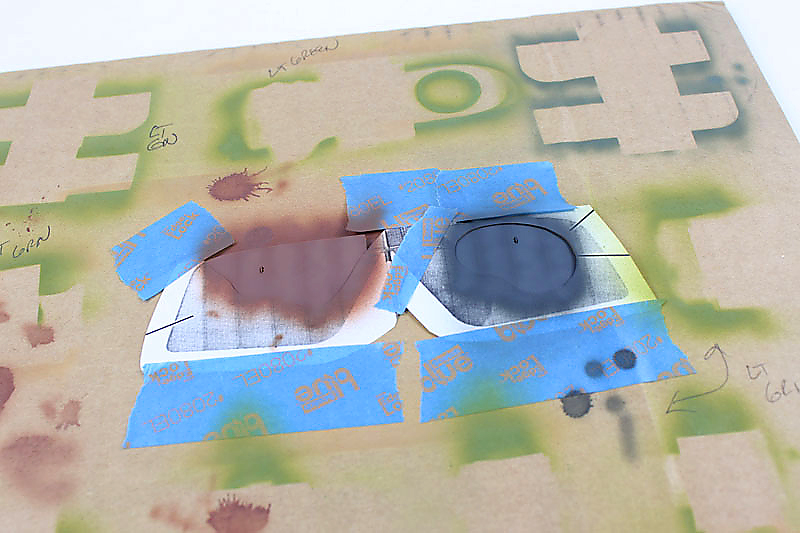

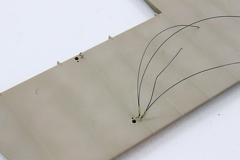

After finishing assembly, I spent many hours wearing powerful visual aids to install tiny turnbuckles from Bob’s Buckles. I then went to the paint shop for several sessions of putting on the complicated paint scheme, using paper masks sized from the instructions. All paint is Tamiya, mixed per the ratios in the instructions.

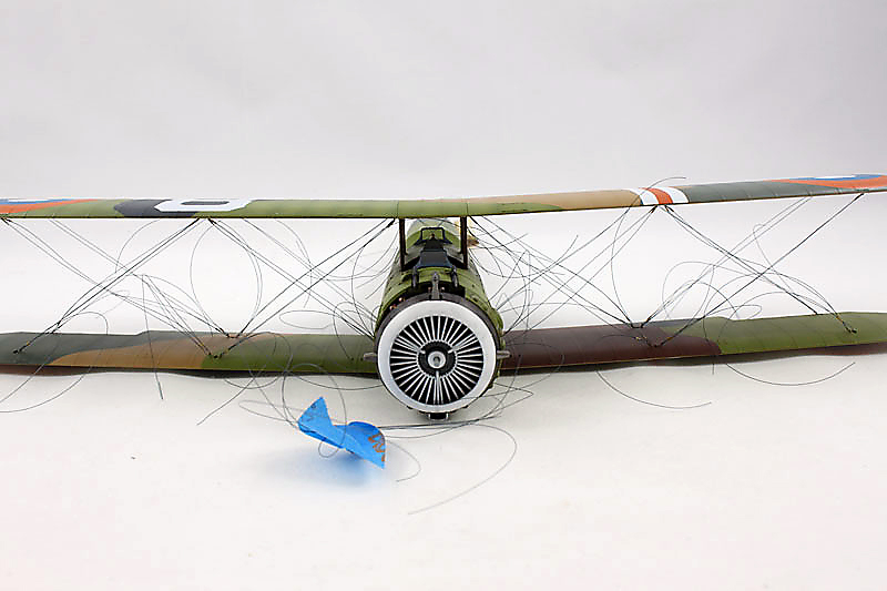

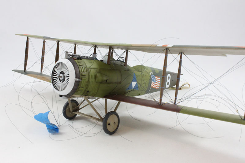

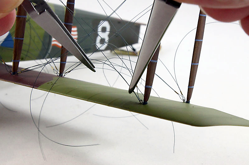

After clearing away all the tape and other masking, I added the decals. They bedded down well. Test-fitting the upper wing, I found the center section was so sturdy and aligned so well that I could install it without attaching the rest of the upper wing, allowing easy access to run wires. I then test-fit the rest of the upper wing, again finding that strength and alignment allowed leaving the interplane struts out of the way until I had loosely strung the wires.
After all the wires were loosely installed, I went back and added the struts. Again, test-fitting convinced me that the inner struts needed no glue. This is one strong bird!

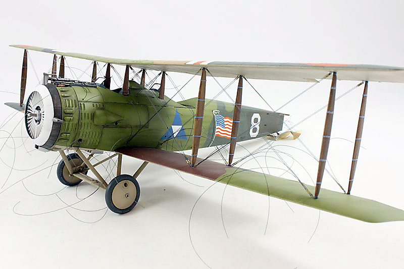

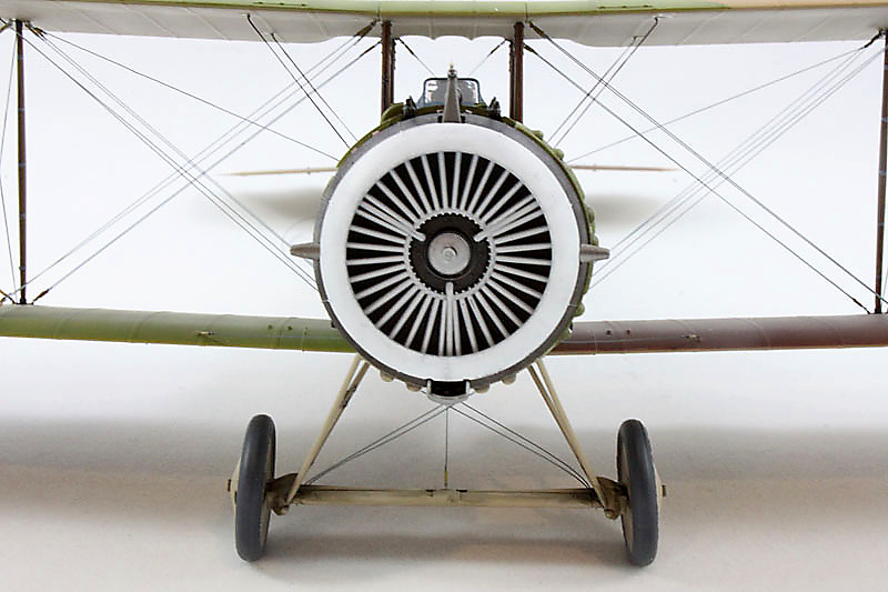

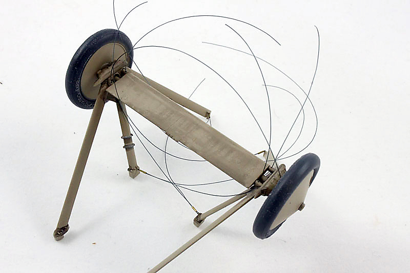

Prior to tightening the wires, I added the landing gear I had previously wired up. I then worked wire to wire and side to side, fixing wires in place. I used EZ Line, a stretchable fabric, for the interstrut bracing and aileron control runs.
After the wing was complete, I added the fragile tail components. Here I used EZ Line for the rudder control cables, and suture for the elevator. The elevator is so in-scale that it actually droops — I fixed this by tightening the suture to add strength.
A few fine details later, the Salmson was finished. The kit’s engineering and molding make it a surprisingly straightforward build given its size and complexity. Anyone who has built a biplane or two should have no problems with this one. I spent a little more than 64 hours — longer than usual because of the multicolored camo — and was very pleased with how it turned out. OK, Wingnut: Bring on the big biplanes!
