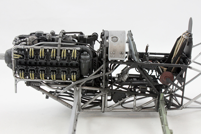

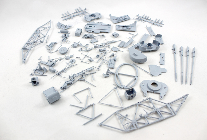

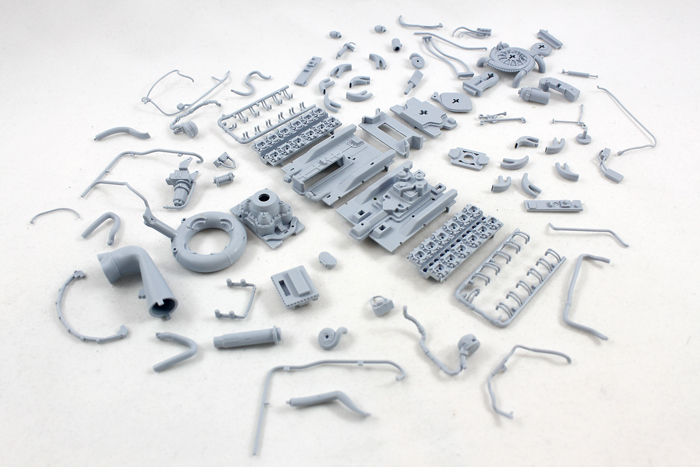

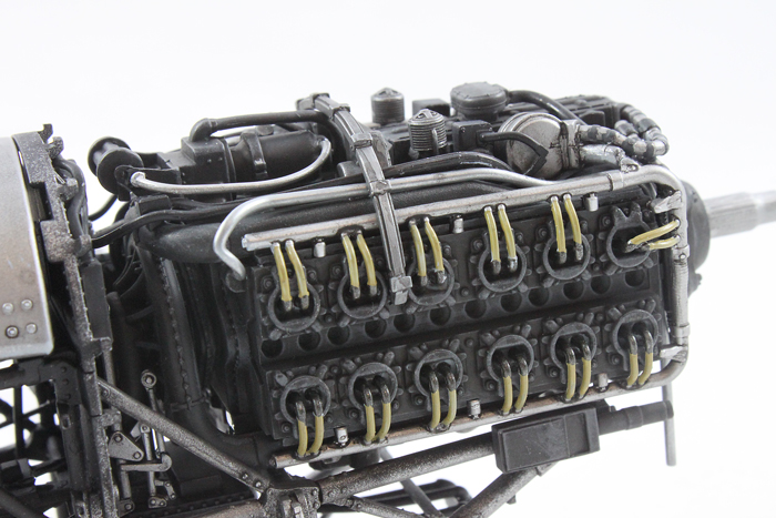

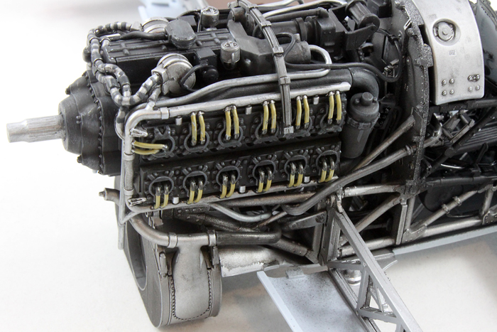

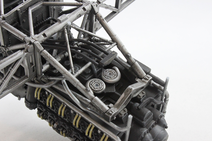

The kit is a study in contrasts. The box is packed with more than 500 parts, but many of them will head straight to the spare-parts bin, depending on the numerous options, such as the 54 unused weapons parts left over after loading my Typhoon with eight rockets. The kit exhibits loads of detail in every visible area — and some not so visible. The Napier Sabre engine truly deserves the “kit in its own right” phrase, with 83 parts. Surface details are nothing short of astounding, with rippled skin texture molded effectively.

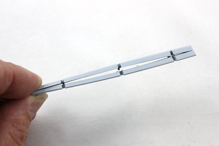

That’s a bunch of good news, but with it comes some not-so-good news: Airfix apparently had great difficulty molding the bubble portion of the canopy. Reported defects range from a small stress crack at the center of the front bubble frame to larger cracks and deformation in the teardrop portion of the canopy. Airfix has been working to fix this, but I used the canopy as-is. The distorted bubble is easy to miss, and the stress crack is not obvious, either, so check your kit.

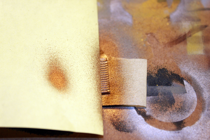

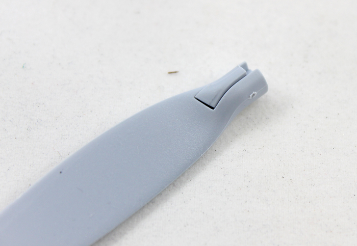

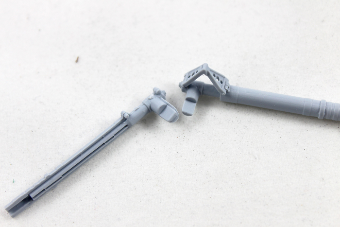

Additionally, every part had molding flaws that needed some form of cleanup, ranging from ejector-pin marks to parting-line flash and joint edges that were not square and true. The cleanup is easy: It just takes time — 10 hours in my case. I suppose that’s not bad for a kit this complex.

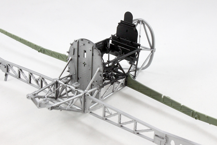

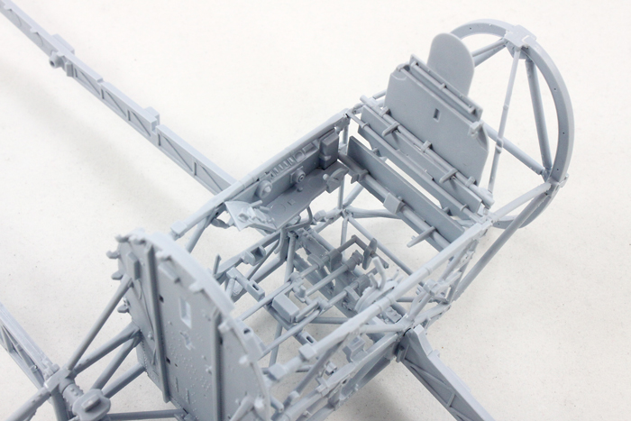

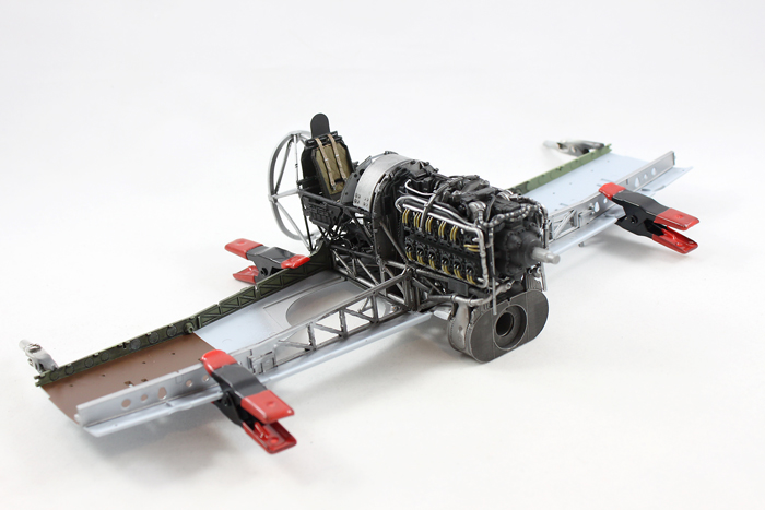

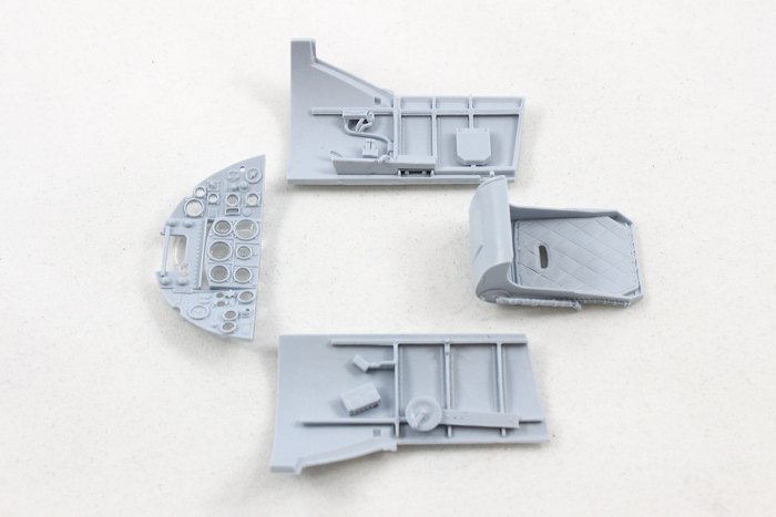

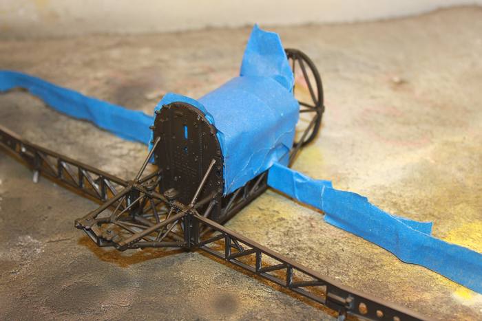

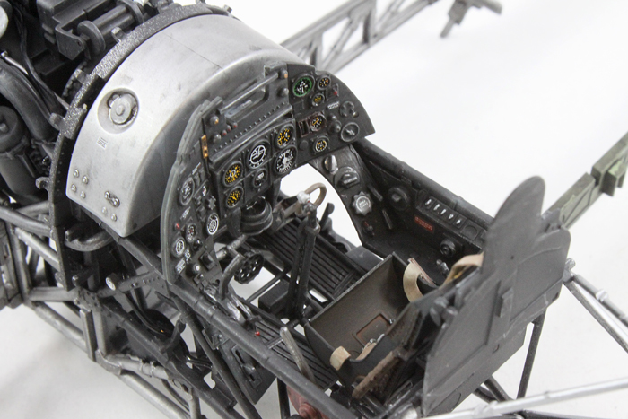

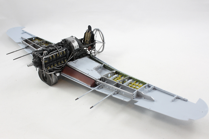

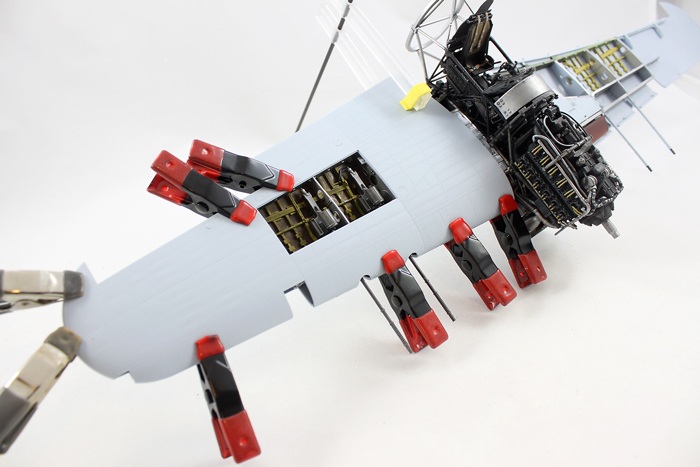

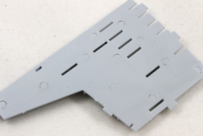

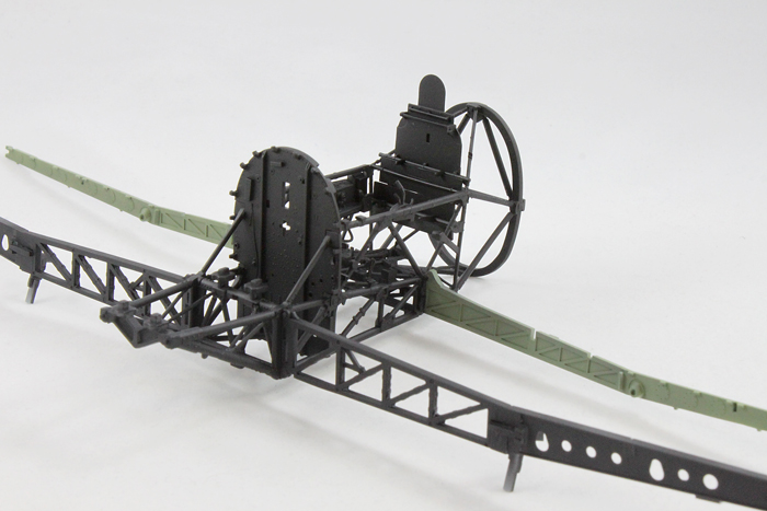

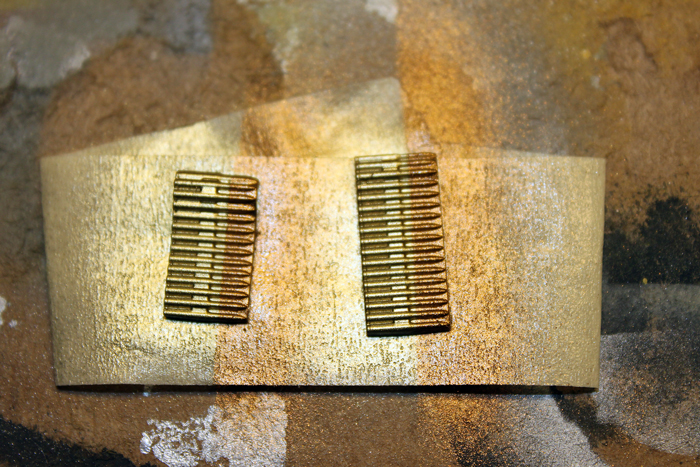

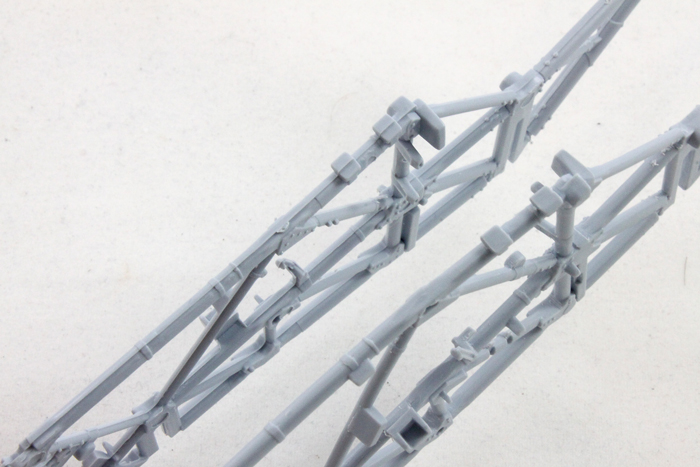

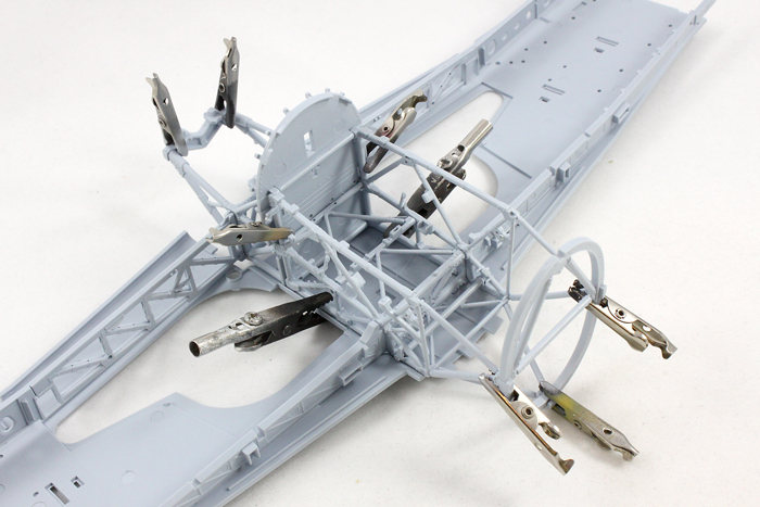

After my marathon cleanup session, I assembled the entire interior structure using the lower wing as a jig. Airfix provides wing spars, and alignment is critical for good fit between the wing and fuselage. I painted the interior a combination of various Testors Metalizer shades and Tamiya blacks and dark grays, masking in between. Some optional steps in the instructions are presented left to right, some top to bottom — after study, I found it helpful to circle the path I chose. Go slowly and follow the directions carefully — they typically show placing only a handful of parts in each step, and they helpfully show them installed (shaded in red in the following step). Airfix missed placing a hose (Part C14) between the starter cartridge holder and starter assembly (parts C41 and C54/C55) — you can see Airfix’s page for details. Beware of the seat cushion (Part B08) — it’s only for installation when using a pilot; otherwise the injection-molded lap belts won’t fit. You’ll want to study the instructions carefully when installing the plumbing and various engine fittings to see what passes over or under what — reviewing the red-shaded portions in the following steps helps there.

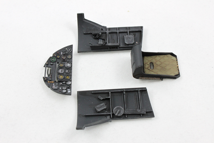

I don’t get the idea of including a rear-mounted clear instrument panel part, as the decals go over the “glass” anyway. I just painted mine black and put acrylic gloss over the dials as usual. The individual instrument decals fit well. I had to trim a large portion of the tab mounting the engine to the firewall to allow clearance to fit the engine, but it didn’t matter for fit or alignment.
There is another instruction error to watch out for: The main picture for Step 61 shows part C24 mounted to the large pipe on the engine, but the close-up detail view in the same step shows the correct position. There were a couple of hoses mounted at the end of the construction (parts D03 and D04) that I could not get to twist through the frame, pause, flip in midair, and land on the supercharger — but you can’t tell I cut them short, can you?

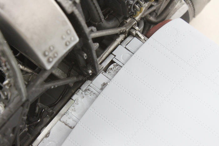

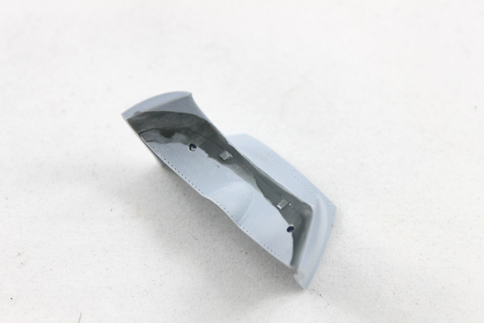

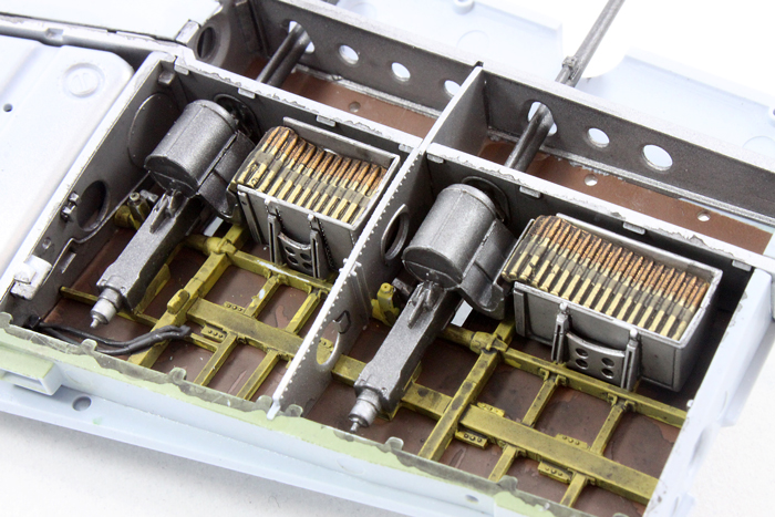

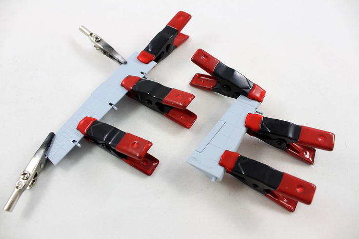

All the internal-wing structure and detail parts fit tightly after clamping firmly. I found out too late that my kit had a short shot on the top of the gear bay that shows up at the wing root.

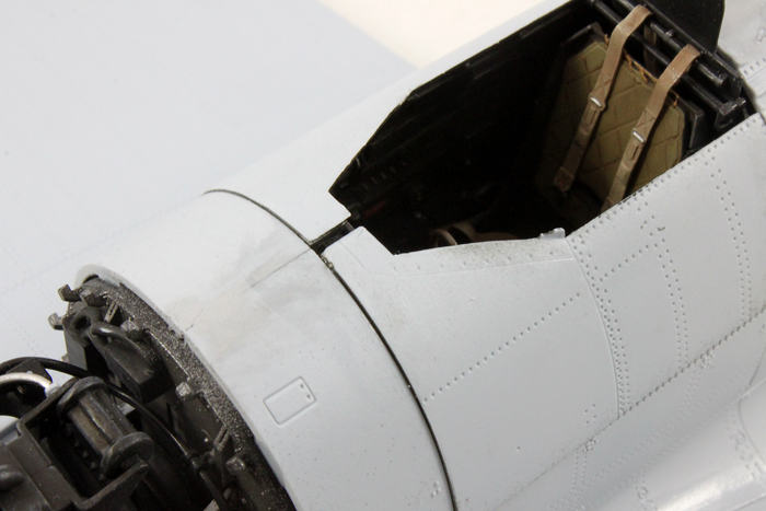

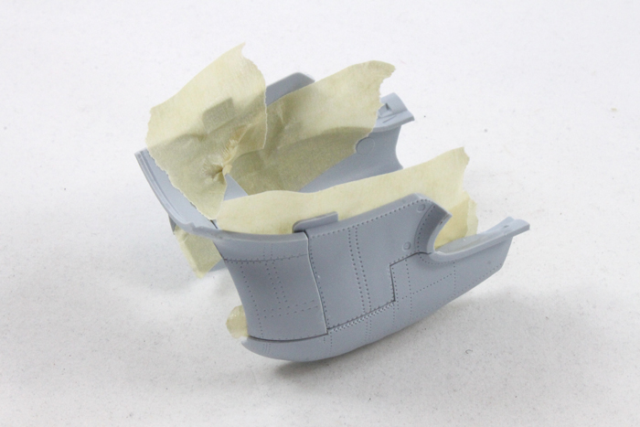

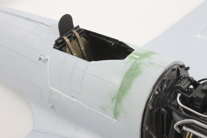

My decision to leave the entire engine bay uncovered was influenced by the wonderful job Airfix did on the engine, and the fact that the cowl panels are each a scale 2″ thick and devoid of internal detail.

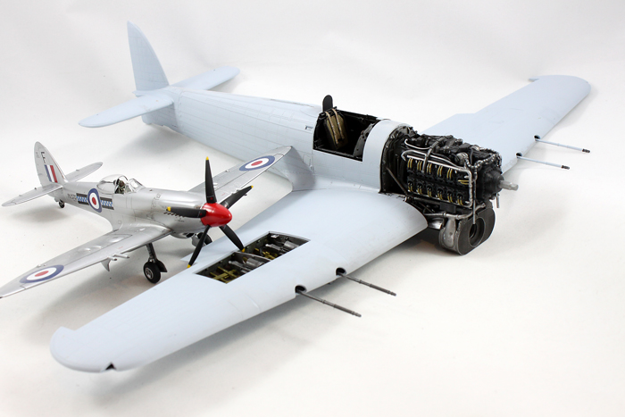

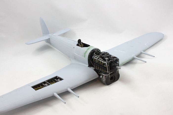

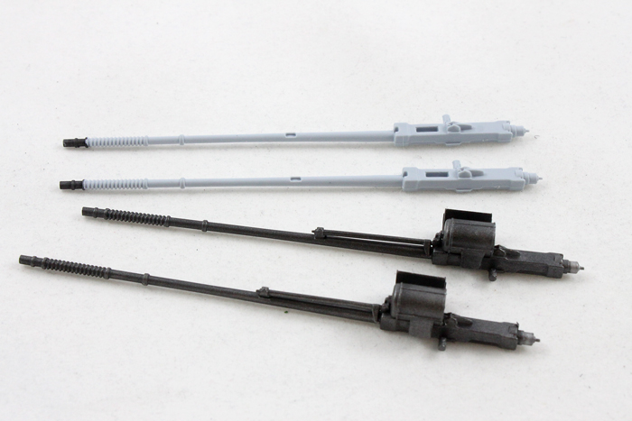

Assembly of the main components went well, with a little filler required at the lower wing junction. A choice of tail surfaces is included, and the fit was commendable. Test fits during cleanup had revealed an ugly “toenail” segment of flash nearly encompassing the main wheel mount; much carving and shaping was required to get the wheels to fit on the gear legs. In contrast, the 20mm gun shrouds fit nearly well enough to leave off until after painting.
