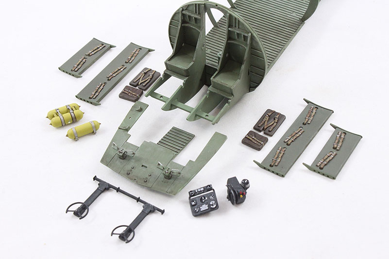

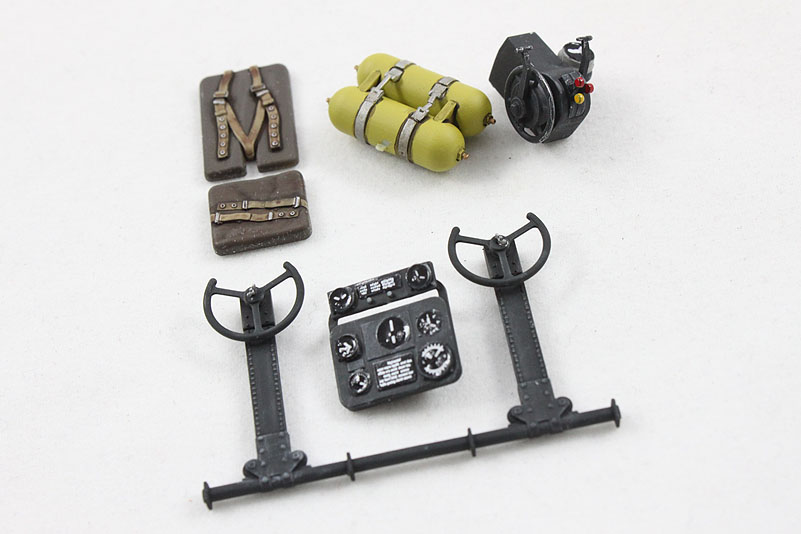

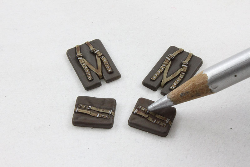

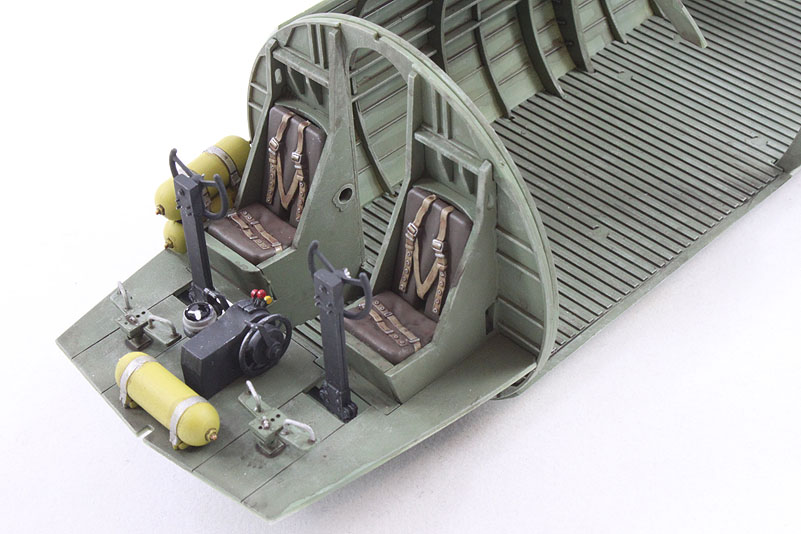

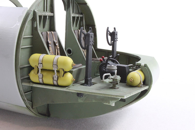

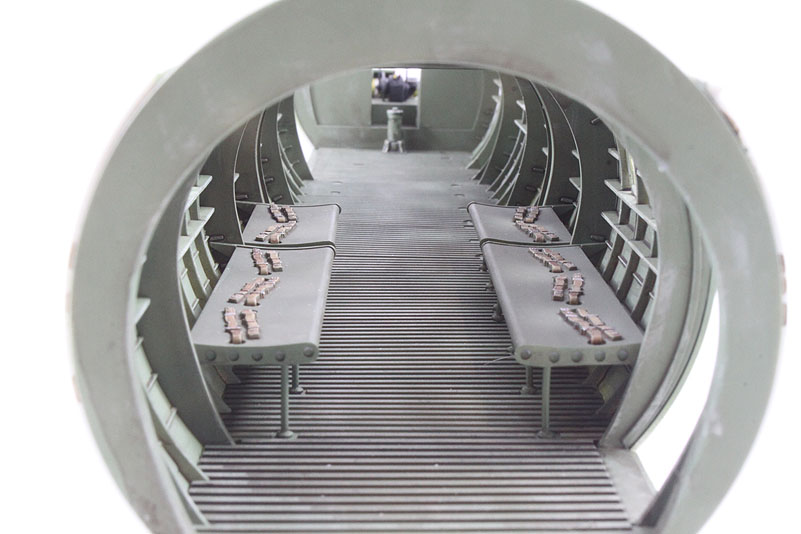

Bronco’s kit opens up numerous diorama possibilities, given how many kits of vehicles and figures are available in the same scale. Despite the Horsa’s relative simplicity, Bronco included plenty of detail. The cockpit is missing only wiring and plumbing. The cavernous troop cabin includes optional seats to fit along the sides, stepladders, and hanging straps.

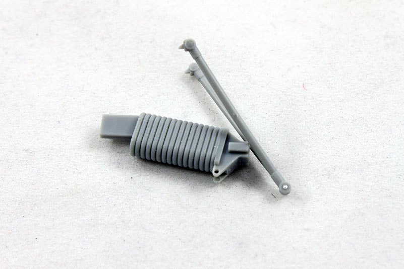

A small photo-etched fret provides straps to stow the ladder, details for the cargo door, and optional shelves to replace the plastic version on the rear bulkhead. There’s even a metal counterweight to keep the glider on its toes.

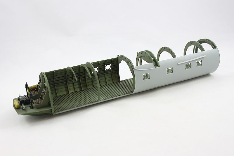

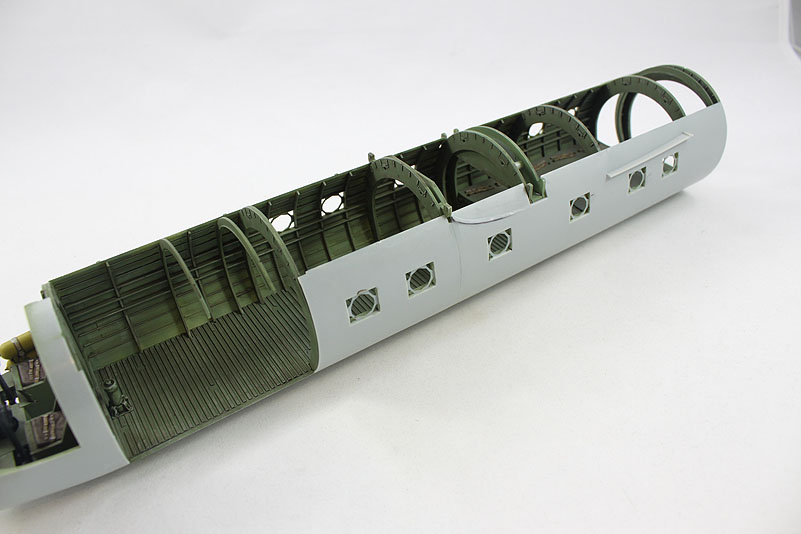

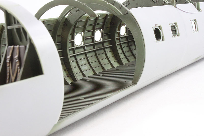

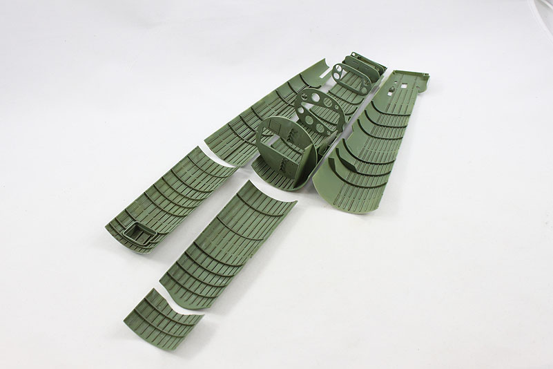

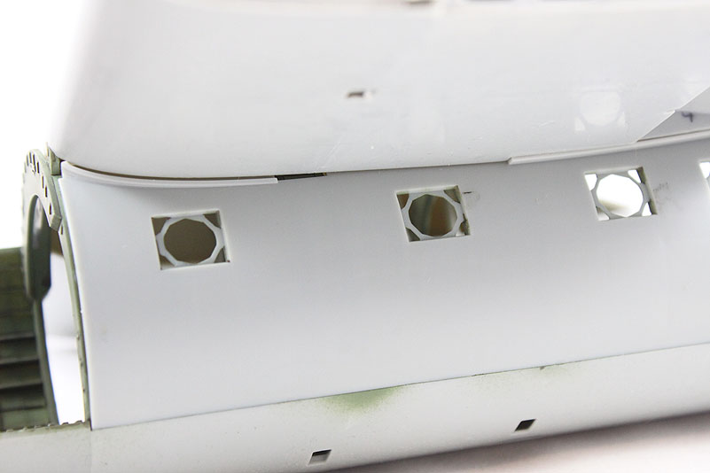

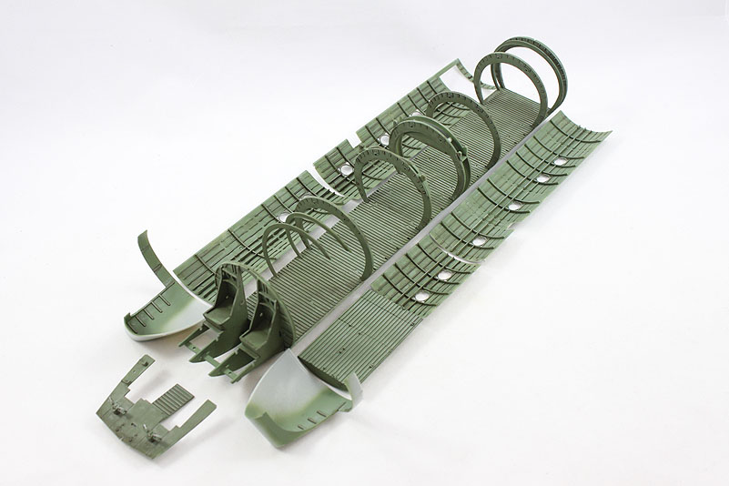

The large fuselage comprises multiple sections. Decent fits aid assembly of the large plane, but care and clamps are needed to prevent gaps.

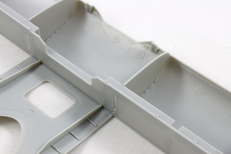

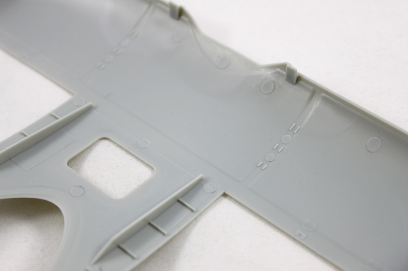

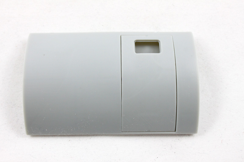

Numerous large ejector-pin marks complicate construction. They are easy to remove if you find them before applying glue; test fit, trim, and test fit again.

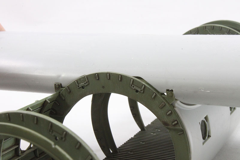

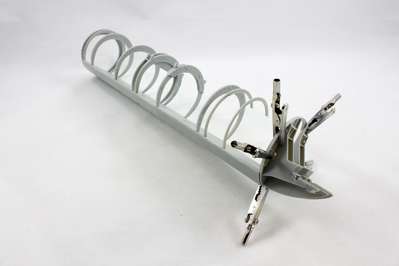

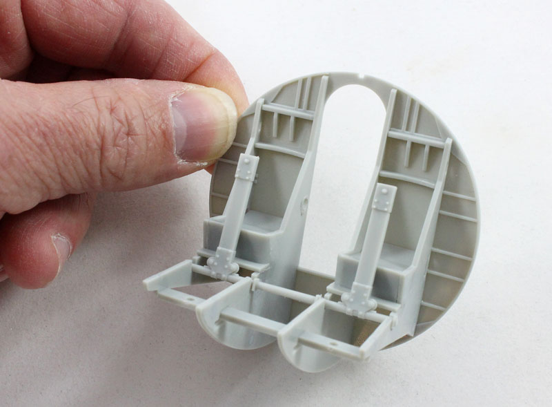

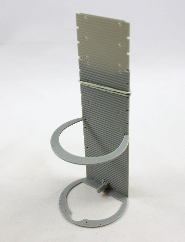

I didn’t join the fuselage frames to the floor as suggested in Step 5. Instead, I combined steps 5 and 6, trapping the frames between the floor and the lower fuselage, which includes alignment slots.
Don’t forget to install the nose weight. It’s just barely sufficient to keep the tail up.
You’ll need to open holes in the floor for seating in the forward half of the fuselage; they’re present in the aft section.

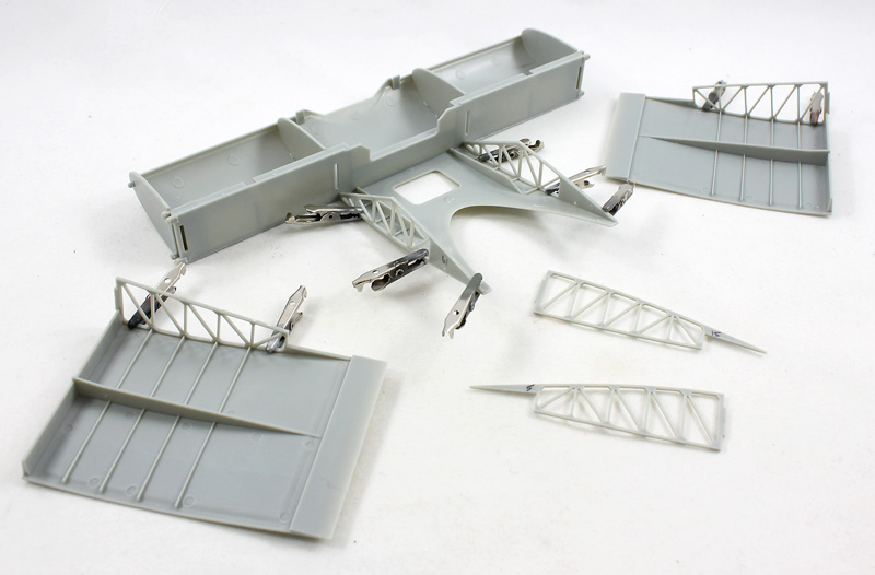

Step 17 shows the struts for the stabilizers fitting an incorrect hole in the fuselage, but the next drawing shows the right spot.

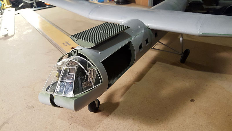

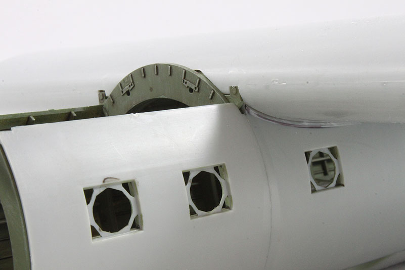

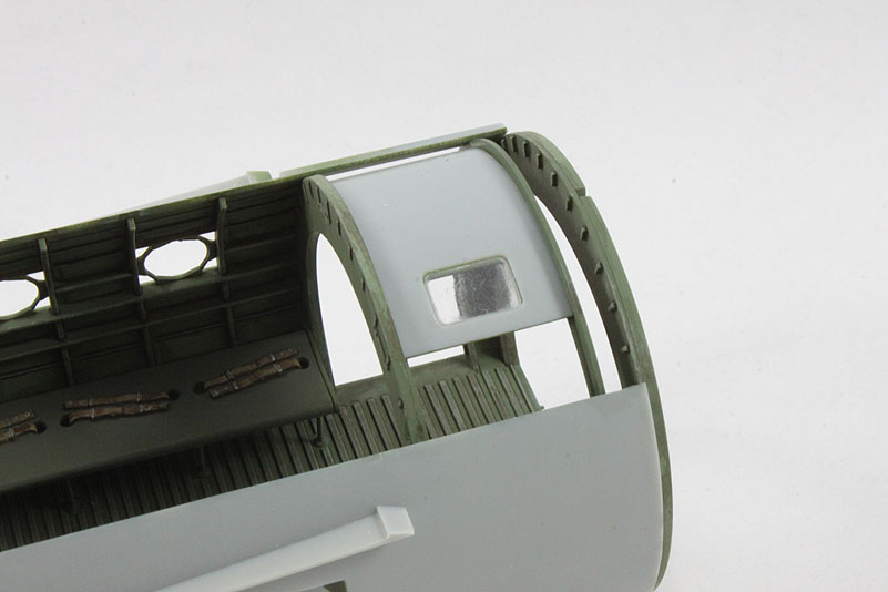

Before painting, decide which cargo door option to use. And don’t forget to install the overhead frame supports before attaching the roof. Ask me how I know!

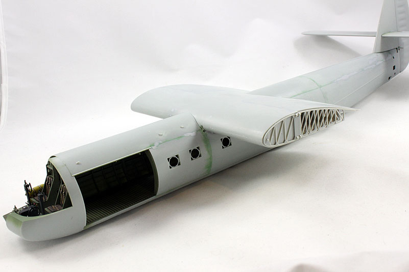

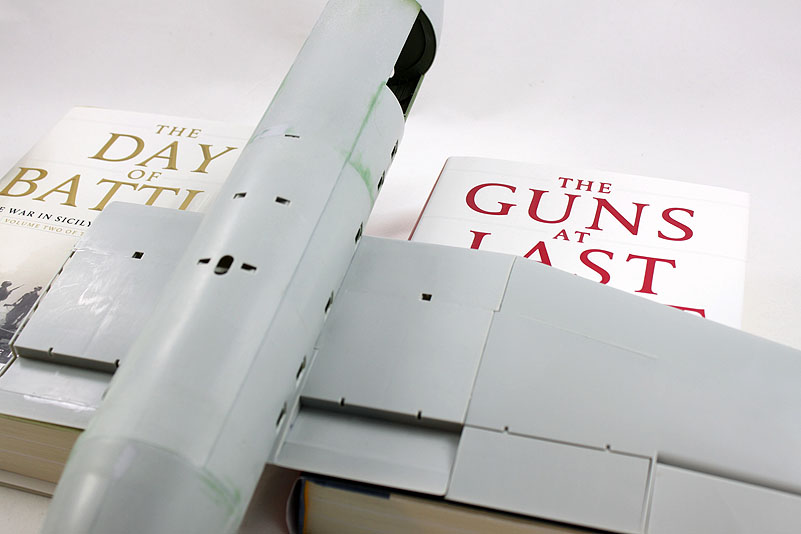

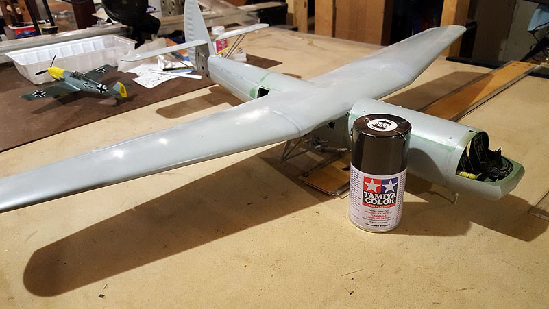

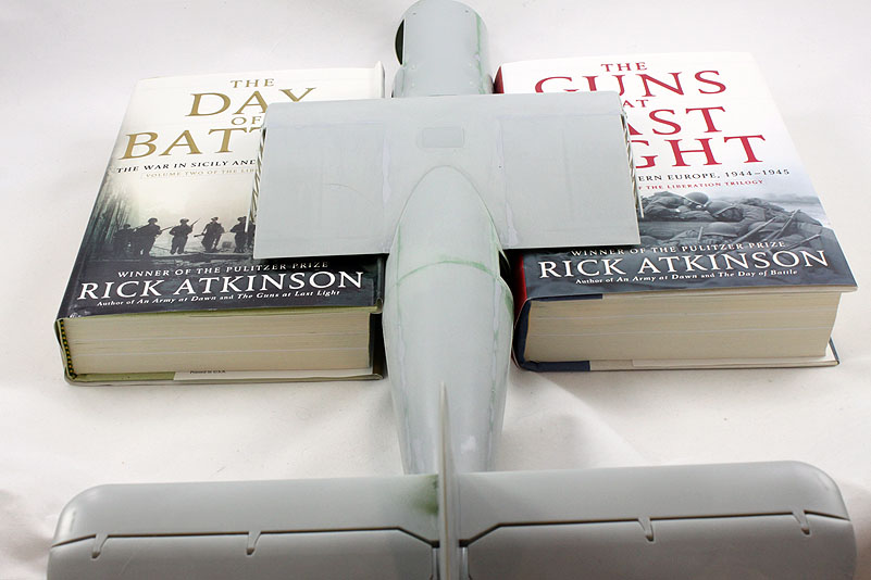

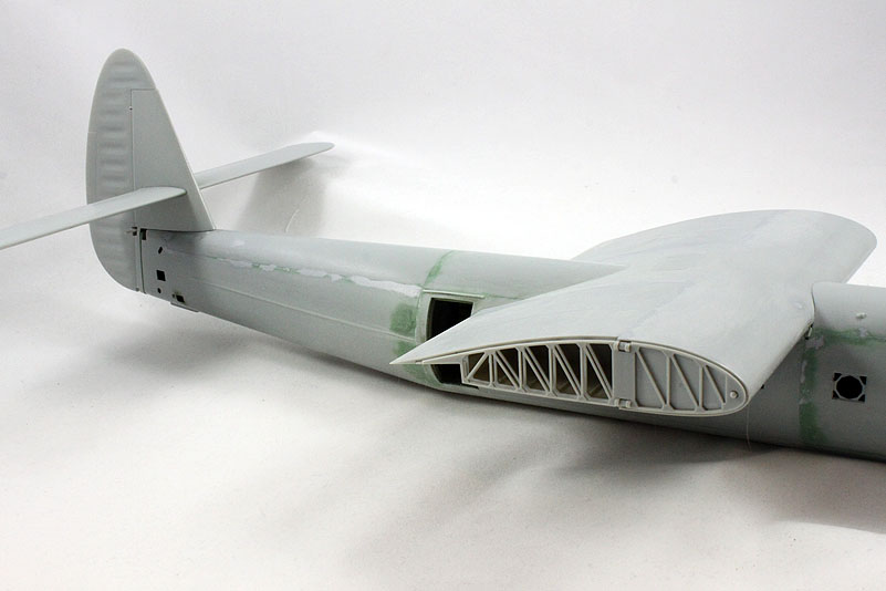

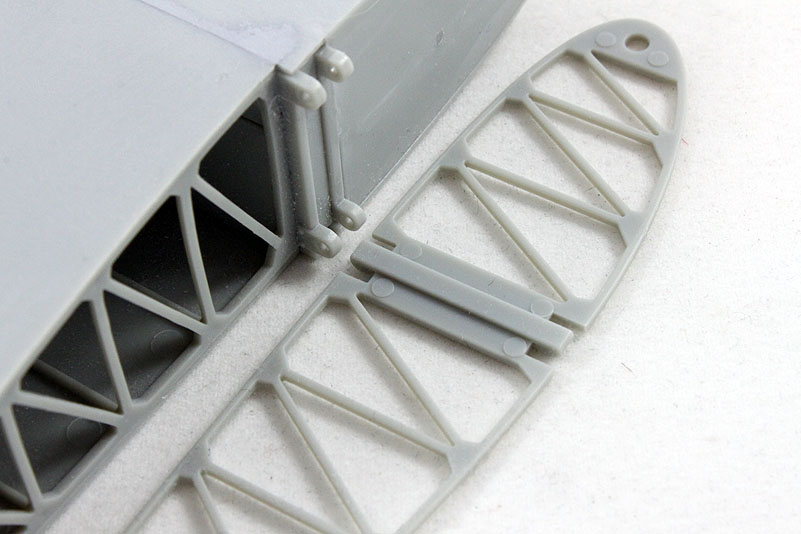

Because of the model’s size, I left off the outer wing panels until after the center section was mounted on the fuselage. That allowed for easier handling while cleaning up this critical connection. Once the roots were secure, it was a snap to level the wings.

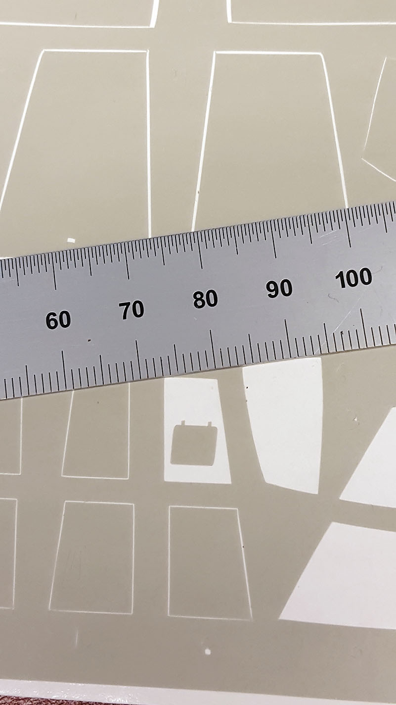

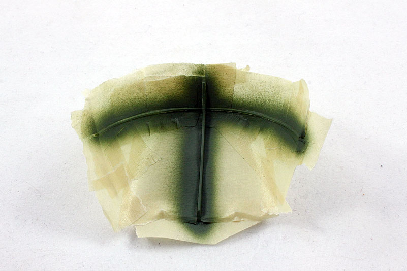

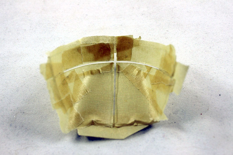

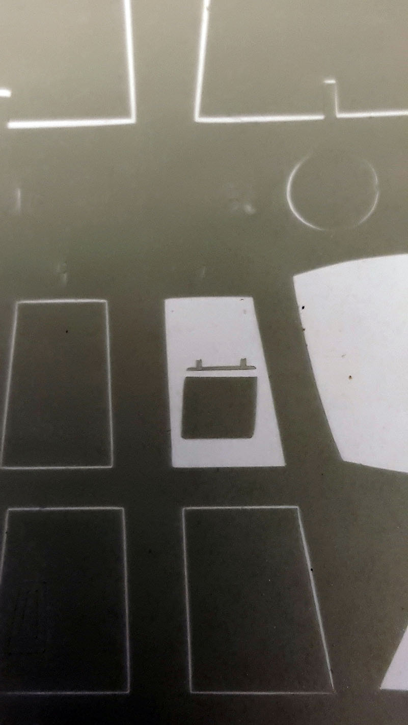

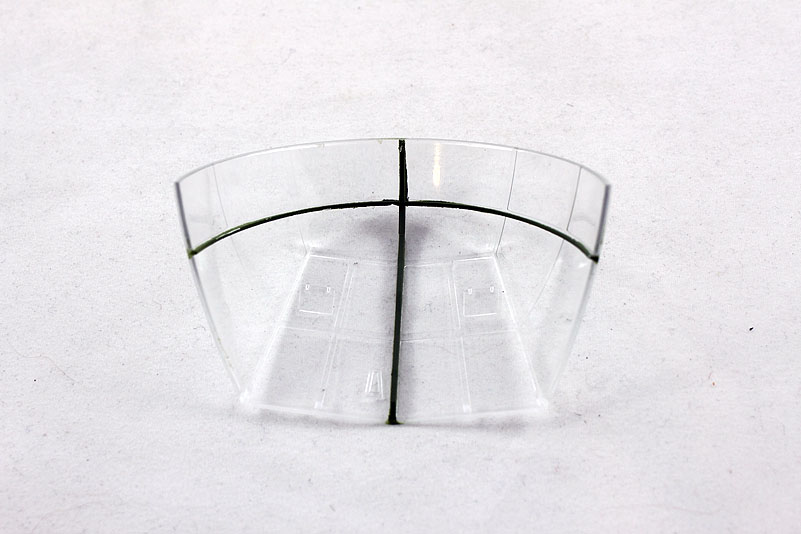

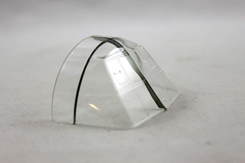

Bronco includes masks for both the inside and outside of the windscreen and cabin windows, but many of them are slightly undersized.

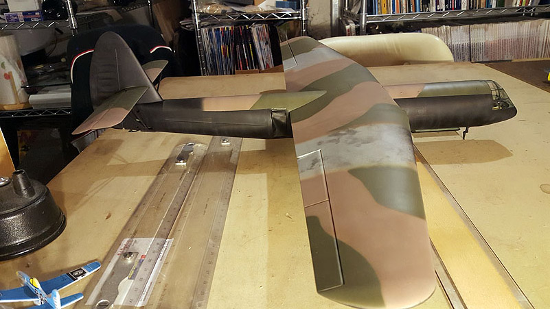

I painted the underside of the extensive airframe with Tamiya spray-can semigloss black, then airbrushed highlights with Tamiya dark gray. To paint the upper camo, I made paper masks by enlarging the  instructions on a copier.
