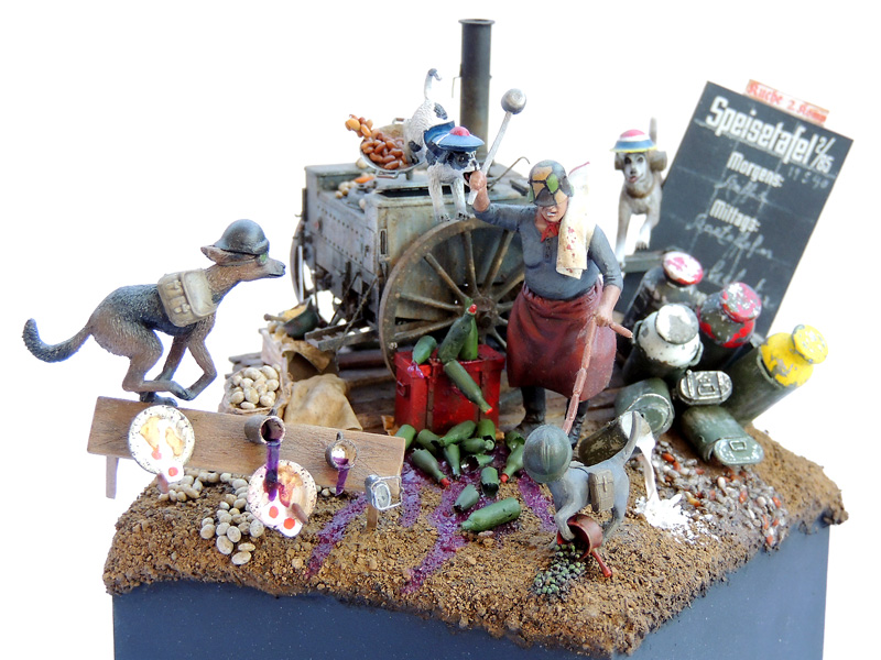

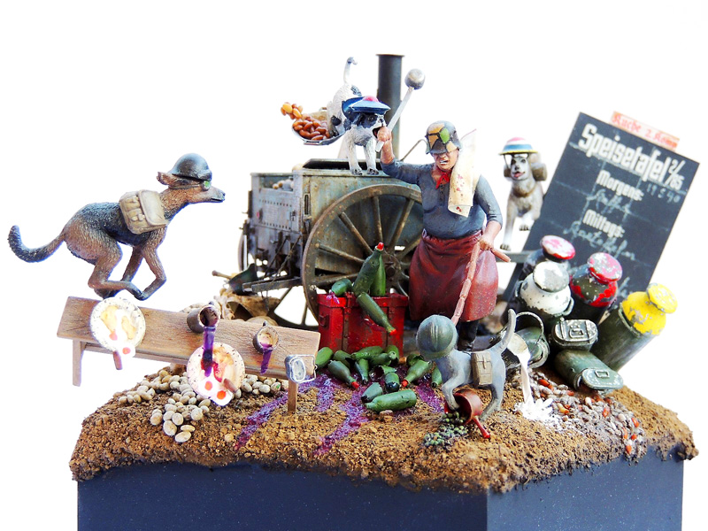

Tamiya’s Feldküche: German Field Kitchen Scenery (kit No. 35247) is the diorama’s centerpiece. When I started the project, this kit (and the older Tamiya 35103) were the only available to reproduce a Große Feldküche Hf.13. I needed tons of styrene stock, lots of pieces from my spares box, and some photo-etched (PE) parts to improve it. Now you can buy the new Riich.Models kit (35013) that is a more faithful (unfortunately more expensive, too) reproduction of the Gulashkanone, saving you a lot of time.

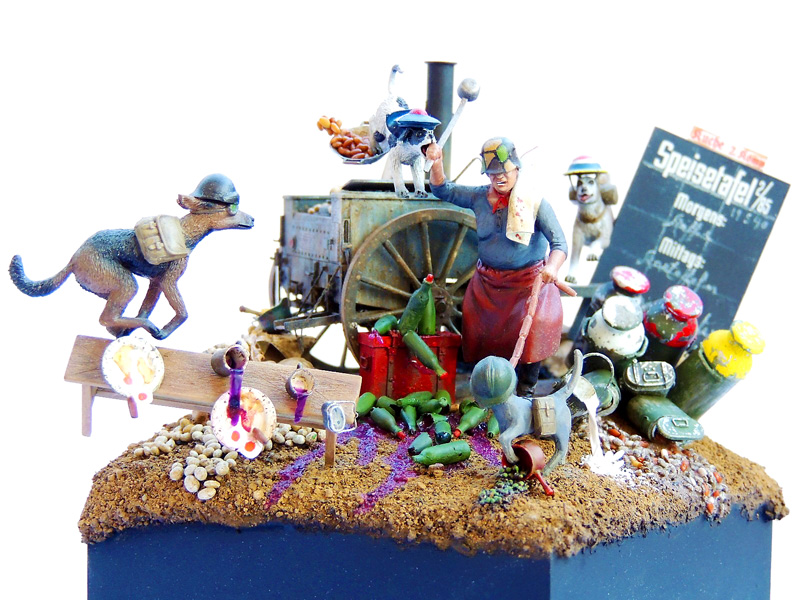

I “cooked” my stew using a mix of Vallejo Still Water (26.230, a very versatile product), some brown acrylic colors, and chia seeds strewn all over the scene.

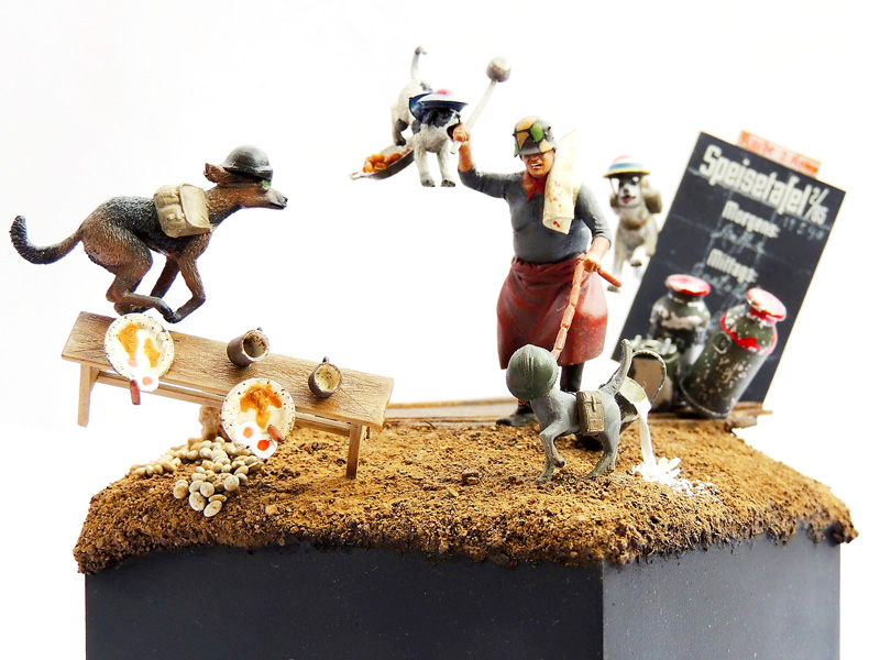

In some pictures you can see next to the Feldküche a Speisetafel, a chalkboard reporting the day’s menu. I made a Speisetafel decal and placed it on a blackboard painted styrene sheet adding writings with a white crayon. The decal is available on my blog, cecetotoy.blogspot.it

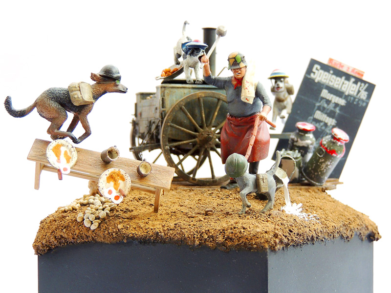

Once the model was built, I started to paint it using Adam Wilder’s color modulation style (a gradation of colors and shades that mimics the play of light and brings out individual features).
Despite being small, the kit has a lot of details, such as the pot cover, many compartments and vents, and the stovepipe that can be highlighted using this technique.

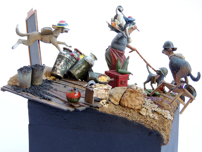

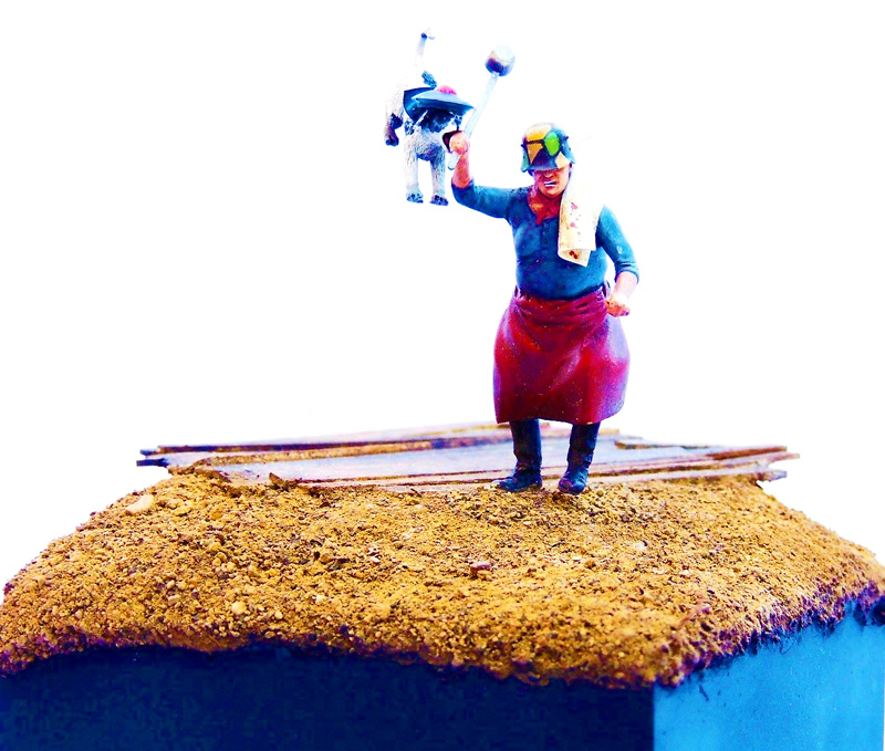

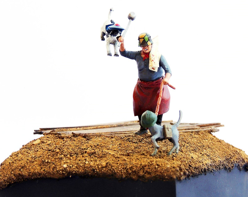

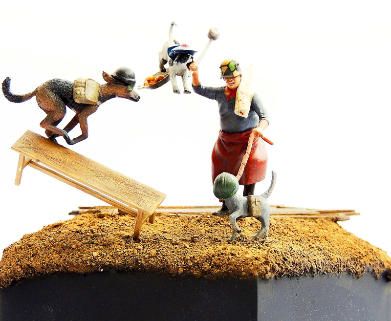

Turning to the figures, the küchenchef and the dog struggling with him come from Scale Model Accessories Ltd., a British company now out of business. I changed the cook a little. The figure was wearing a soft Feldmütze cap and brandishing a cleaver. The ladle is better for humor’s sake, and the World War I Stahlhelm (steel helmet) gives character to the cook. The remaining “war dogs” are Doug’s Original figures (DO35A05 and DO35A03), now wearing some military stuff.
I painted all the figures using an airbrush: this tool can give astonishing results in a surprisingly short time.

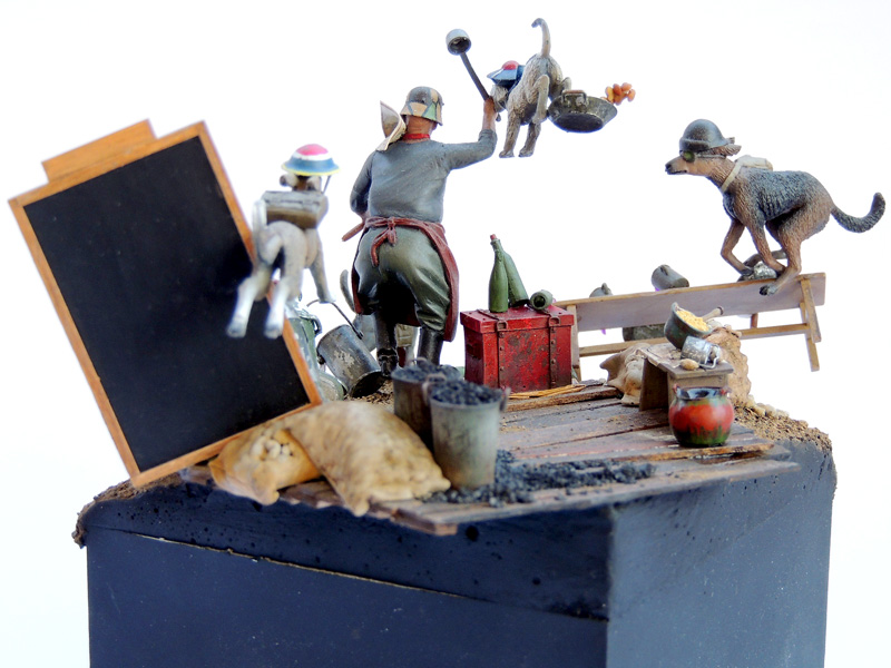

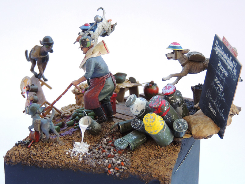

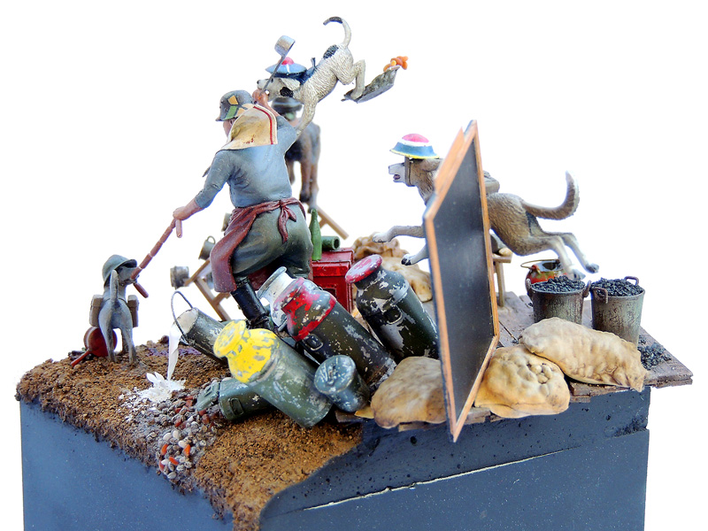

After painting, I put the field kitchen, the figures, and all the stuff on a small 3.5″-square base made from styrene sheets. In this crowded little space all elements are close enough to relate to each other, creating a harmonious unity. The dogs, all pointing to the küchenchef, work together to tell a single story; nothing distracts the viewer’s attention from the focal point of the vignette. This is one important principle to bear in mind for an effective and narrative diorama.
“Allied raid!” is my first attempt, and probably the last, to make a humorous diorama. Borrowing the mechanical-gag techniques of silent movies, I have staged a surrealistic disaster performed by four funny pets and an overweight küchenchef. Attacked from every side by Allied forces, he tenaciously defends his Gulashkanone, trying to recover a string of sausages from the enemy’s jaws while everything around him is messing up! Every object in the scene is overturned, and every single piece is falling down or rolling toward the edges of the composition, giving it considerable dynamism.
