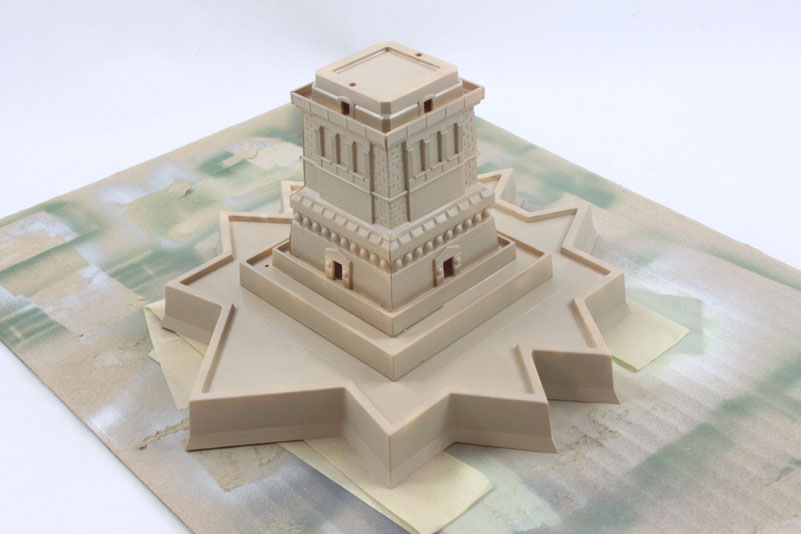

Nathaniel started with the star-shaped platform; it took a fair amount of cleanup under Dad’s watchful eye to smooth the four sprue attachment points.

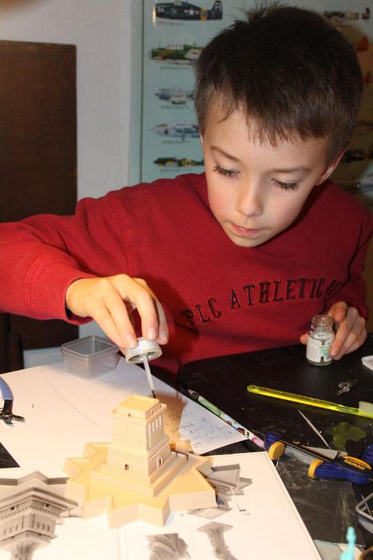

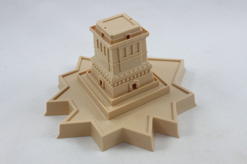

After cleaning up the parts for the pedestal, he placed the first wall section with a bit of effort. The kit is not designed to snap together, but the fit was tight. It was hard for him to keep all four sides in place at one time to get them glued, so I showed him how to use a clamp to keep them together long enough for him to apply glue. We used Testors Liquid Cement throughout.
After the base was dry, Nathaniel test-fitted the riser — and it stuck halfway! A bit of extra hand strength from Dad and a brush of glue from Nathaniel fixed it. It would have helped to open the holes slightly.

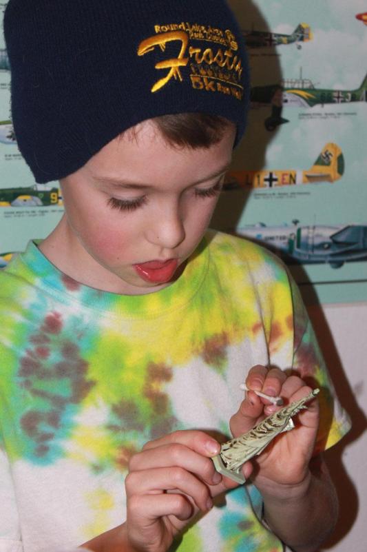

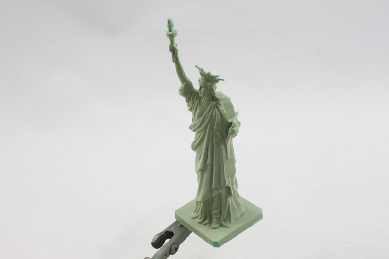

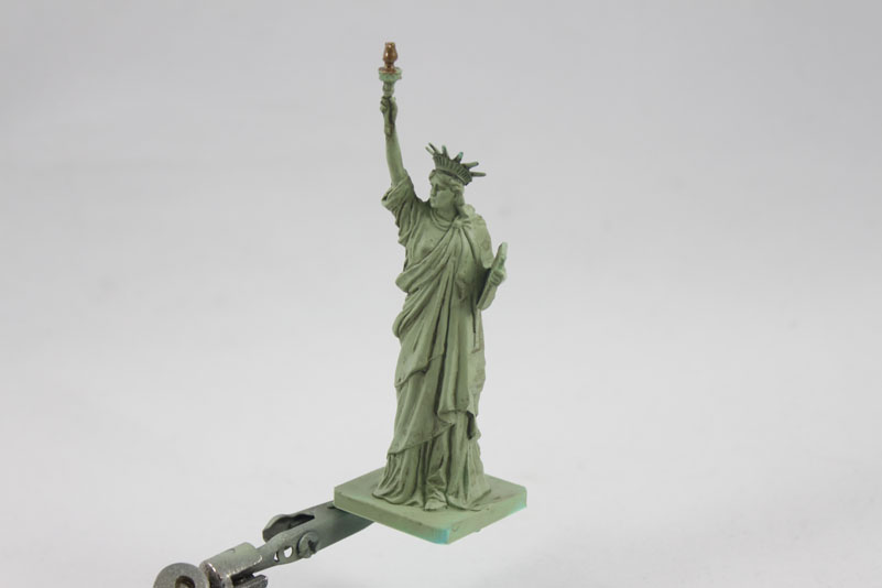

Next, Lady Liberty: The entire statue is molded in just two parts; only the crown is separate. Fit was excellent, and we left her off for painting.

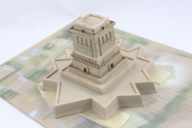

 “Would you like to hand-paint it or airbrush?” I asked. “Airbrush!” was the immediate reply. Selecting paint from Dad’s stash that looked close, Nathaniel chose Testors Model Master Acryl RAF sky for the statue and Tamiya buff (XF-57) for the base. I mixed the paints for him and he sprayed each color after practicing on some cardboard.
The folds of the statue’s robe were so nicely sculpted by Italeri, I encouraged Nathaniel to try his hand at a wash. We used Flory Models dark dirt wash, a suspension of fine clay in water. He brushed some on, let it dry just a bit, and then removed it with a cotton swab. He was pleased with how it made the statue look. “Just like the real one!” Another wash emphasized the sharply molded stonework and architectural features of the base.
