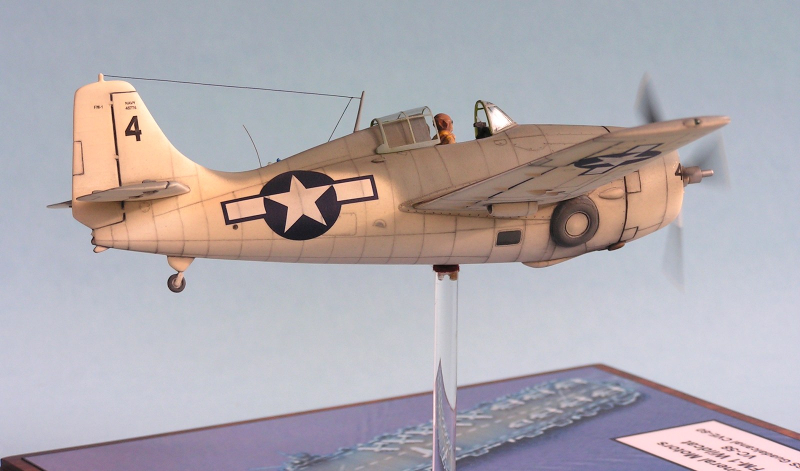

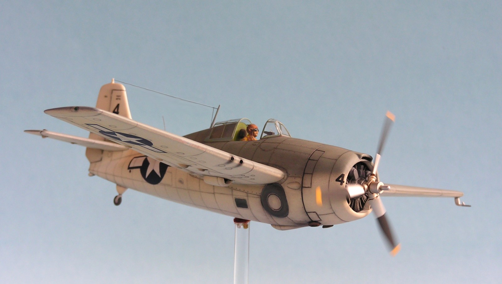

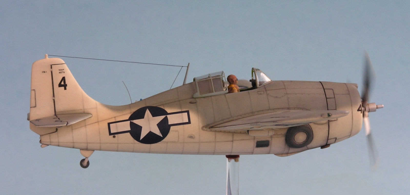

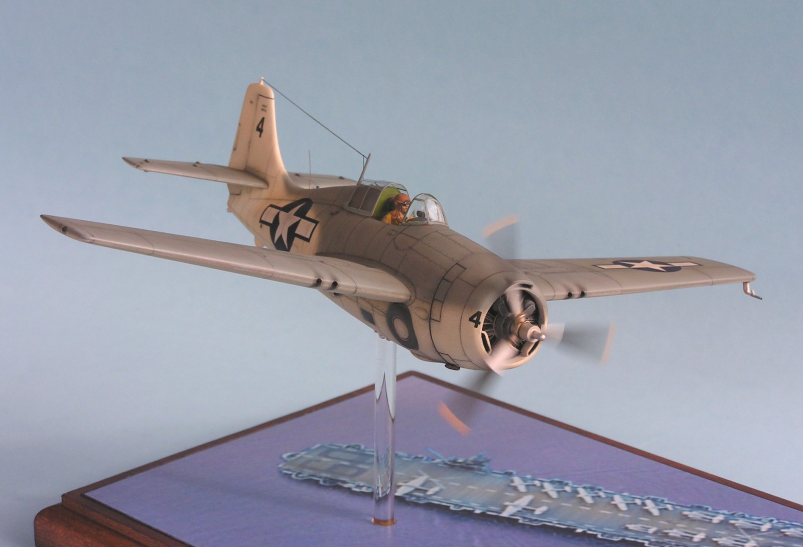

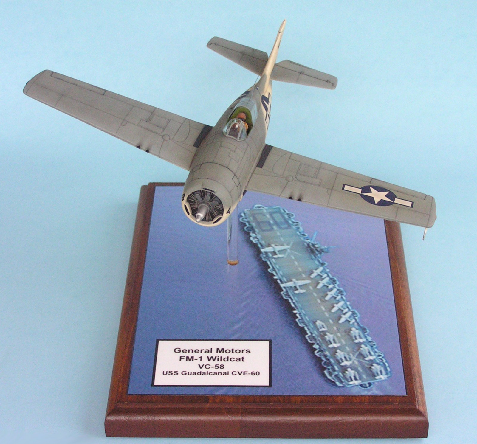

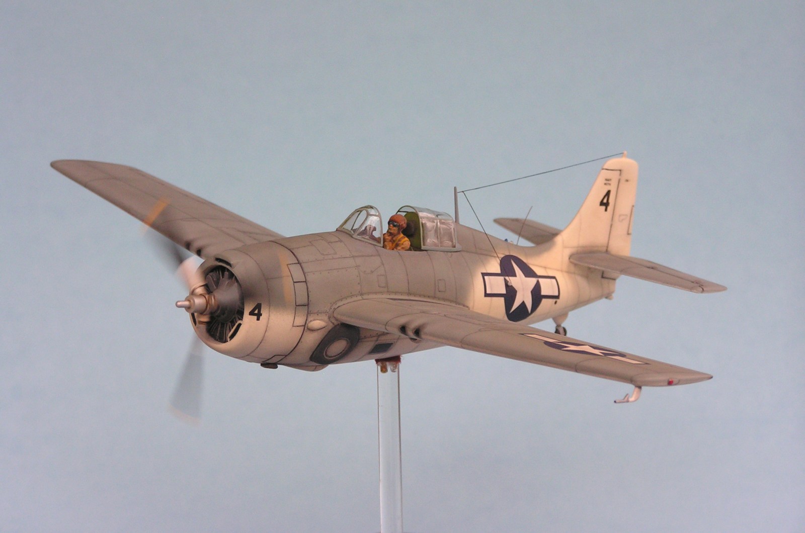

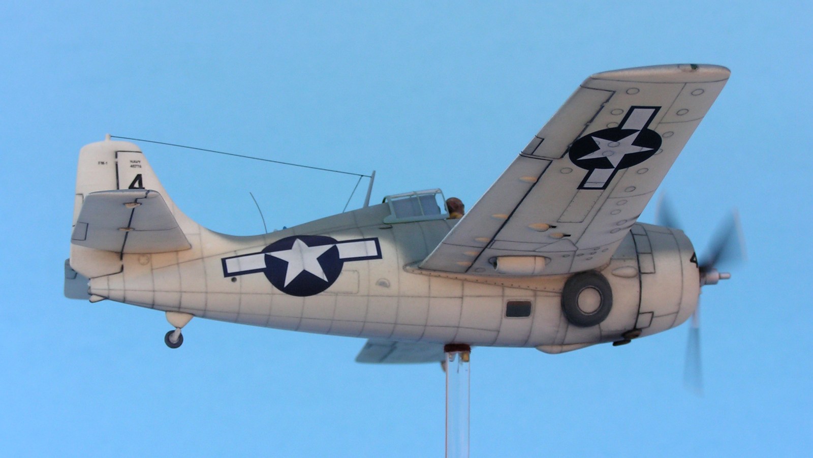

Here you can see a few shots of the finished Wildcat and its base.
