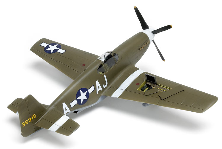

Gun detail is provided in both wings, which feature separate access panels. Installing the .50-calibers, I noticed they were spaced farther apart than they should be - a serious accuracy problem.

The undersurface of the wings had two anomalies: There were two slightly raised pads for the bazooka-style rocket mountings. I filled the mounting holes and sanded the pads off. Also, there are no shell-ejector ports!

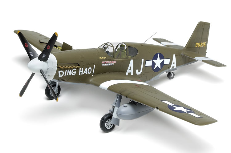

The kit includes a framed canopy and the frame-less Malcolm version. The framed canopy can be either open or closed.
The Malcolm canopy does not have the correct "blown profile" when seen from above; it should be more bulged. It also seems designed only for the closed position, lacking the width to slide backward.

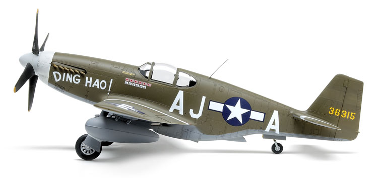

The aircraft Ding Hao used both the standard "birdcage" and Malcolm canopy. To use the Malcolm, I filled in the hole for the antenna mast and sanded off the light and aerial fixtures. I also added a whip antenna of stretched sprue. You may want to add canopy rails made from plastic strip.
I used the 75-gallon drop tanks from the selection of wing stores. The 108-gallon tank also is provided.
I painted my Mustang with Hobby Color acrylic paints. Decals are provided for two aircraft, but there are accuracy problems with both schemes. The yellow and black squares for the 325th Fighter Group are not in the correct pattern, and the name for the 325th aircraft does not match the documentation. The letters of Jim Howard's Ding Hao looked as if they had colored outlines, but not these decals. However, the decals are very well-behaved, settling very nicely with decal solution.
