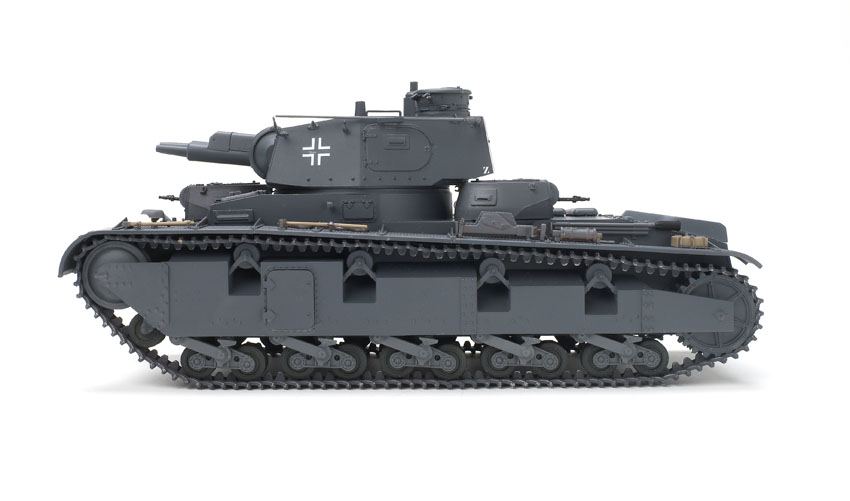

I painted my tank with a combination of gray Tamiya spray and acrylic paints.
Decals are given for four vehicles. Supplemental markings for variations are also given. These applied well with some decal solution.
My primary reference was the old standby: Encyclopedia of German Tanks of World War Two (by Chamberlain and Doyle; Jentz editor; Arco, ISBN 978-0-668-04565-0). There is a more recent book on this vehicle, Grosstraktor Neubaufahr-zeuge (Tank Power No. 361, by Janusz Ledwoch, Militaria Wydawnictwo, ISBN 978-83-7219-361-2).
I finished my kit in 37 hours, which was a bit longer than anticipated due to the track assembly. The completed model looks most convincing. With the separate tracks and other construction details, Amusing Hobby has aimed this kit at the advanced modeler. If you have the experience, I recommend the kit.
