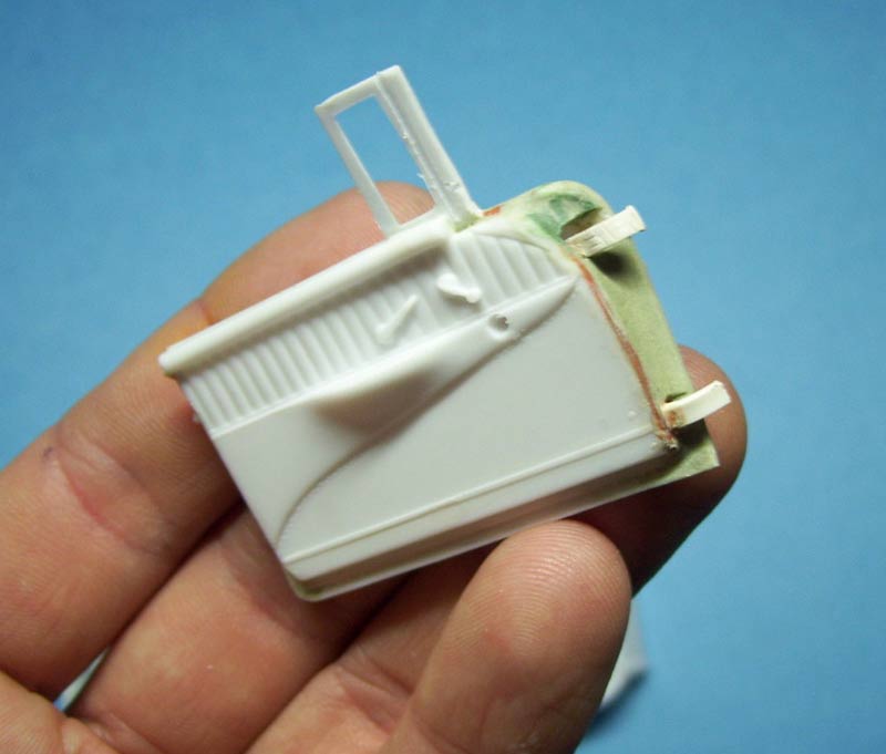

I wanted the doors open, so I used a scriber to deepen the engraved panel lines, 1.
Then, I carefully cut out the remaining plastic with a micro razor saw, 2.
To complete the surgery, I cut the corresponding door panels from the inner tub, then glued the door parts together, 3.
I filled the gaps with Squadron putty and .020″ styrene, 4, and added hinges from .030″ x .060″ strip styrene.

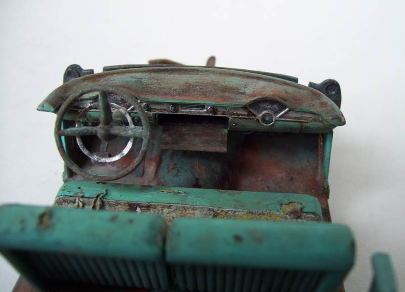

I cut open the glove compartment door and build a styrene box behind it. Using stretched sprue, added drooping wires under the dash. Pedals fashioned from styrene sheet and rod finished the details, 8.

I applied craft acrylics to the seats and interior tub using ivory white and turquoise for a typical two-tone décor. The seat stuffing was painted Tamiya dark yellow. After weathering the seats with selective light gray and burnt umber washes, I added rust-colored pastels on the floor and dash, 17, 18, 19, and 20.
