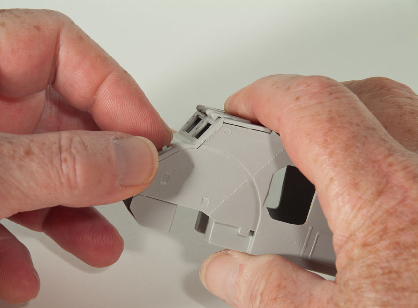

Also in the previous picture of the model, near the top and front of the hull on the starboard side is what looks like an ejector-pin mark. Or is it? Pictures of other variants showed an antenna attached at that spot — but the few pictures I could find of the Mk. III show no such feature. So, I sanded it off — but not before making sure I should.

Finally, a section of stretched sprue, softened with Testors liquid styrene cement and textured with the rough end of my trusty dental probe, replicates the rough weld bead in this spot. Additionally, it covers a slight gap.

Sometimes, a multipiece hull can be a little tricky to figure out. Test-fitting the front plates, I wanted to be sure they overlapped or butted correctly. How smooth (or not) was that join at the top front corner? Did the top plate overlap the hull, or did mine just have a bad fit?
OL01A
This photo shows a different Staghound variant, but it settled my hash. Taken at the Yad la-Shiyon Museum in Latrun, Israel (thanks, Bukvoed!), it clearly shows the Staghound’s rough-cut, slap-dab wartime body styling. So, don’t make that edge too pretty; it never was.
