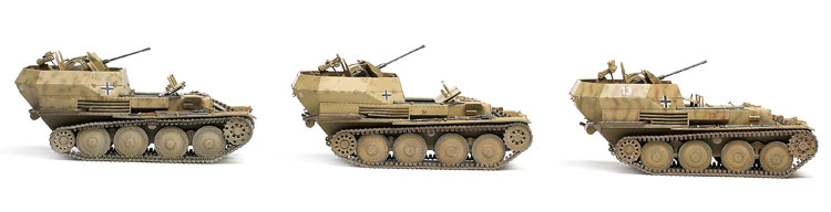

From left to right in group photos: Dragon, Tristar, and Italeri models.
It’s hard to believe three companies would kit the same vehicle within two months.
Tristar excels with superior interior detail, correct drive sprockets, and late-style FlaK 38 gun. However, it’s the most challenging of the three kits to build.
Italeri’s kit is the easiest; I was ready to paint in the same time I had spent on the Tristar interior. Surprisingly, the Italeri kit also is the most expensive.
Dragon’s kit seems the best value: well detailed, the least expensive, and a boon to your spares box, too. However, you’ll need experience with photoetched metal.

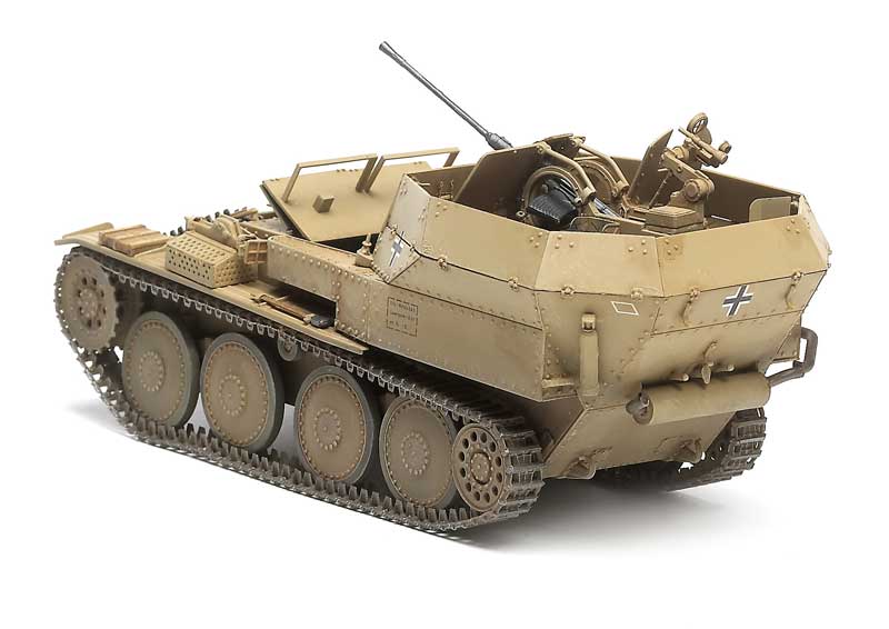

Slaying the Dragon
Dragon’s light-gray injection moldings show excellent detail. Don’t let the quantity of parts scare you: About a third of them will wind up as spares. Decals are provided for six different vehicles.
Dragon’s “Smart Kit” technology aims at simplicity, but this kit has 154 photoetched-metal parts; some come from Dragon’s earlier releases of the 38(t). The FlaK gun has been around for a while; it’s a good one, but this Flakpanzer used a later version. (The differences are small.)
The hull is an all-new mold and holds detailed driver and engine compartments. Dragon starts the complex hull with a nice one-piece tub, easing alignment later. I built the tracks and wheels as a single, removable unit. After installing the suspension, I mounted the wheels, drive sprockets, and idlers with a bit of Blu-Tack, glued the track links together and, before they had fully set, wrapped them around the running gear gluing them in place. Once dry, the whole assembly could be removed for painting. Dragon provides two styles of drive sprockets; neither is correct, as the Flakpanzer used solid-rimmed sprockets.
The fenders are well molded, with ribs underneath, but they lack the kink of the real vehicle.
Instructions put the exhaust manifold (Part D16) too low on the engine block; it should mount just below the valve cover. Also, the exhaust extension is labeled G22; it should be G25.
There are no instructions for interior color, so I based mine on a Web site that showed a restored 38(t) tank with off-white for the driver’s compartment and field gray for the engine compartment and drivetrain.
The elevation of the FlaK gun determines the parts used; you must choose before assembly. The gun went together well, and the spent-round basket is made easier by pre-formed brass screen for the lower portion. Still, the complex curves in the upper piece (MC1) are tricky.
Leaving the engine compartment open, I positioned the folding armor upright. Fit problems here might have been the lower hinges (M23) installed in Step 12. I would install the plates first, then add the lower hinges. Ammo boxes fill the photoetched-metal racks and bins on the gun pedestal.
I spent 29 hours building the Dragon Flakpanzer. It matches the height and width in David Doyle’s Standard Catalog of German Military Vehicles (KP Books). A discrepancy in length (about a meter) may be due to how measurements were taken; however, the finished model agrees with photos and drawings.
Dragon’s challenging kit requires an experienced modeler.
