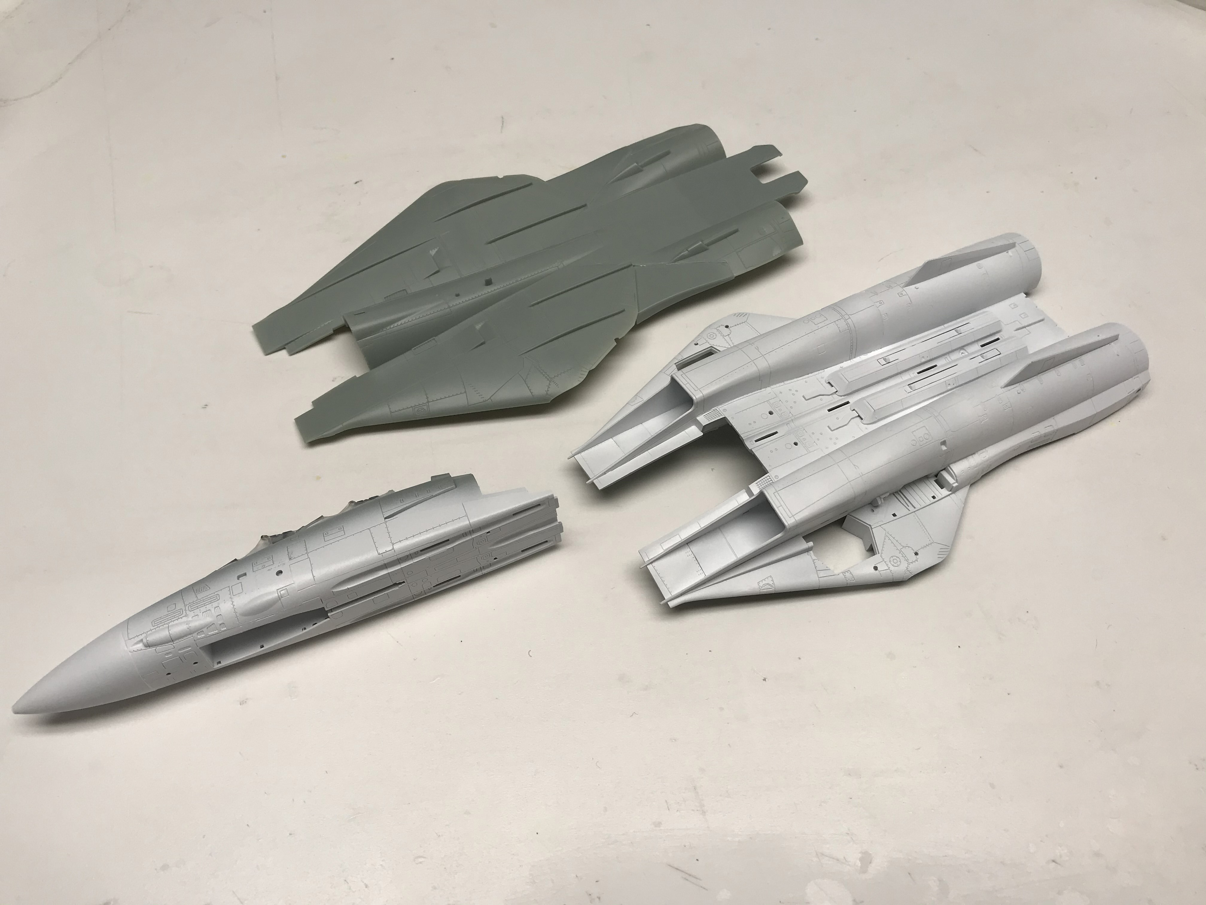

To paint the white areas, I decanted Tamiya Fine White Primer into a bottle and applied to the model with an airbrush. This was easier to manage with the model still in subassembly stage. A coat or two of Mr. Color gloss white acrylic lacquer followed.

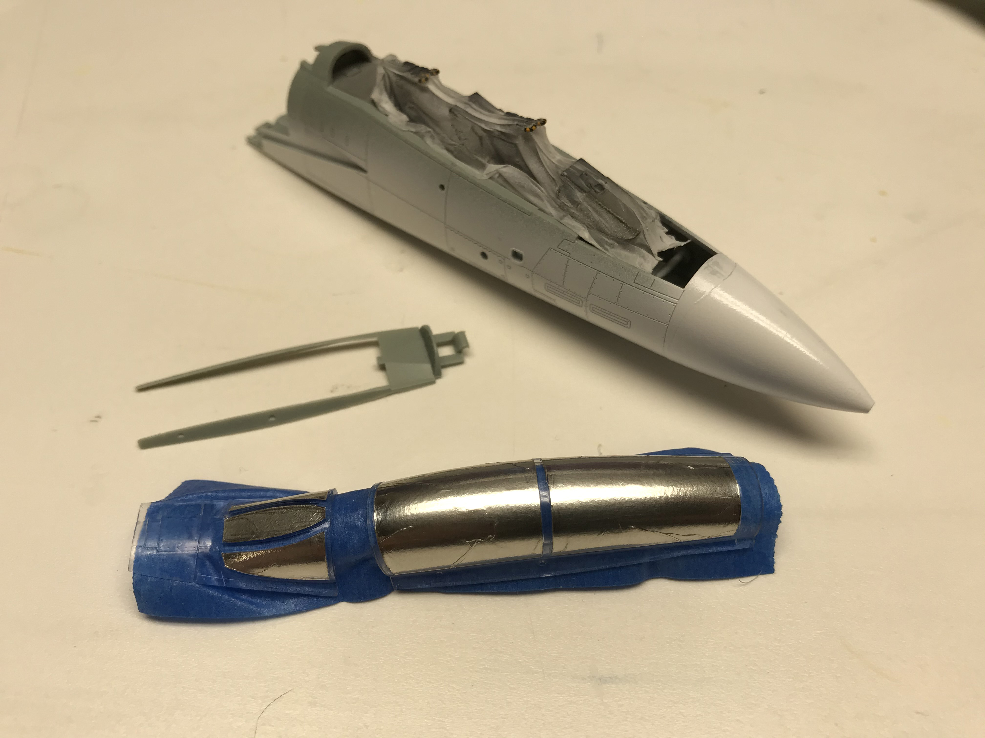

Before applying the topside color, I masked the canopy with Bare-Metal Foil and painted the framing and interior canopy structure flat black. Note the forward fuselage has the cockpit covered with Parafilm M.

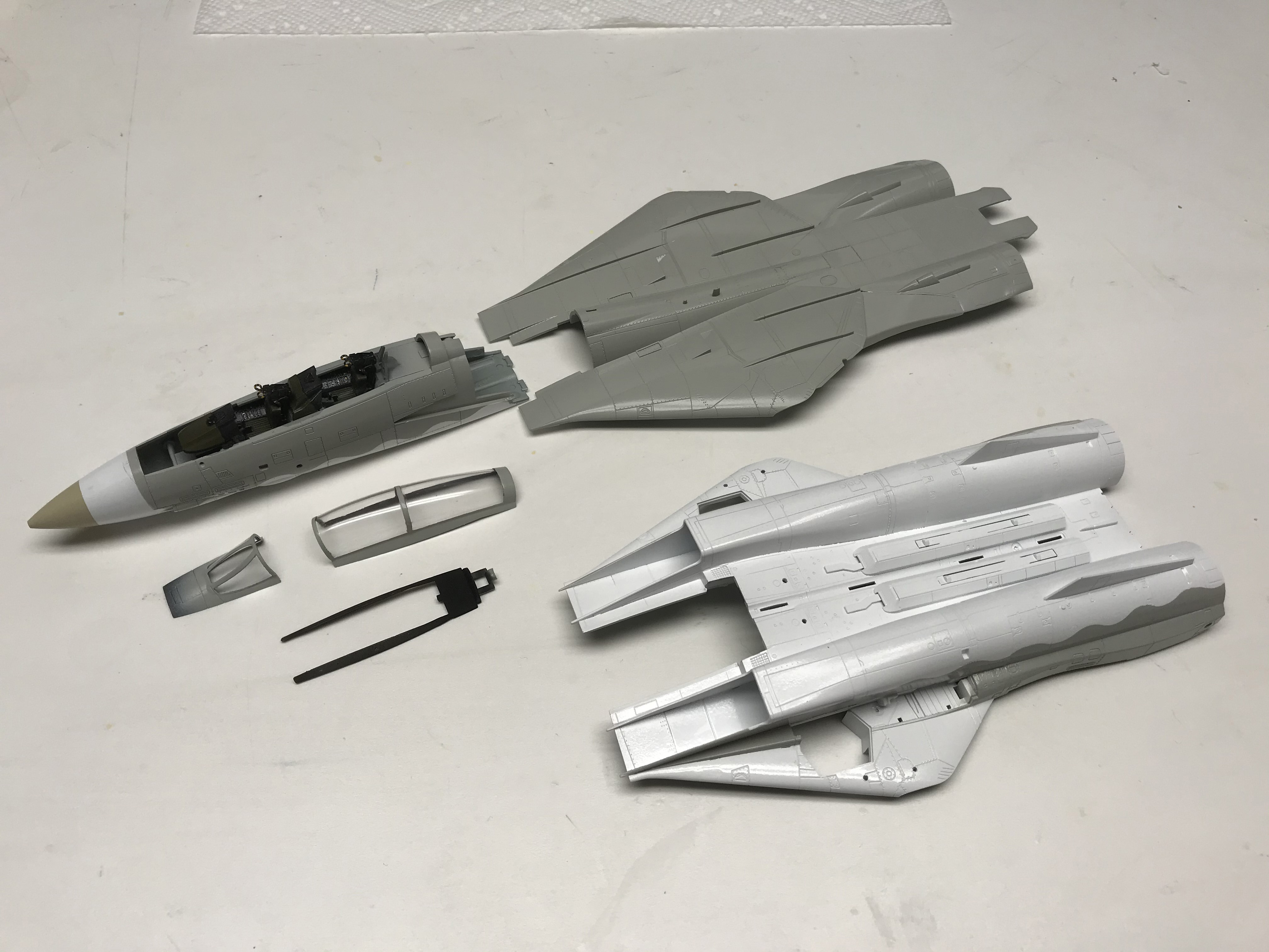

Here are the major components after spraying the topside Mr. Color gloss light gull gray. The wave pattern of the color demarcation line was done with masking tape cut a craft scissors. Then fit of the components was so tight that little glue or seam refinement was necessary.

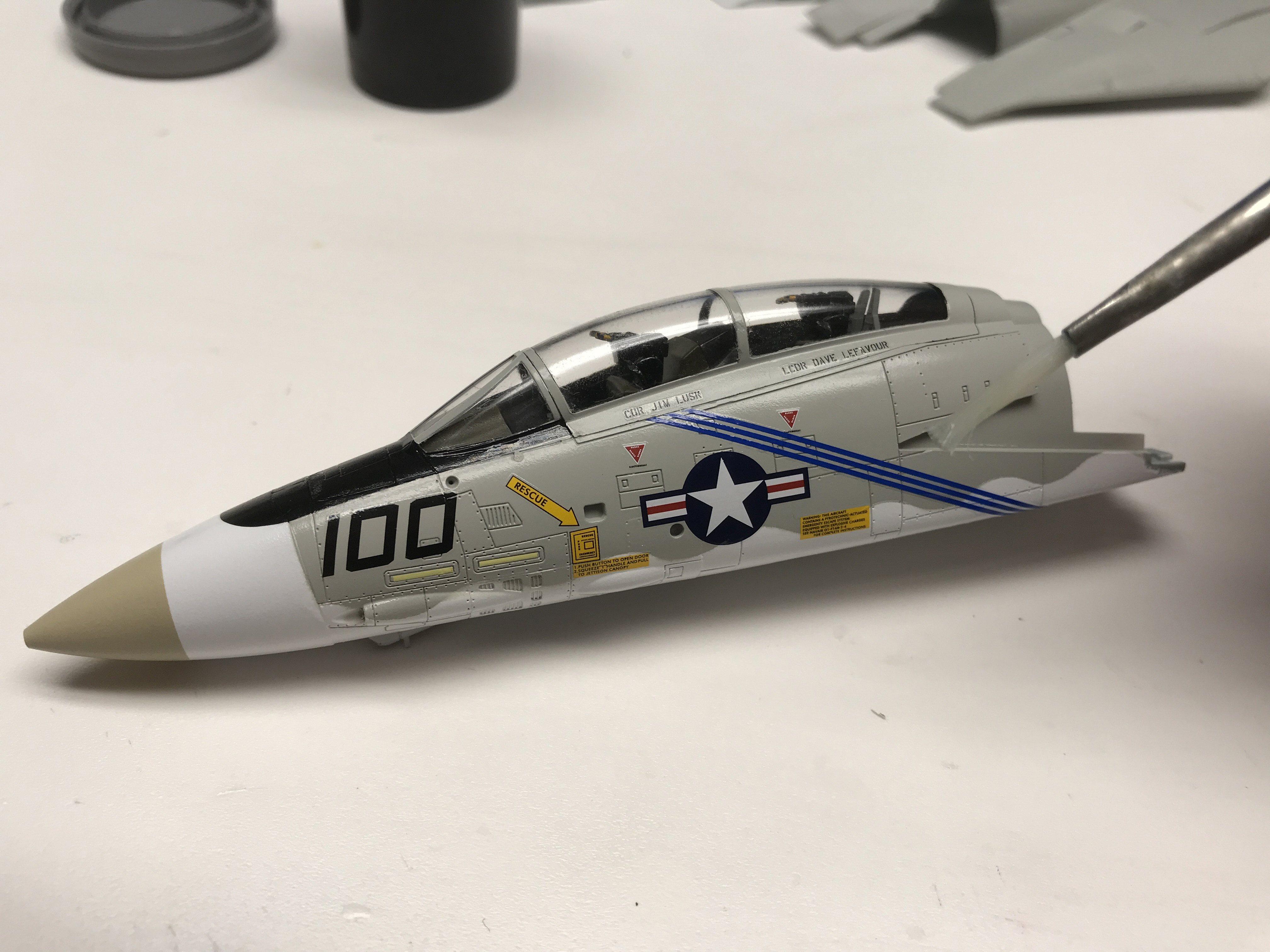

Even decaling was done before merging all the subassemblies. The Cartograf decals fit perfectly and conformed to surface detail with Microscale Micro Sol.
