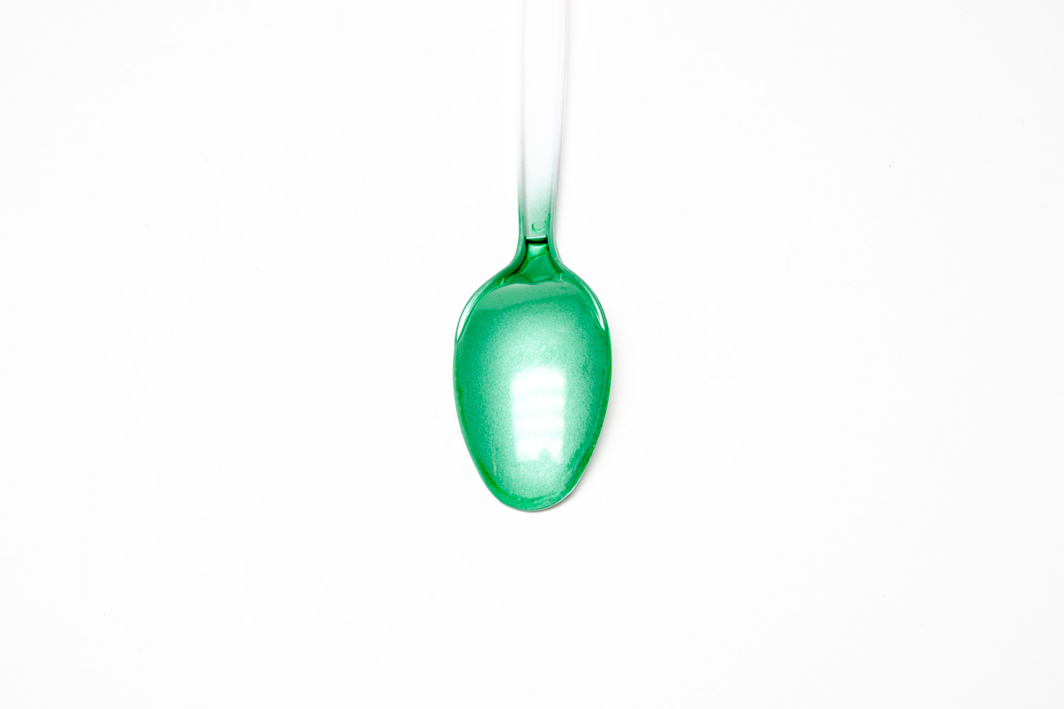

Pleased with those results, I moved on to a larger surface. I primed a spoon and did a first pass with Bright Green (No. ATOM-20084) straight from the bottle. The first coat dried smooth, but coverage was far from adequate. I brushed on a second coat perpendicular to the first, and while the coverage was nearly there, the finish was no longer smooth. I’ll have to experiment a bit more to see if I can get better results — thinning, technique, and a different brush may all affect the outcome. For now, I’ll just stick to airbrushing a larger surface.

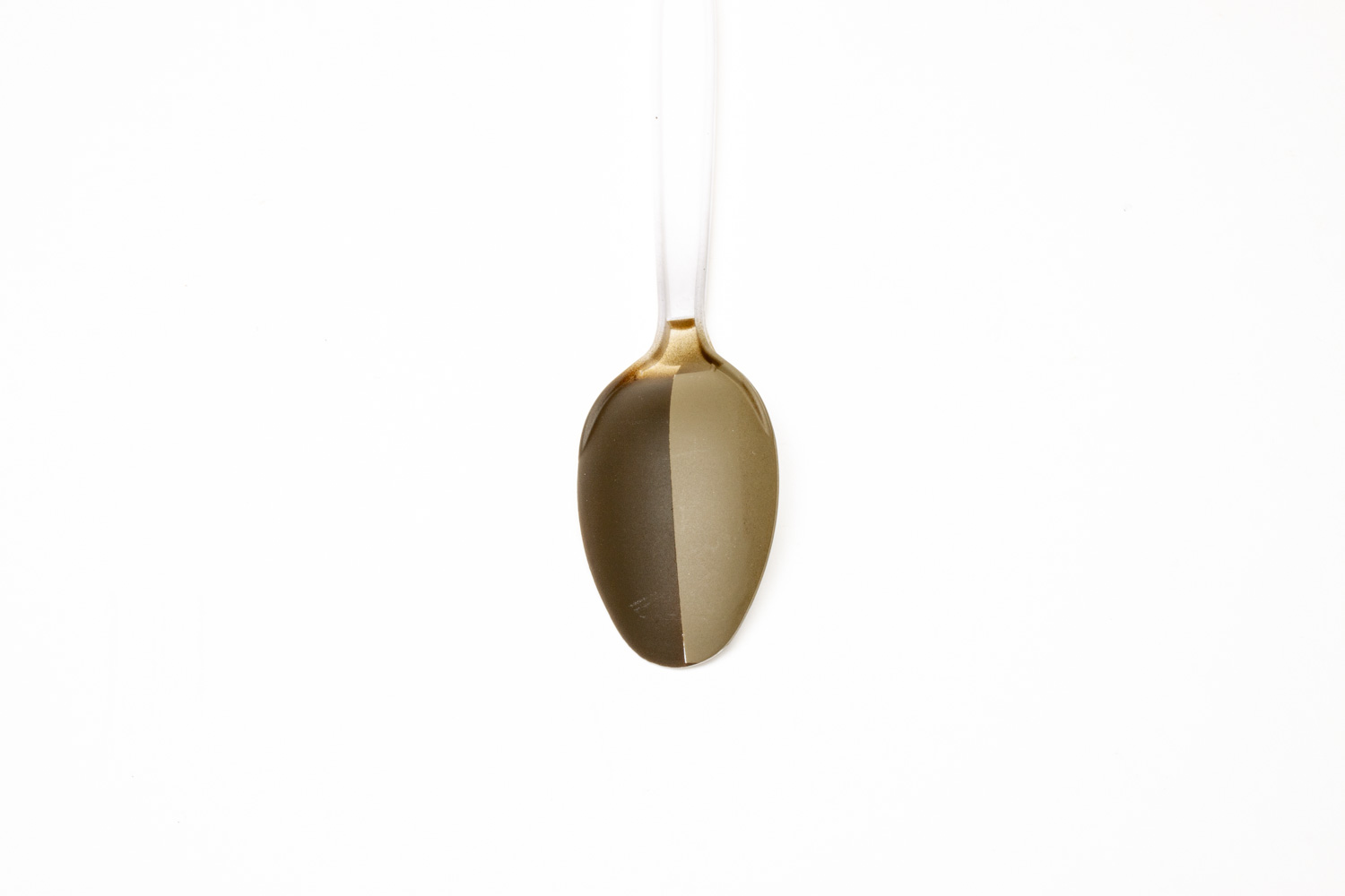

Under normal handling I had no issues with the paint scratching or pulling off with masking. However, a good primer coat does go a long way to increase its resistance. I had to go pretty hard with the old thumbnail test to leave a mark in the primed parts. You probably won’t be putting decals directly on the surface of this paint anyway, but decal solutions (basically mild paint strippers) will soften the paint. I left puddles of Micro Sol, Tamiya Mark Fit (Strong) and Solvaset on the surface and could fairly easily scratch the paint under the puddle. It regained its resilience once dry and didn’t stain.
