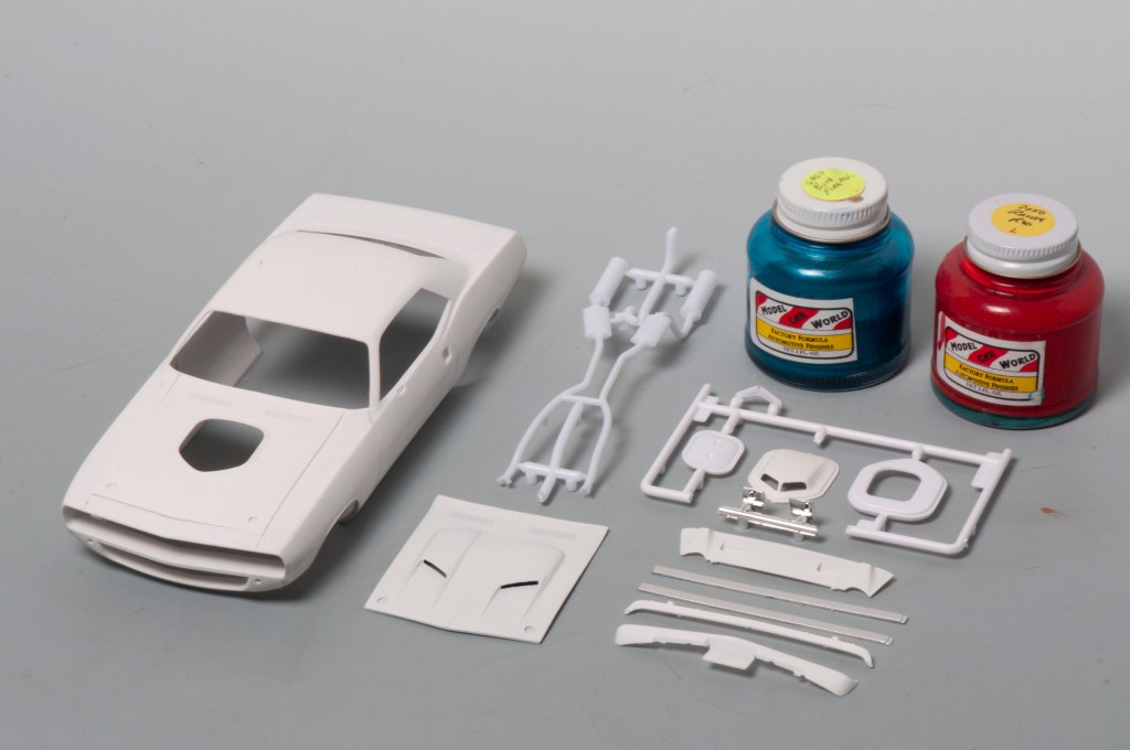

Here’s a peak at my own in-progress kitbashing project, using the AAR body with corrected wheel openings and fender flares (as detailed in the FSM’s Building Muscle Cars, Restomods, and Pro Touring). This factory-stock ’Cuda 340 replica is the car I would have ordered new if had I been slightly older back then. Based mostly on the AAR kit, it will use the rear half of the exhaust system from the Hemi ’Cuda kit and the kitbashed 340 four-barrel V8. I haven’t decided which hood to use, but the paint will be MCW blue fire metallic (No. EB5) or rallye red (No. FE5) because the Shaker hood scoop was color-matched only to these two exterior paints toward the end of the 1970 model year. (All other body colors received either astrotone silver or organsol (matte) black on the Shaker hood scoops.) I’ll finish with the color-keyed Elastomeric bumpers, bright wheel-well trim, and the fish-gill rockers. Inside, I’ll paint a late model-year code H6EW (white with red) or H68W (white with blue) interior.
