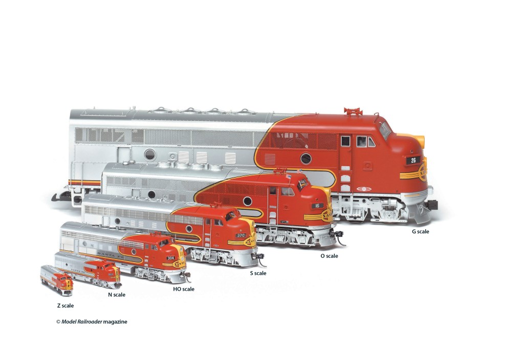

Model railroading scales add a further twist to the story. Again, without getting into the minutiae as to why, model railroading scales are represented by letters (from smallest to largest): Z, N, TT, HO, HOn3, S, O, and G. Wouldn’t you know it, none of these scales have exact matches for popular scale model scales. However, HO (and HOn3) equals 1/87; S is 1/64 (think Hot Wheels cars); O is often said to be 1/48 scale, though it can go as large as 1/45 scale and as small as 1/50 scale (a popular die-cast vehicle scale); and, finally, G is 1/22.5 scale, generally speaking.
