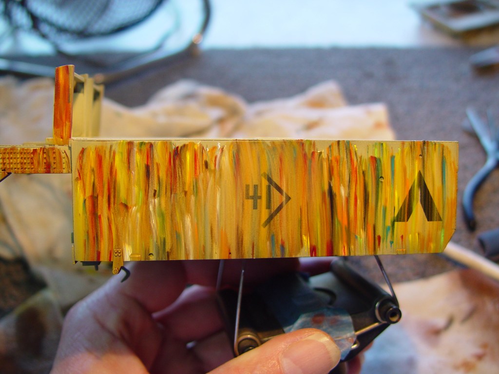

First, make sure you seal your paint and decals with a coat of semigloss or flat clear. Why flat or semigloss? Because those finishes give the filter a bit of texture to hold to. Then randomly apply a multicolored array of artist’s oils over the surface. Yes, there are a lot of colors involved, but you can use the ones you already have on your workbench. Throw them over markings and details with abandon.
