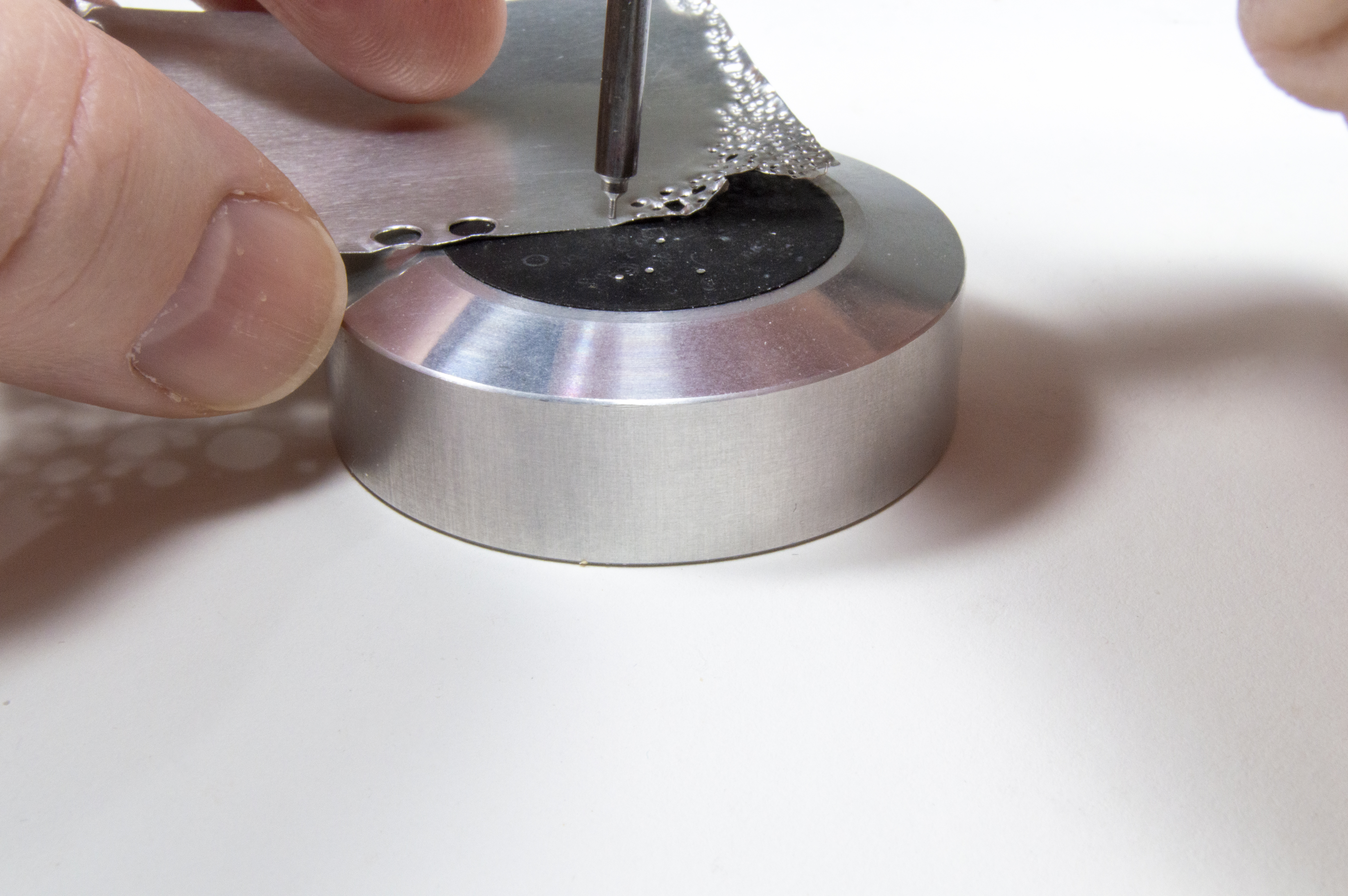

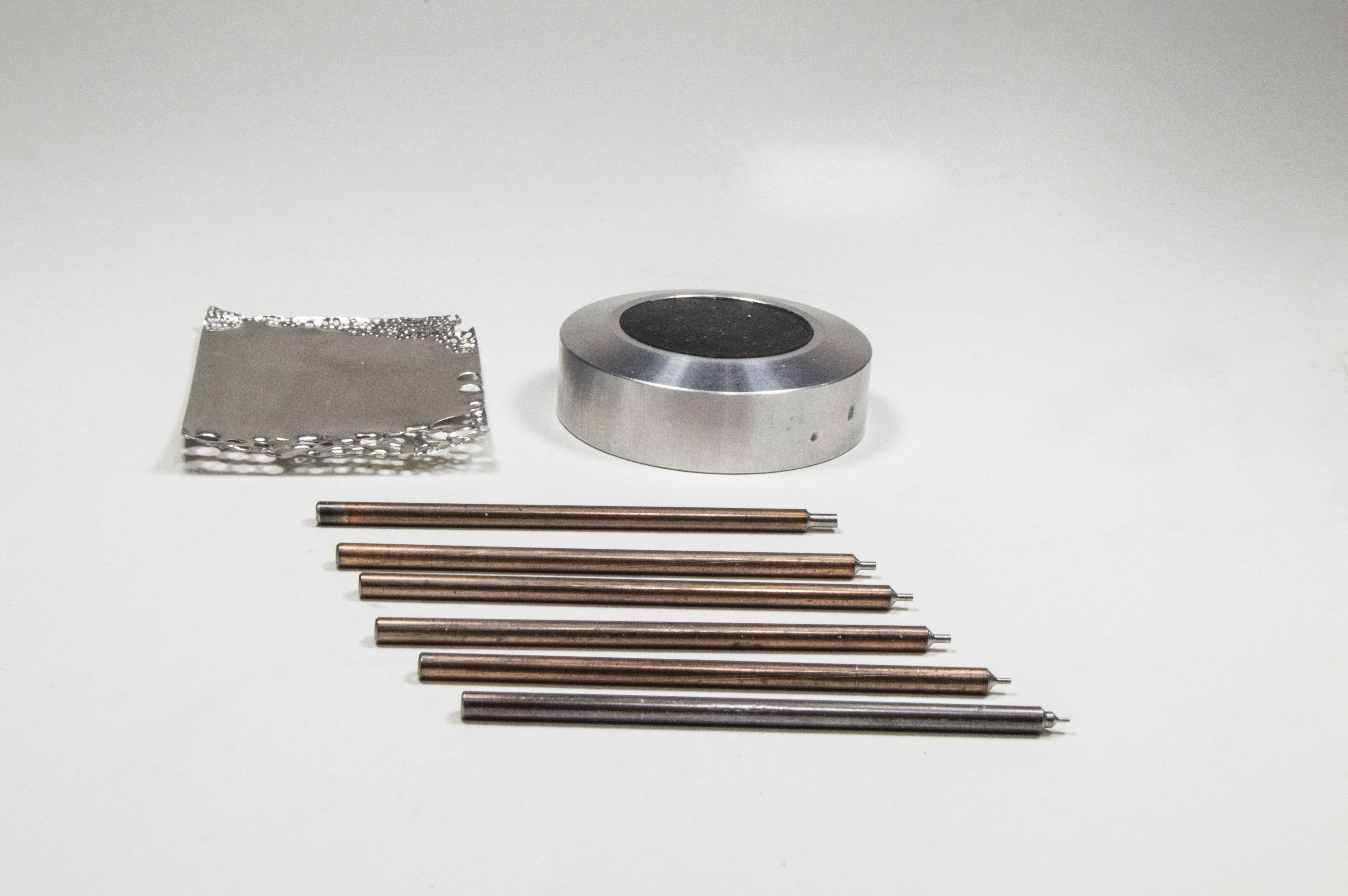

I use UMM-USA rivet punches and the hardened rubber block that comes with the UMM MultiShape Punch Set (No. UMM10). You can punch rivets out of thin aluminum sheet, plastic, or even photo-etched metal.
FSDSNAP010_01
To make the rivets, simply press the punch through your chosen material (I’m using aluminum sheet) and leave them on the rubber block. The rivets are tiny and can be difficult to pick up with tweezers. But don’t worry!

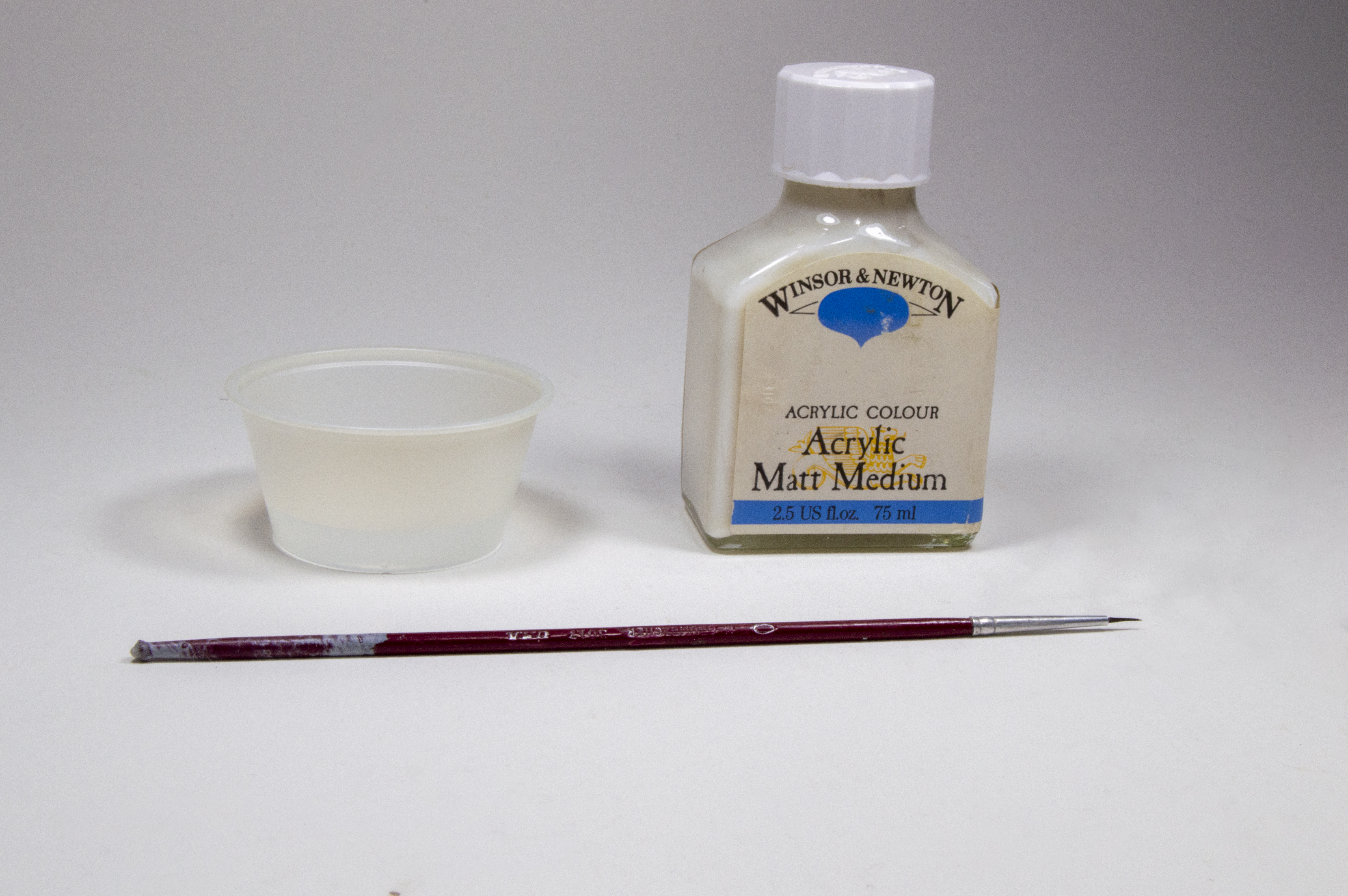

To apply the rivets, you will need acrylic gel medium (I like Winsor & Newton Acrylic Matt Medium), a fine-tipped paint brush (size 0 or smaller), and water.

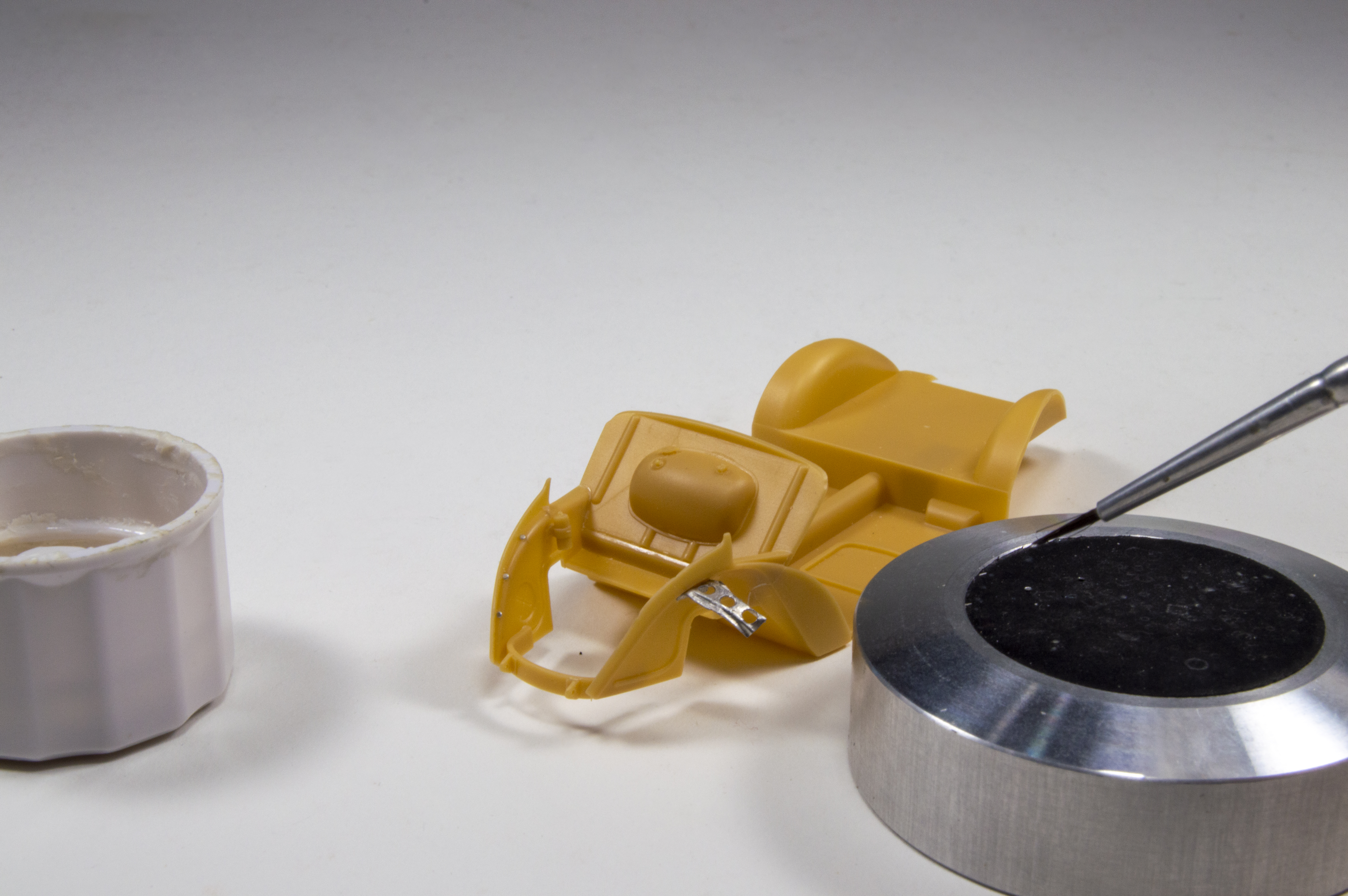

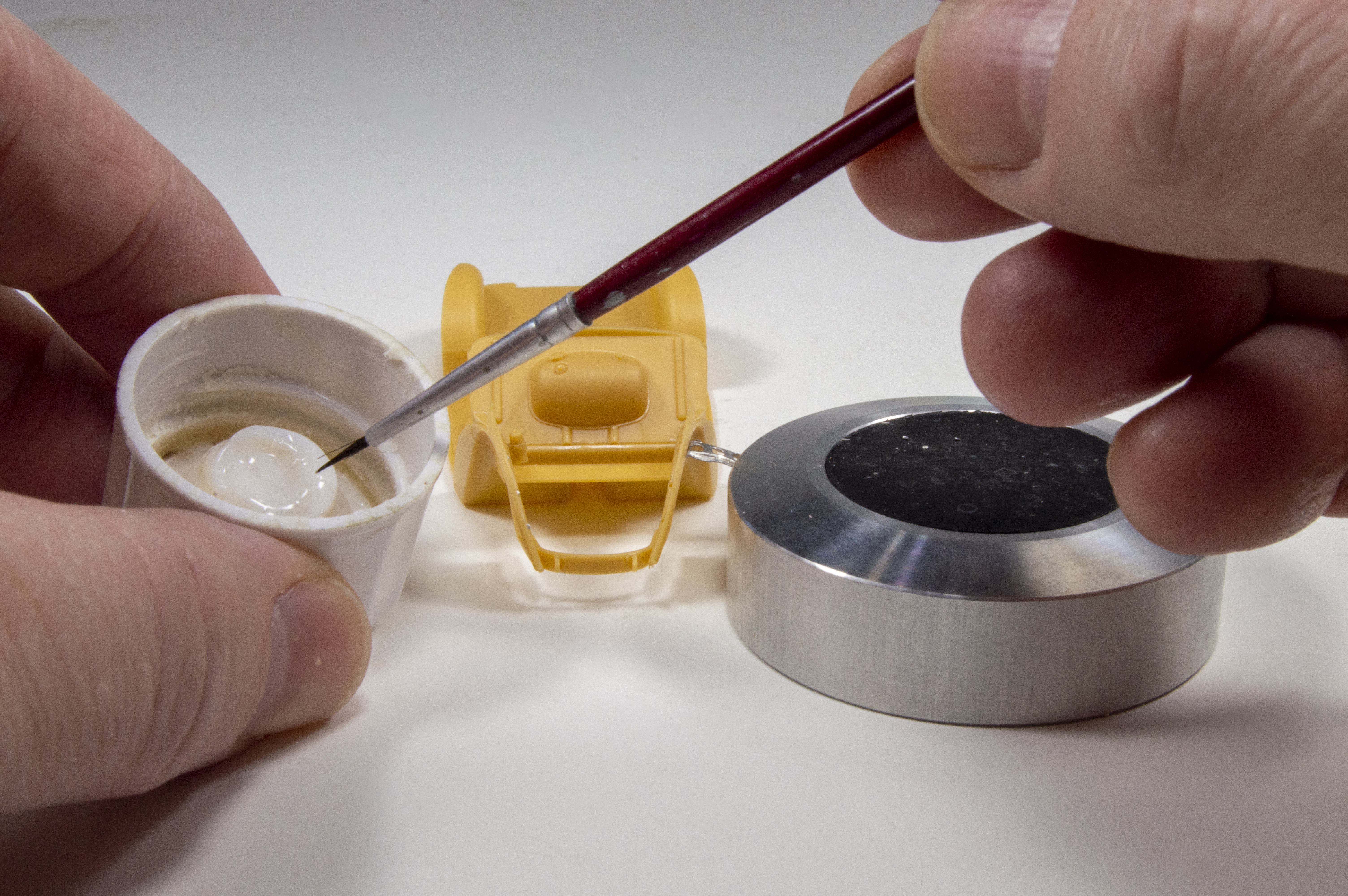

Position the rubber block close to the model and use the acrylic gel right from the cap after shaking the bottle. Wet the tip of the brush with a tiny amount of acrylic gel.
FSDSNAP010_04

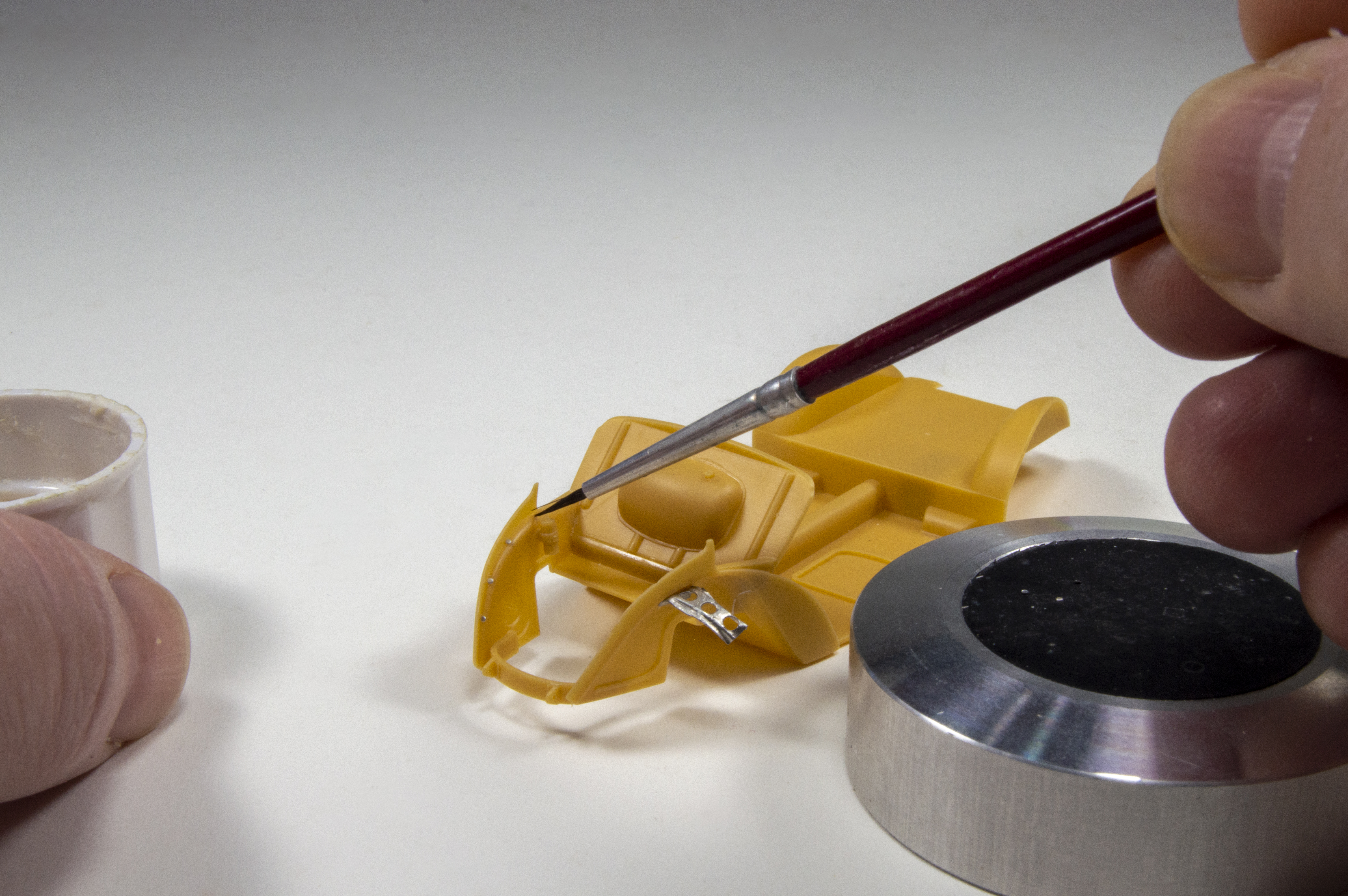

Apply a tiny dab on the model where you want to place the rivet. This will create a spot for the rivet to stick and unload a bit of acrylic gel from the brush.

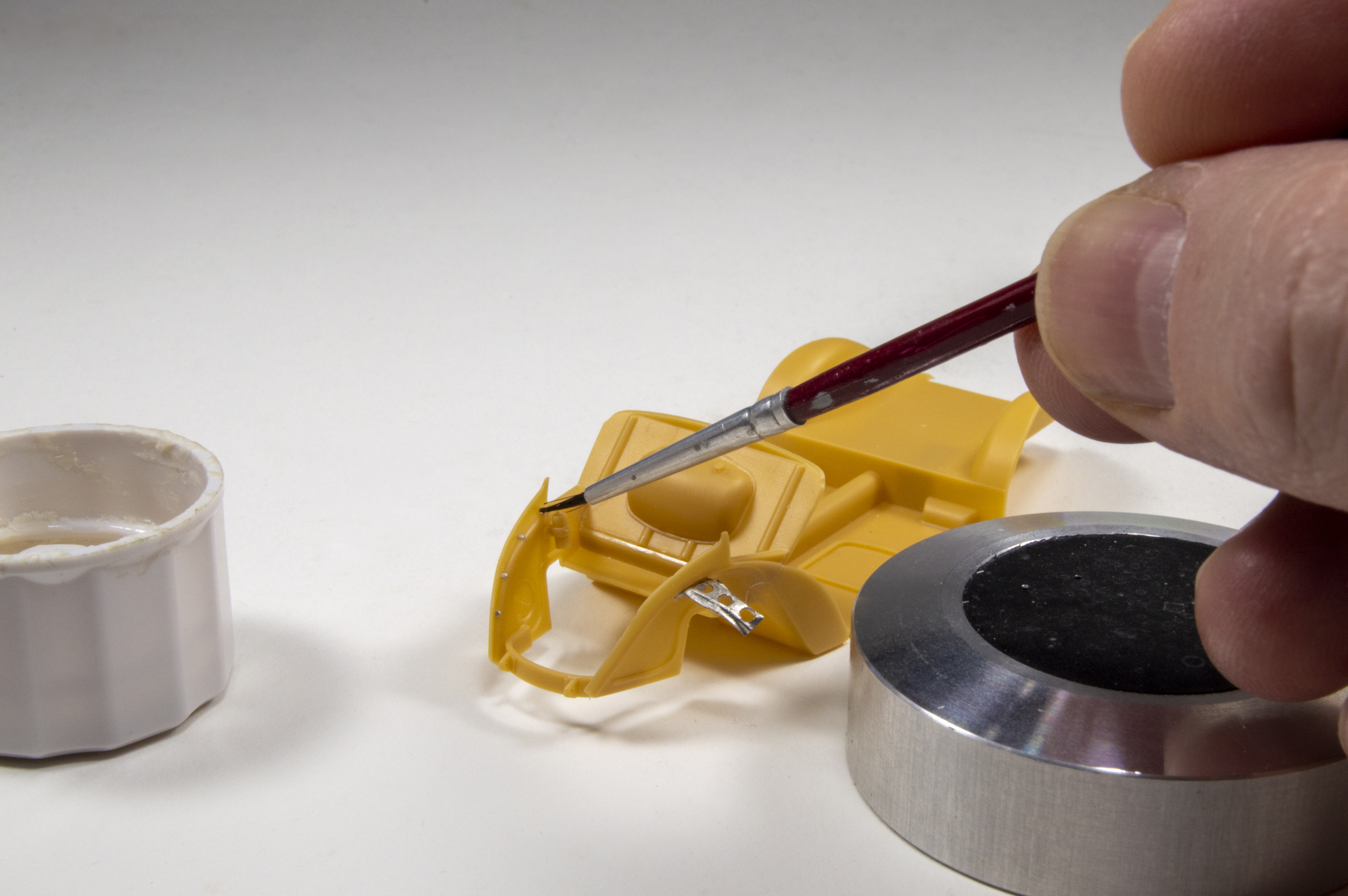

Use the brush to pick up a rivet. The brush should have just enough acrylic gel so the rivet clings to it.
FSDSNAP010_06
Carefully place the rivet onto the spot of acrylic gel on the model. The rivet should stick to the model. The gel will dry after a few minutes, holding the part in place.
