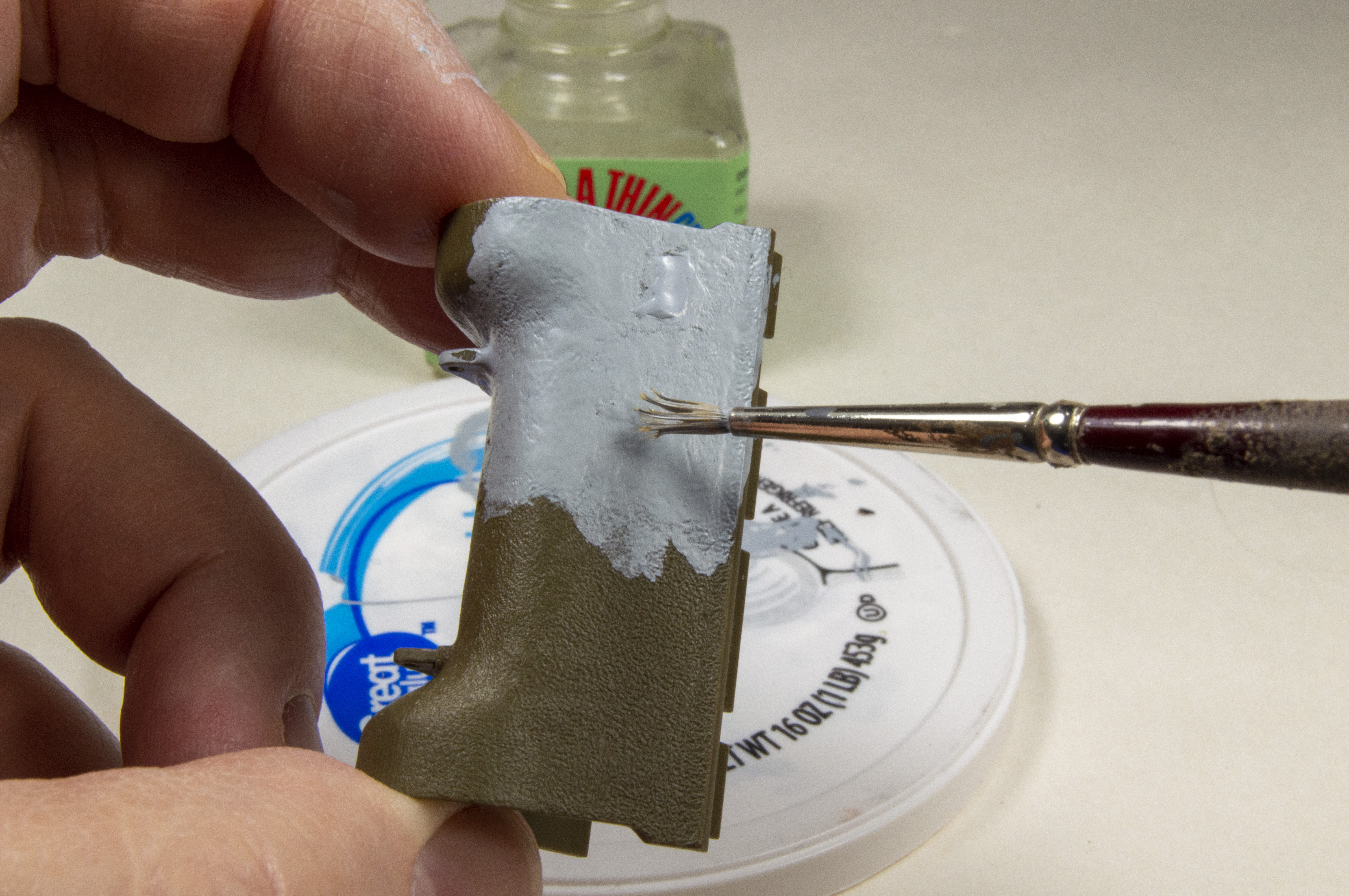

Dab a little bit of putty onto a disposable surface, like the top of a discarded plastic (not styrene!) container or glass dish (the bottom of a baby-food jar works). Dip the paintbrush into the liquid cement and mix into the putty. This will thin the putty.
FSDSNAP021_02
Once you have the desired consistency, stipple the mixture onto the part. It is best to build up the effect with thin coats allowing each coat to dry before the next. Work on small areas to reduce exposure to fumes and keep the task manageable.

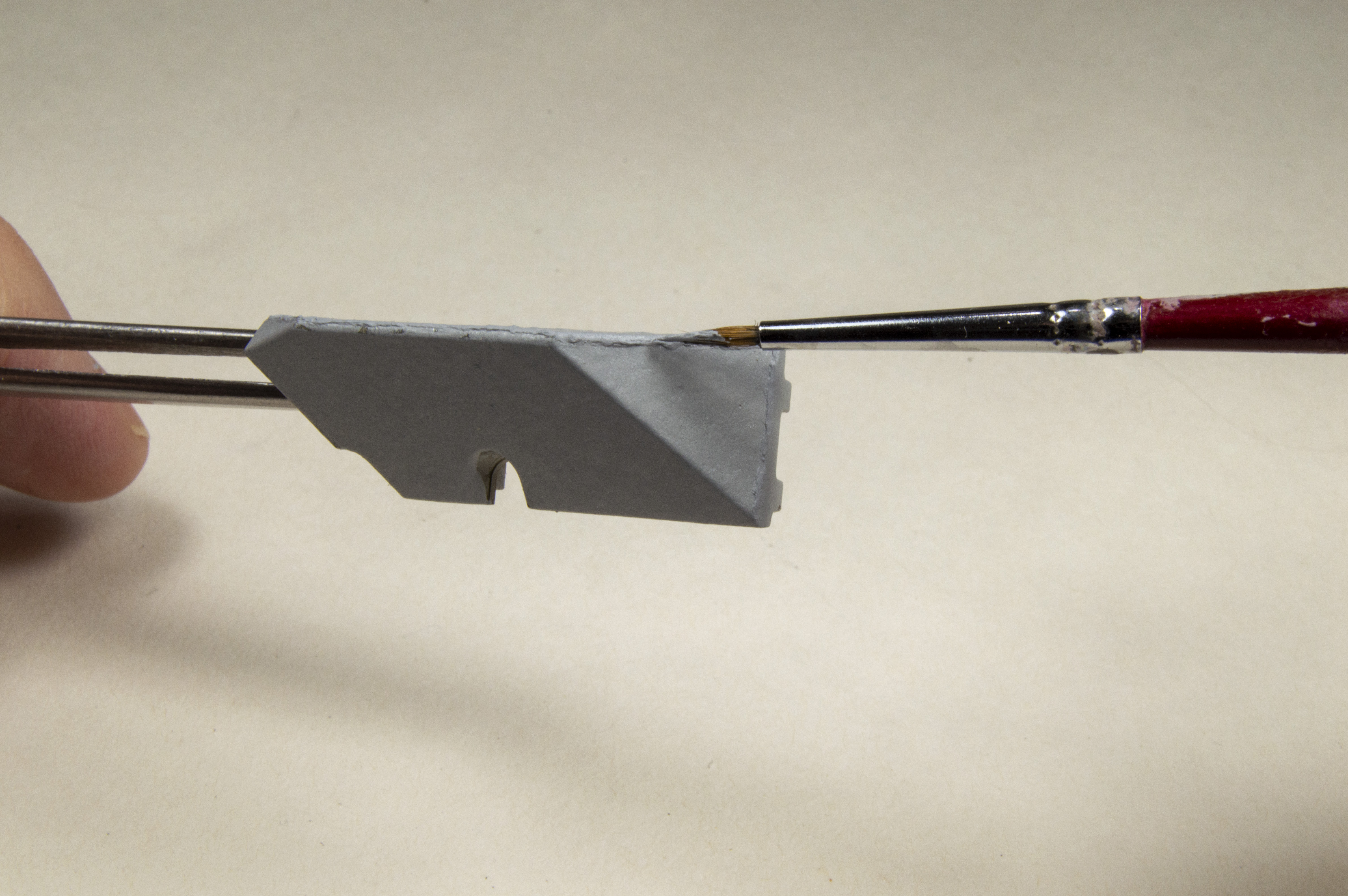

Making a slightly thicker mixture of putty and thin liquid cement and applying with a small paintbrush, you can build a thin line of putty with a texture that simulates fine weld seams that aren’t typically too pronounced on the full-size vehicle.
