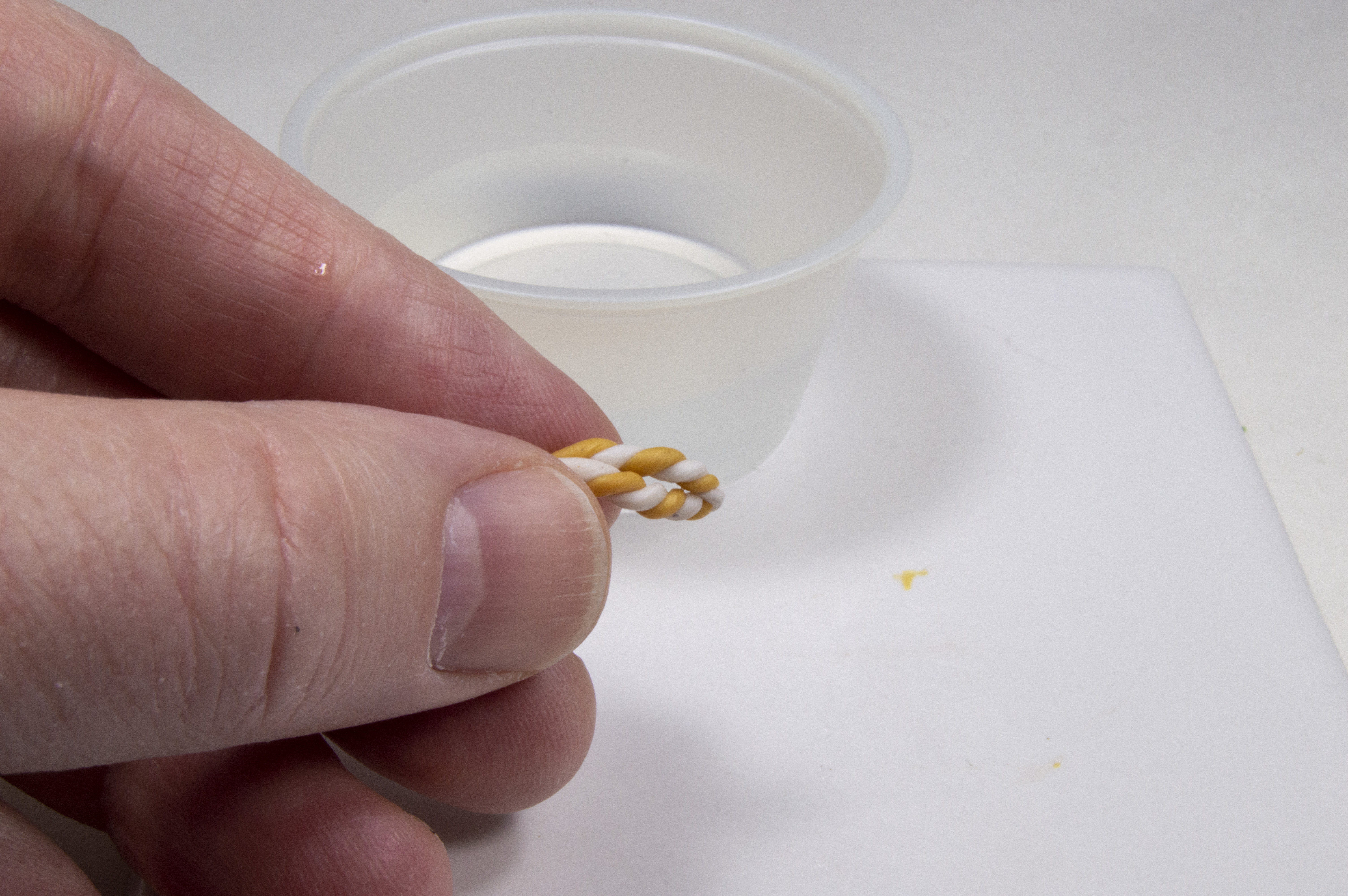

Twist the snakes together and knead them until you get a uniform color. If you have sensitive skin, wear disposable gloves. The putty is sticky, so wet your fingers, tools, and work surface with water to prevent adhering.

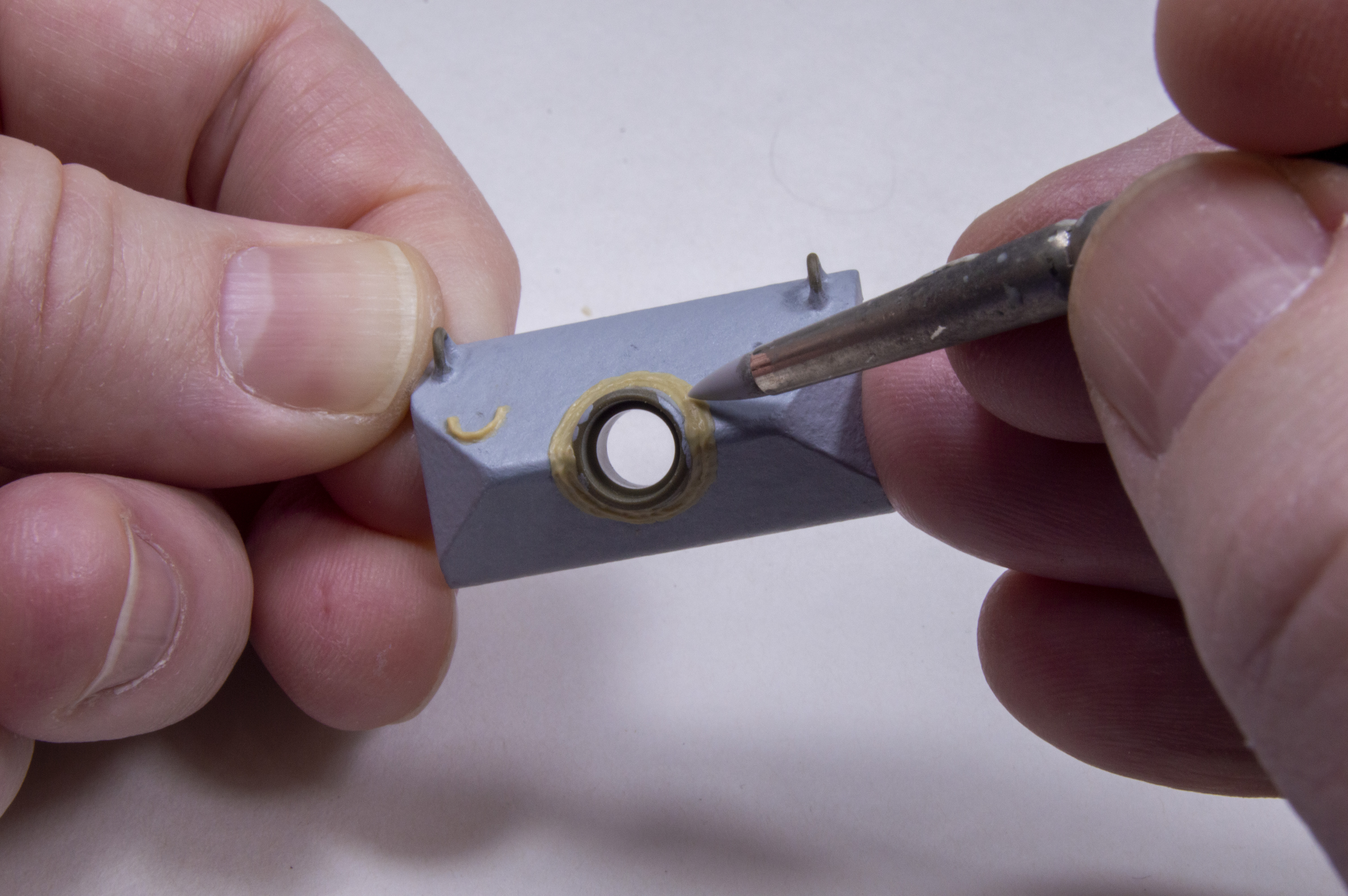

Cut the putty ropes to length and position them on the model with a metal or silicone-tipped shaping tool. Use water to prevent the putty from sticking to tools and work surface, but keep the model surface dry. That way the putty clings only to the model.

After the putty starts to firm up but is still pliable — about 30 minutes — refine the shape with metal tools suitable to the work. Here, a sewing pin chucked in a hobby knife handle adjusts the putty’s shape and adds smaller textural details.
