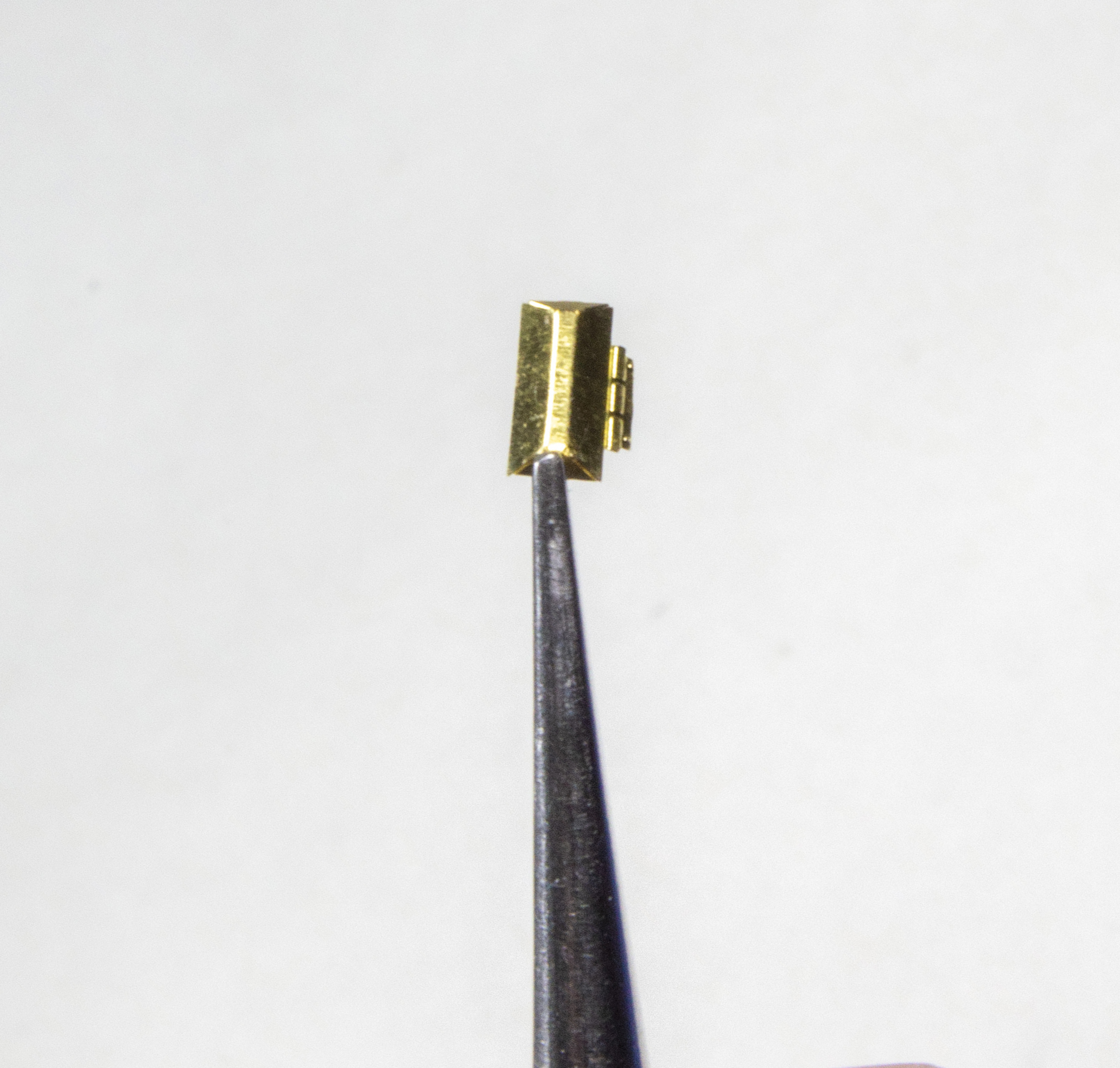

Careful study of the instructions and parts may be necessary to determine the order of bends for complex parts. In this case, a couple of bends are needed to get the main shape of a PE periscope cover, and most were easily done with the bender.
FSDSNAP027_04cropped
I needed one final bend in the piece, but it was easy enough to do with tweezer nose pliers. Simply folding the piece against a finger and bending it with the pliers was sufficient to finalize the shape.
FSDSNAP027_05acropped
FSDSNAP027_05bcropped
Some parts can be bent using pliers or tweezers and a hard surface. For this periscope, multiple bends along the score lines are required to produce a box-like shape. I used Tamiya Bending Pliers (No. 74067) to hold the part and bend it against a hard surface, such as a tile.
FSDSNAP027_06acropped
FSDSNAP027_06bcropped
FSDSNAP027_06ccropped
