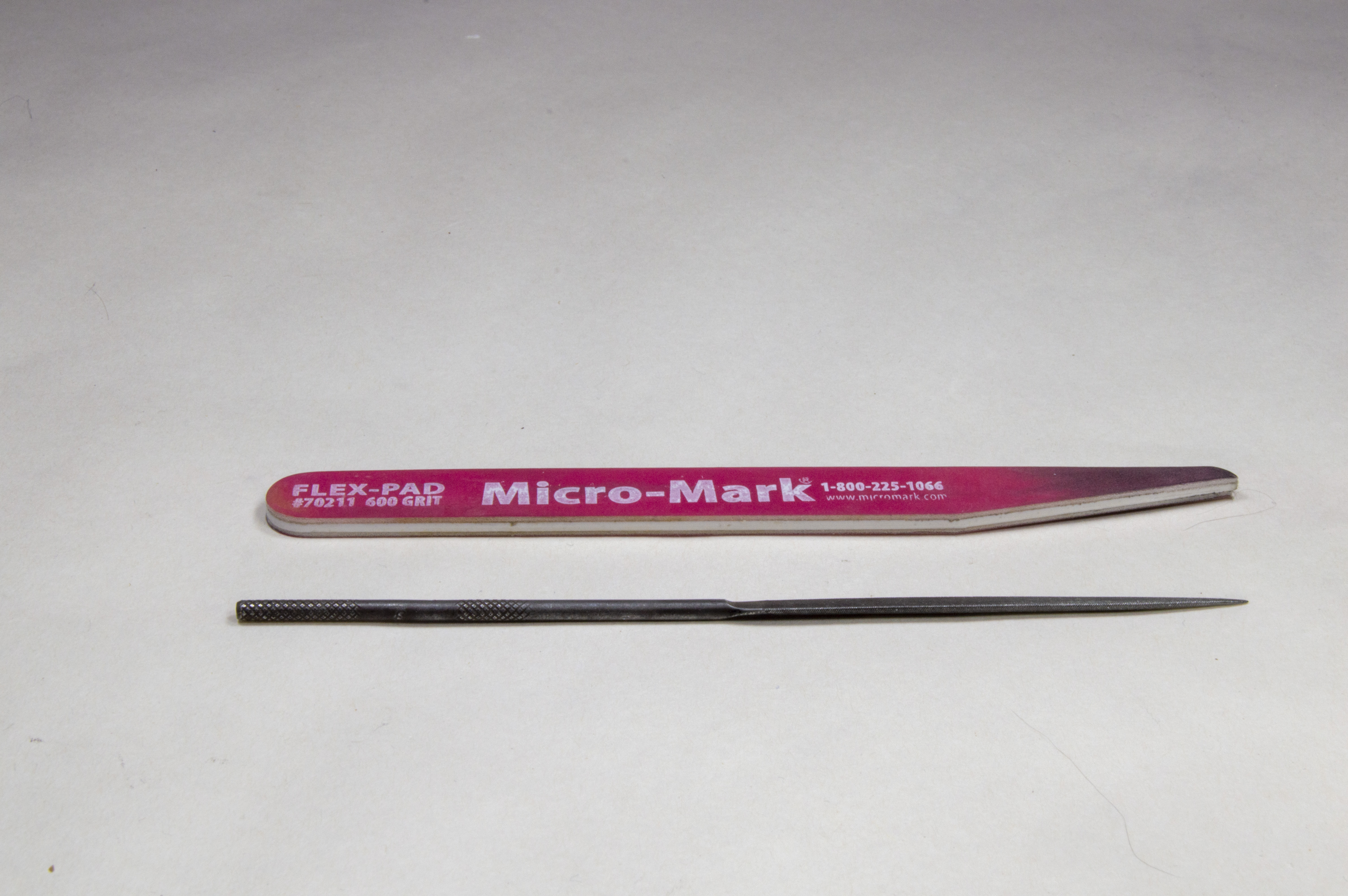

Just like plastic parts, PE requires cleanup with sanding sticks or files. Use fine sanding sticks or files because coarse grits tend to catch and bend the metal. Typically, there is minimal material to remove and it won’t take many swipes to eliminate the nubs.

Hold small parts in tweezers or pliers for cleanup; locking tweezers or fine needle-nosed pliers work perfectly. Hold the part close to the edge that needs to be sanded to help prevent it from bending. Sand parallel to the edge as opposed to perpendicular to minimize damage to the part.
