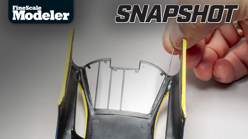

You can see here the Camaro window is wider than the opening. Superglue is one of the best ways to get it to fit. The window has been sanded and reshaped to fit as well as possible, but it is simply too wide where it meets the B-pillars.

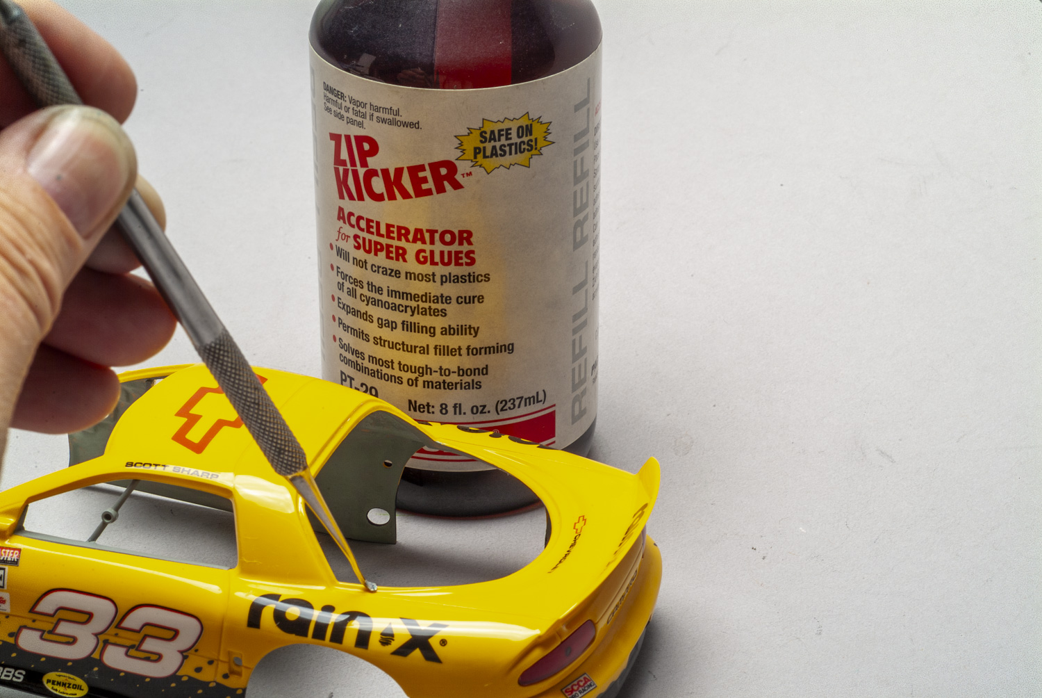

Apply a small amount of accelerator to a few spots around the window opening, not directly to the clear part — it can craze the plastic or affect the paint. Let the accelerator dry for several minutes; the longer you wait, the more time you have to position the part. The less time you wait, the quicker the superglue will cure.

Tack the part in. For this window, I tacked one corner at the base of the B-pillar and let it set for a couple of minutes before gluing the other side. I used a bent straight pin to apply the superglue for pinpoint accuracy. In this case, I placed tape, well away from where the glue was applied, to make holding the window in position easier.
