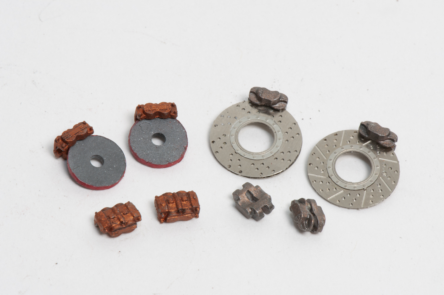

Separately molded calipers are a must with photo-etched rotors (upper right); they can even add detail to molded styrene rotors (upper left). Various types of calipers (lower left and right) are available from aftermarket sources in both resin and white metal.
