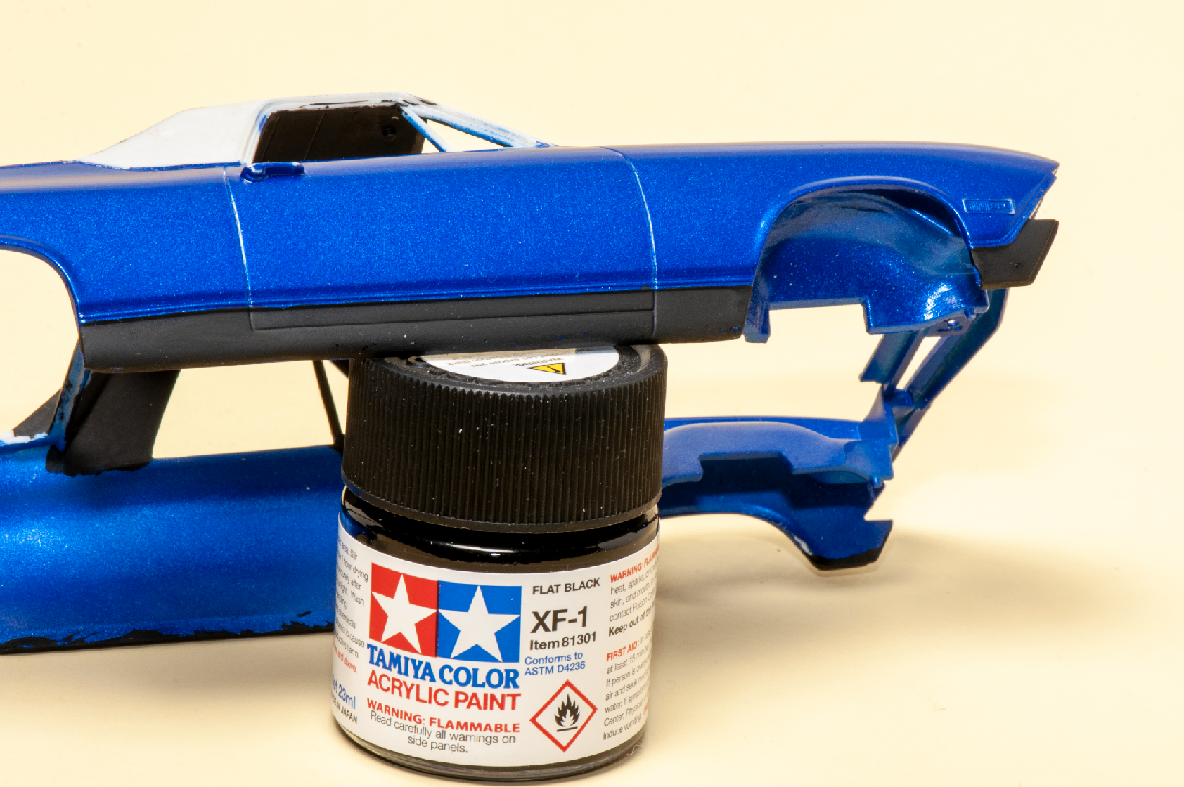

Reproduce the ’68 El Camino SS flat black factory lower-body accent. Apply Tamiya Flat Black (No. XF-1) in a single stroke with a wide paintbrush. Flow the paint on with a fairly thick coat and set the body aside to dry. A day later, repeat the process on the opposite side.

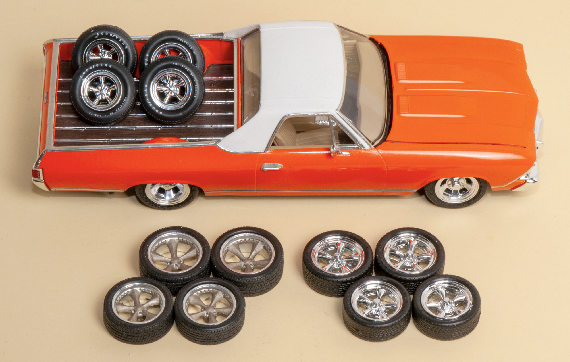

Replace the kit’s 1985 supercharger and fuel injection system by combining its Chevy big-block (left) with contemporary intake/ exhaust options like those in the Revell Foose Eldorodo Chevy 502 (No. 85-4435) or the AMT/Ertl 1967 Impala Street Machine (No. 8208).
FSDSNAP078_13
For wheel and tire choices, go to the aftermarket or other kits, like the Revell Foose Ford FD-100 (No. 85-4426) big ’n’ biggers (lower left), the Revell-Monogram 1959 Corvette 2-in-1 (No. 85-2379, lower right), or the five-spokes in the AMT 1968 El Camino Coca-Cola kit (bed).
