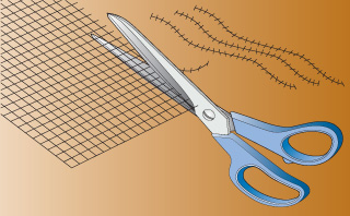

I’ve discovered a cheap way to make barbed wire: Buy a linear foot of the metal-wire mesh used for screen doors. Then, carefully cut the strands apart, bisecting the weaves as shown in the above illustration. You should end up with approximately 200 strands of 36″-long barbed wire lengths that are easy to paint or weather.
