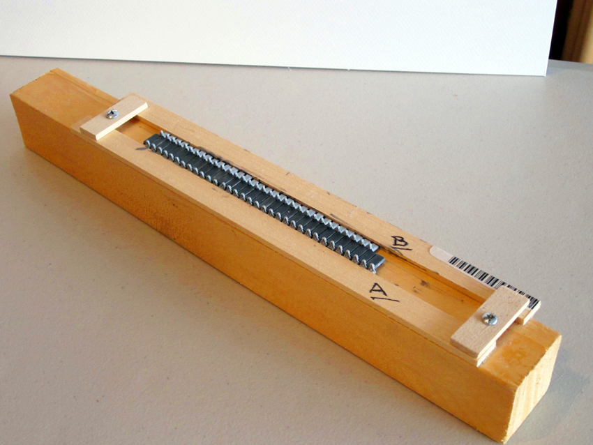

I made a simple jig to make aligning and assembling individual-link tracks easier. I started with a 12″-long block of 1″ x 1″ wood. I glued a strip of wood 10″ x 1/2″ x 1/8″ (Part A) along one edge of the block. Then I cut an identical strip (Part B), but rather than gluing it into position, I secured it with two 1″ strips of wood held in place with screws. This allows me to adjust B to the width of whatever track I am assembling.
