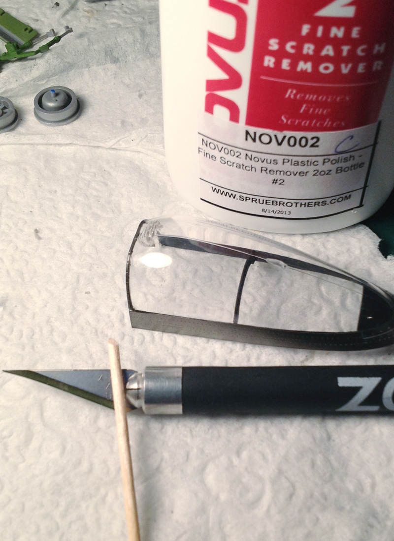

Canopy masks are never perfect, but I’ve found a good way to remove overspray from clear canopies. Angle-cut a wood toothpick to form a nice, sharp, elliptical end. Dip this tip in Novus No. 2 plastic polish and use it to rub away the overspray. The wood will not scratch the clear plastic as the Novus buffs the stray paint away. I can get clean, crisp paint lines, not to mention a nice, clear canopy.
