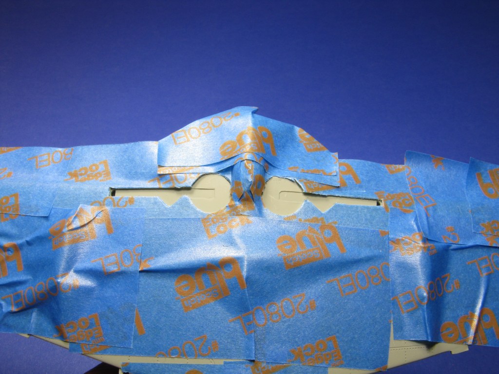

First make sure you have masked the wheel bay area completely, 1.
