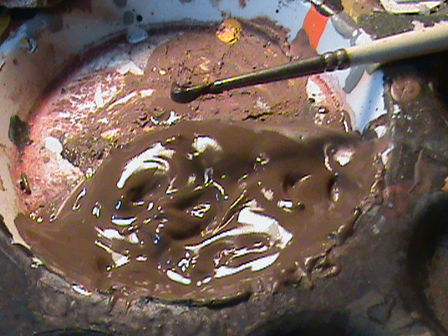

Start with Squadron Green Putty, 1. Mix in paint until you reach the desired color, 2.
Mix thoroughly for an even color, 3. Use a beat-up paintbrush to apply the mixture to the model, 4.
