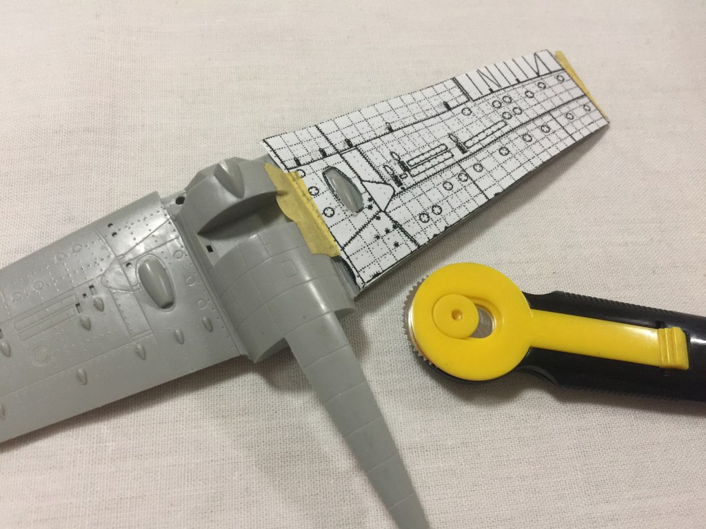

Want to add rivets with ease? First, print out aircraft blueprints from the internet. Then use photo-editing software to scale the drawings to the size of your model. Cut the drawings out and stick them on the model with masking tape.
FSMRT1117_03
Run a rivet tool on the paper with enough pressure to push through the paper. This works great for small-scale jobs!
