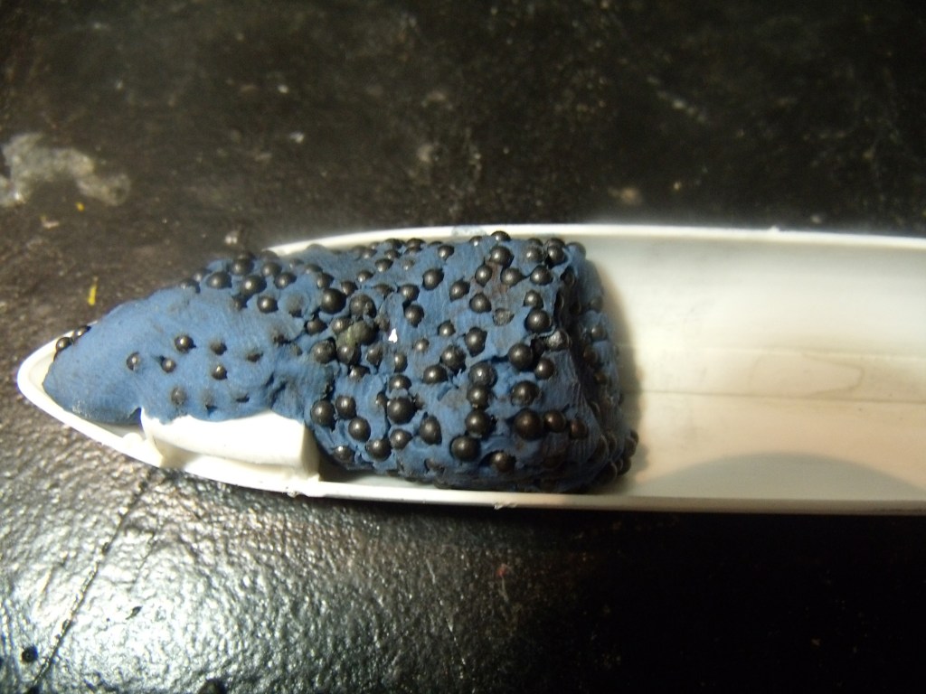

2) Nose weight — Many years ago, I went to a sporting goods shop and bought a 5-pound sack of birdshot (today, there is still 4½ pounds left). I take a wad of clay and knead it into the birdshot until the clay is filled with little lead balls. This can be jammed into the nose, under the cockpit, or wherever you need to put it. On at least one occasion, I stuffed it in the engine nacelles in front of the landing gear. Once you have it in place, paint with white glue to lock the shot in.
