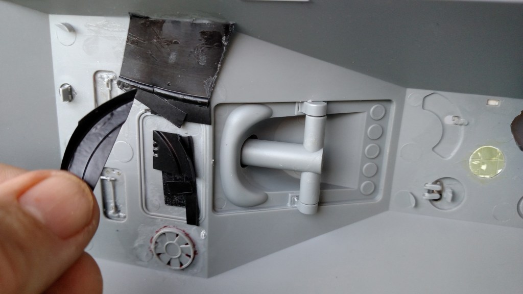

Plastic backing from condiments containers
Many restaurants will give out small black plastic containers so you can take condiments home. I cut these up to use as backing against see-through grilles and hatches on armor models.
FSMRT0218_05
Because no one will see the inside of the hull, I don’t have to be particularly neat with the super glue; just have to make sure that it doesn’t run out through the grilles onto the hull detail.
When it’s done, all anyone will see is black behind the painted opening.
