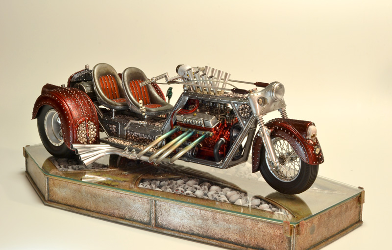

“I counted about 900 skulls on the bike and in the base,” Alex says. “And there are 1,200 Grandt Line .035-inch rivets on the vehicle. Why do I know that? Because I ordered 600 from Grandt Line, and I had to call them up again and say, ‘I need another 600 rivets.’ Each one of those rivets is drilled and set, then cemented. There’re all over the fenders, all over the frame, around the seat, and on the radiator shroud.”
“The gas tank is not really that big, so I put tanks under the chassis,” Alex says. “They’re there. If somebody wants to question it, I’ll say, ‘Wait a minute. If you look underneath, you will see there are tanks down there, plumbed and everything.’”
“It doesn’t seem to make sense to have the radiator in back,” Alex says. “So you make the radiator round — not square or rectangular — where the air will flow over it and back into the radiator. From there the wheels were detailed, and then the rear fenders. That’s all plastic. I had to cut the radiuses out and come back on the corners and start grinding that down to make a compound curve on the fenders.”
Alex says his ultimate goal is “creating a mental imprint. You see one of my pieces, you go away from it, and when you come back you look at it some more. I always stress that I am appealing to the subconscious. If I can grab somebody’s subconscious without them even knowing, then I feel like I’ve accomplished something.”
Alex cut styrene sheet for raised lettering. He says, “There are all sorts of little messages around, my brother’s birthday is on there, and ‘7/7/7’ I built the thing in 2007. There are little messages on the motor and the frame. All the silver parts, the frame itself, that’s all Alclad II metallic with a stippled texture.”
“The intake pipes are called zoomies,” Alex says. “They’re heat-formed styrene tubing. I heat up the styrene tubing and jam it onto a die punch.”
Chief among added detail are skulls of various sizes. Alex says, “The biggest are from Warriors, Chris Mrosko, I got three or four from him and from those I cast 200-300 of them. Of course a lot of them were rejects. The ones in the base are the good ones. The little skulls came from game figures. I just got a couple of 28mm game pieces and made castings from those.”

It’s hard to recognize from the finished model, but Alex’s build is loosely based on Monogram’s 1/8 scale Big T hot rod (circa 1962) which provided the engine, transmission, wheels, and seats. Everything else is scratchbuilt.
Details followed — lots of details. “I just super-loaded it with all that, “ he says. “That’s my style, to put detail on top of detail. I tried to make it look as practical as possible, as functional as possible, and at the same time to do enough to it to blow your mind.”

To model heat distortion on manifold pipes, Alex airbrushed Alclad II chrome, blue, green, and yellow candy colors.
“Those were the bucket seats from the Big T kit,” Alex says. “I studded them with little-bitty rivets. To pull off the leather effect, I went with Alclad II silver on some parts, then stippling, highlighting all the raised surfaces, and emphasizing all the lower surfaces with pinwashes of artist’s oils, pretty much like a figure, to show the highlights and accent the shadows. I finished with a semigloss and was pretty happy with the effect.”
“I did research on carburetor plumbing, generator plumbing, radiator, distributor, and tried to get it as close as I could to the real thing,” Alex says. “The plug wires are from my modeling stash. I have armature wire and clear mini-tubing. The plug wires are clear tubing with a wash of candy apple red.”
