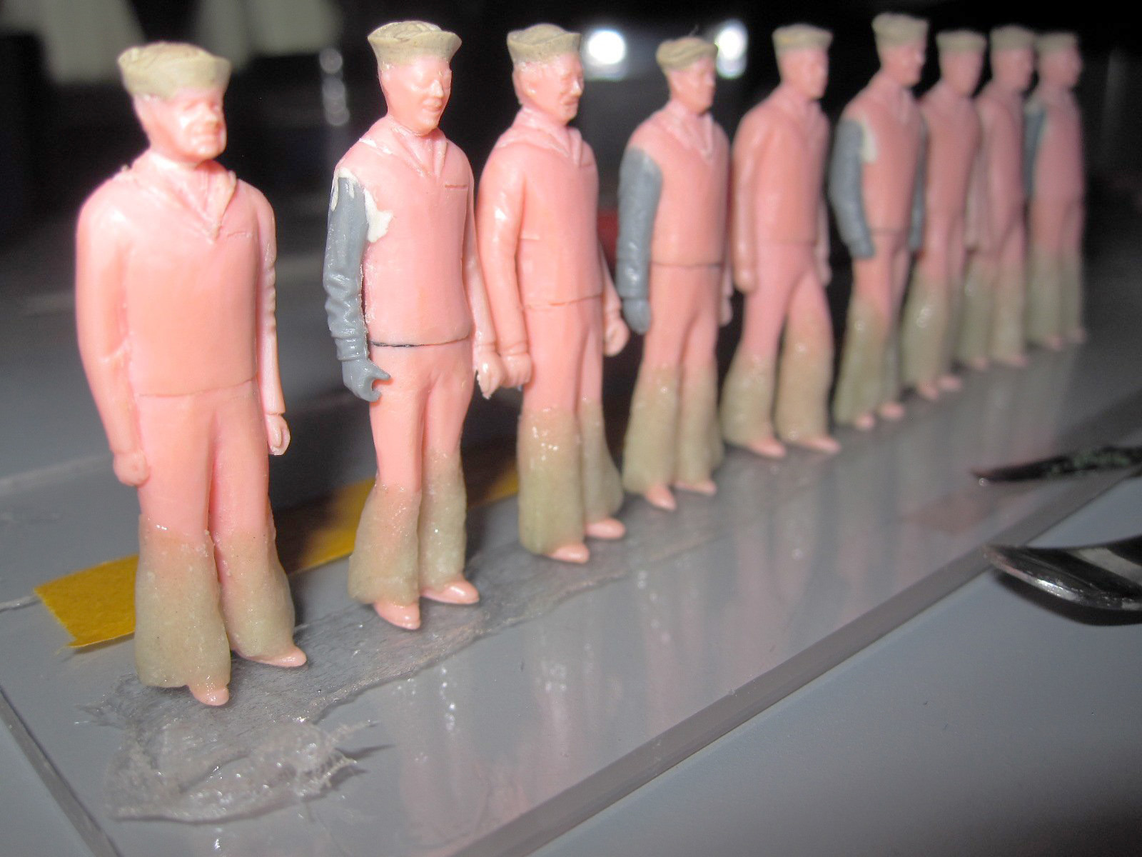

Seeing most, but not quite all, of the figures gives some idea of the scope of Rob’s undertaking. Rob made more than 80 sailor caps …
… and there were Navy officers and Marines yet to come. He made their hats from styrene sheet and strip.

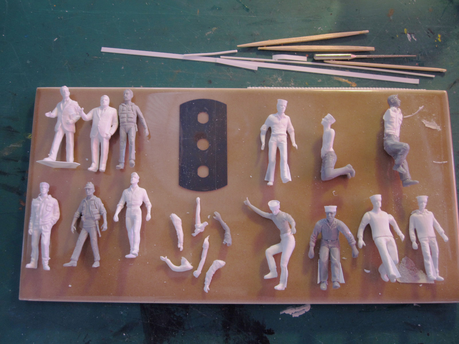

The 1/48 scale figures from K-Lineville’s “Presidential” collection were difficult to work with, Rob says, but useful for the enlisted ranks. He used epoxy putty for bellbottoms and sailor caps, adding .002″ styrene strip to the cap brims.
Nearly all the figures were modified in one way or another for the variety of poses needed in the scene. Rob made the accommodation ladder from styrene rod and strip; surgical tape stiffened by diluted white glue served for the windbreak.

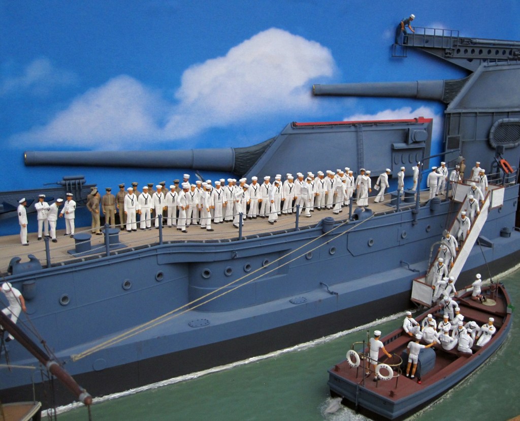

Rob’s figure conversions and attention to detail enabled him to convey the upbeat mood as sailors scamper down the ladder, share plans, trade jibes, and get set for a night of liberty in Honolulu — for many of them, their last.

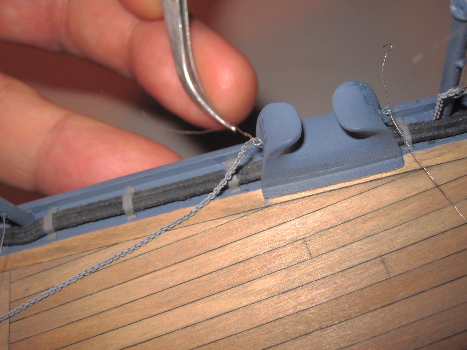

Basswood planks 1⁄8″ thick cover the deck. Rob used more than 10′ of scale chain for lifelines spanning the quarterdeck.
With an unrelenting dedication to research and detail, Rob Bracci spent 10 years building a diorama to portray one moment in a day in the life of a U.S. Navy battleship. Officers on deck, performing their customary duties … sailors going about their usual jobs up and down the ship … another contingent decked out in whites, queuing up for liberty on a Saturday evening. The scene would be ordinary, even mundane, except for the place and time:
USS Arizona, Pearl Harbor, Dec. 6, 1941.
No further dramatic device is needed. In context, each of the 97 figures is worthy of regard and every detail is important. Indeed, that may be why it took Rob so long to complete this project. Considering his lifelong interest in World War II, and Pearl Harbor in particular, who could blame him for not letting go of the moment?
“Just another day in paradise with the Pacific Fleet,” Rob says. “Arizona’s crew was anticipating another routine weekend within the safety of the Pearl anchorage and the prospect — at least according to scuttlebutt — of being sent stateside for the holidays. Sadly, for most aboard it was not to be.”

Despite all of Rob’s shipbuilding, the stars of his show are the figures — all 97 of them! He collected a variety in 1/48 and 1/50 scale, then used his razor saw to mix and match parts.
