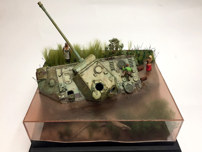

“Wo bist du volk?” Somewhere in Germany, 1945
Where are you people? shows a mother, sister, and boy taking a postwar dip. The female figures are from Verlinden; the boy is from a forgotten past. Jonas added interior detail to a Dragon Panther so he could leave the hatch open.
The water enclosure is polycarbonate plastic (Lexan, or acrylic sheet).
