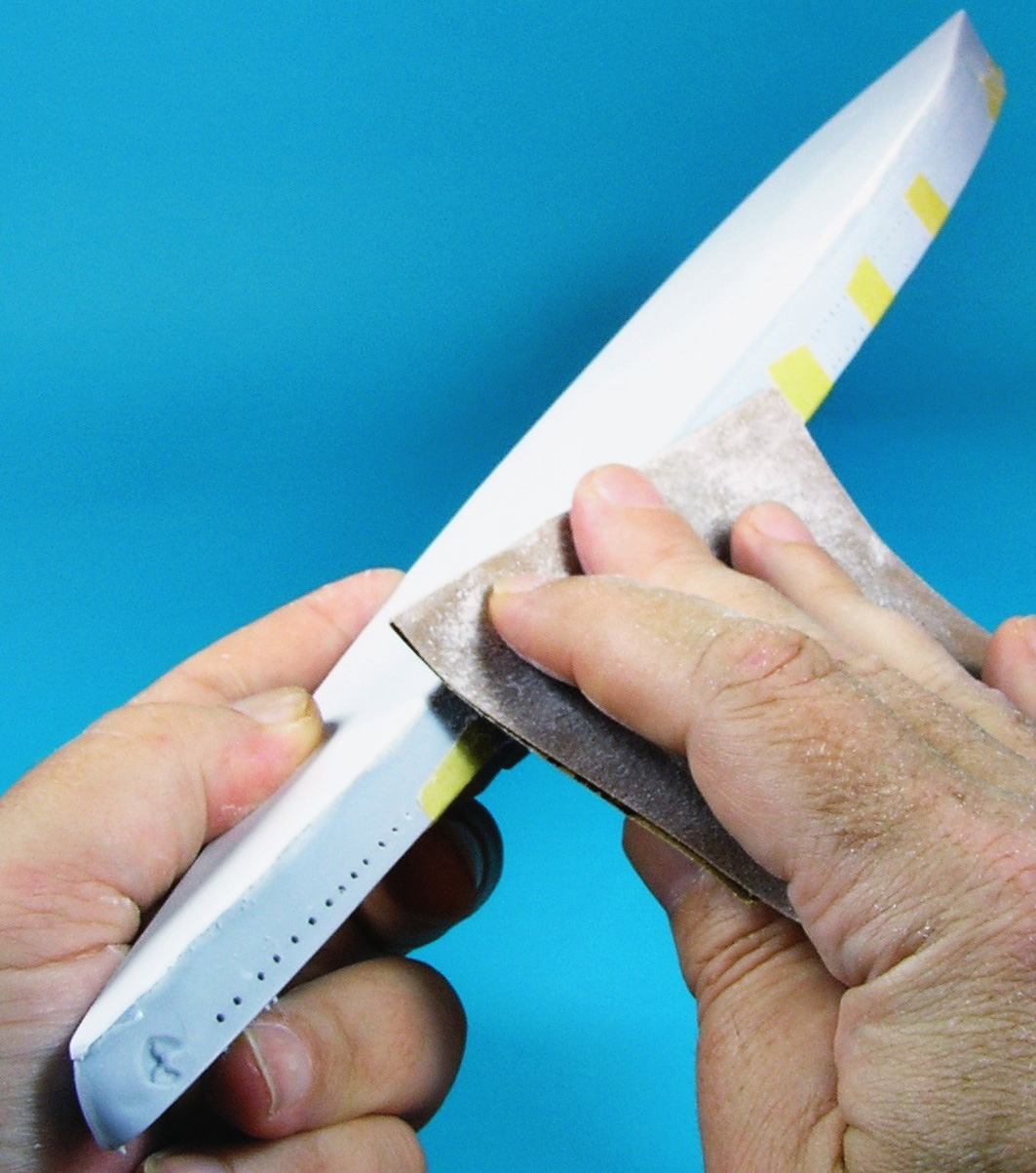

To make sure the hull halves match along the waterline, Ted sands the cut edges even with a sheet of coarse-grit sandpaper taped to his workbench.

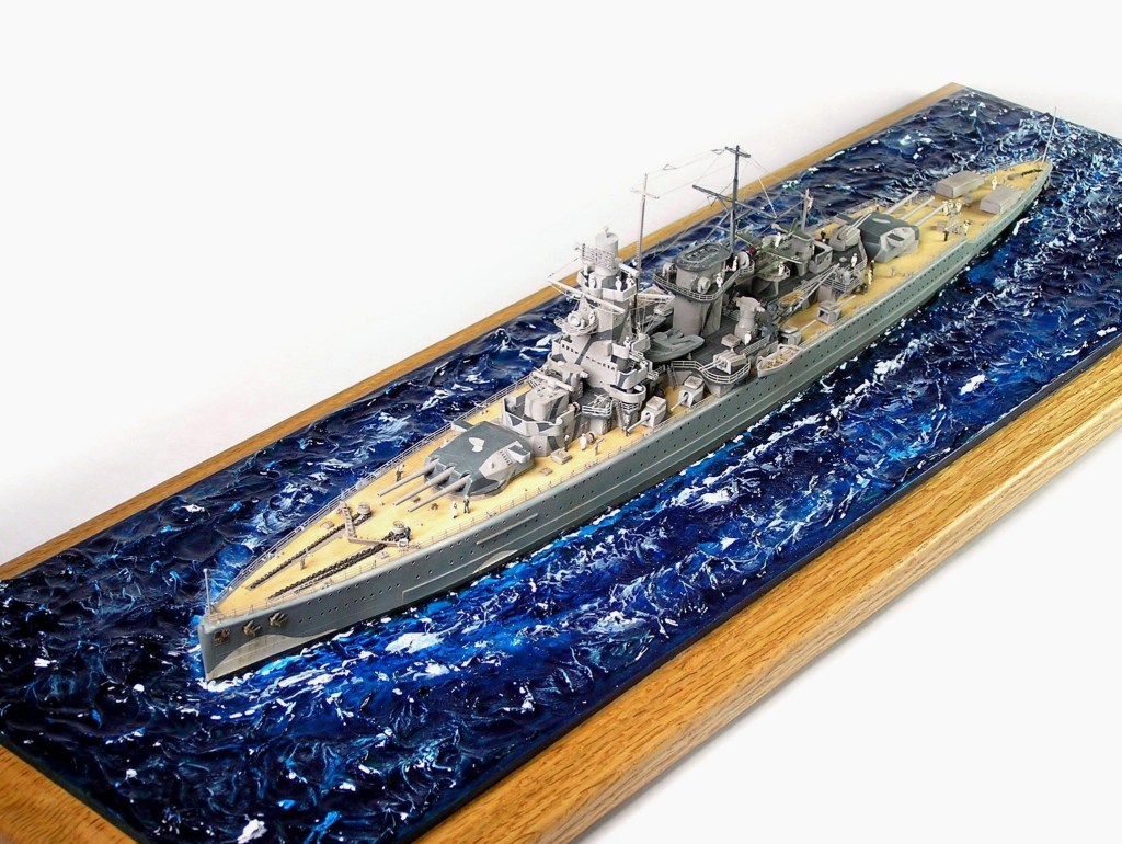

Then, assemble the ship as usual. You can attach the model to a finished wood base or create a sea for the ship to sail through. The choice is yours!
