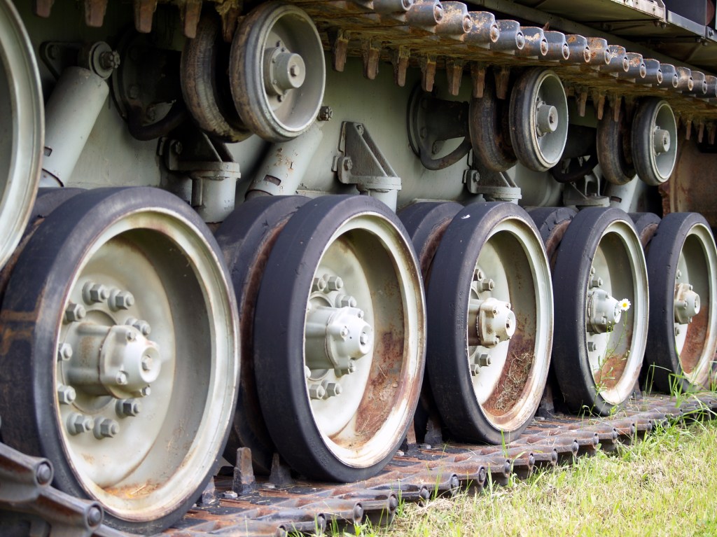

Bogie — Suspension assembly, often seen on older tanks. Easier to repair and replace but more susceptible to damage.
Bogie wheels — The wheels attached to a bogie.

Dead track — This track has bare pins without rubber bushing that pass between the shoes or links. Examples are the Centurion and T-34.
Driver — A crew member who drives the tank.
Drive sprocket — A part of the drive train. Consists of the drive sprockets bolted to the hub. Usually located at the same end as the engine.
Dry-pin track — See “Dead track”

Flat track — This track has larger road wheels that support the return run. Example are the T-34 tank and the M109 self-propelled howitzer.

Lash — Also called “track lash.” Where the track is whipped up and down while the tank is moving.
Live track — This track is self-tensioning with a rubber busing around the pin or pin housing that gives spring to the shoe and reduces both the noise and the power needed to drive the track. Examples are the M109 and Sherman.

Return rollers — Wheels that do not touch the ground but instead support the upper run of track.
Road wheels — The wheels that touch the ground.

Sprocket — What each of the individual projections on the edge of a wheel are called, which engage the track of a tank, pulling it forward, and causing the tank to move.

Suspended track — This track relies on support rollers or skids to support its upper run and prevent track lash. Examples are Sherman and Centurion tanks.

Torsion bar — Suspension assembly, often seen on newer, heavier tanks. A metal bar attached to each road wheel allows each wheel to move independently
