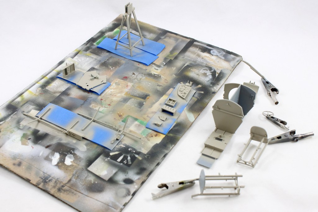

Despite the Gotha being an early World War I aircraft, there’s surprisingly little need for wood parts. The parts have been cleaned up, sprayed with a base coat of Tamiya deck tan (XF-55), and clear coated with an acrylic gloss. They are now ready for simulating wood grain using oil paint.

I usually prepare subassemblies based on their ultimate color; that’s why the landing gear is already done ready for the “very light grey” color called out by Wingnuts. The gear assembly looks complex, but the parts virtually click into place and are very strong.

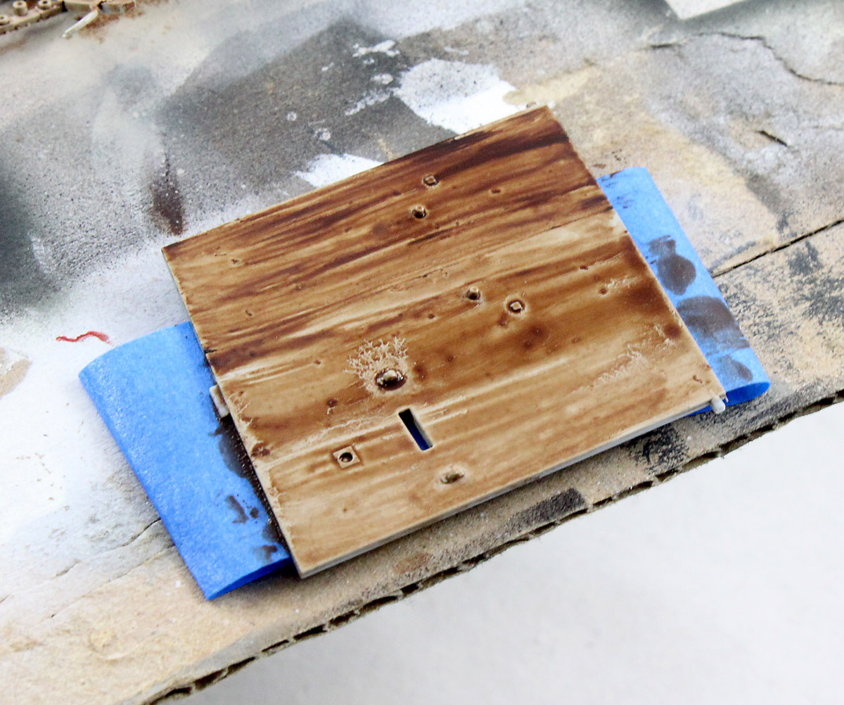

Simulating wood grain is surprisingly simple. I use Winsor & Newton burnt umber oil paint thinned with turpenoid, a synthetic turpentine solvent. I brush the thinned oil wash on with a flat brush in the general direction of the wood grain after the acrylic clear coat has dried.
Even at this early stage the simulated grain is apparent.
All the wood parts have been prepped and are drying awaiting the next step, actually “graining” the “wood.”

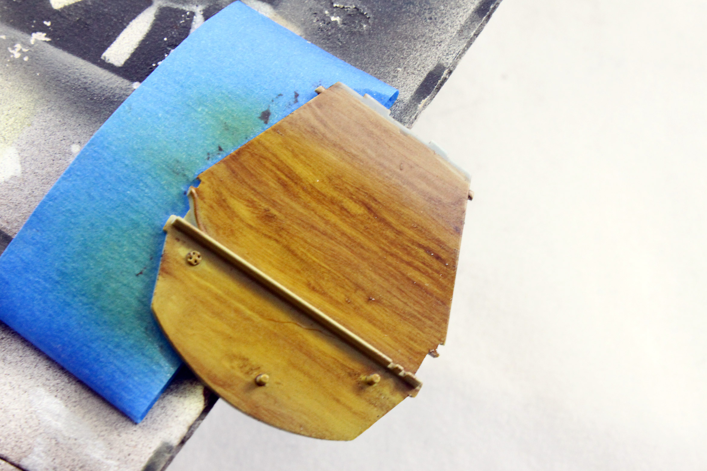

After a couple of hours of drying, I use a stiff, flat brush to stroke wood grain into the oil paint. Twisting the brush slightly and teasing the oil paint results on a convincing pattern.
For variety, I change the direction of the grain if it makes sense.
After adding the grain, you can adjust the “tone” of the wood if desired by over spraying tinted clear coats ¬— in this case, I used Tamiya clear yellow.

There’s really no limit to the number of variations you can create with different tan undercoats, oil paint thickness, grain direction, and overcoat tints. For this kit, the undercoat was all the Tamiya deck tan, but some areas were overcoated in Tamiya clear yellow and others in Tamiya clear orange.

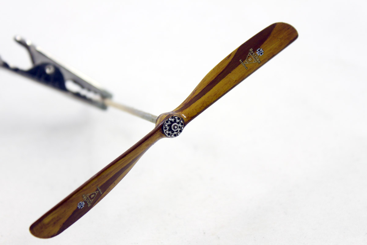

Simulating laminated wood propellers is similar to adding wood grain — just with multiple shades. Remember the props had been prepped with a layer of Tamiya deck tan (XF-55), and clear coated. Then, I masked the laminations with pin-striping tape using photos as a guide. It takes about 45 minutes to mask and about 45 seconds to paint! (Why hasn’t someone come out with mask sets yet?  Seems like they should be a good seller…)
