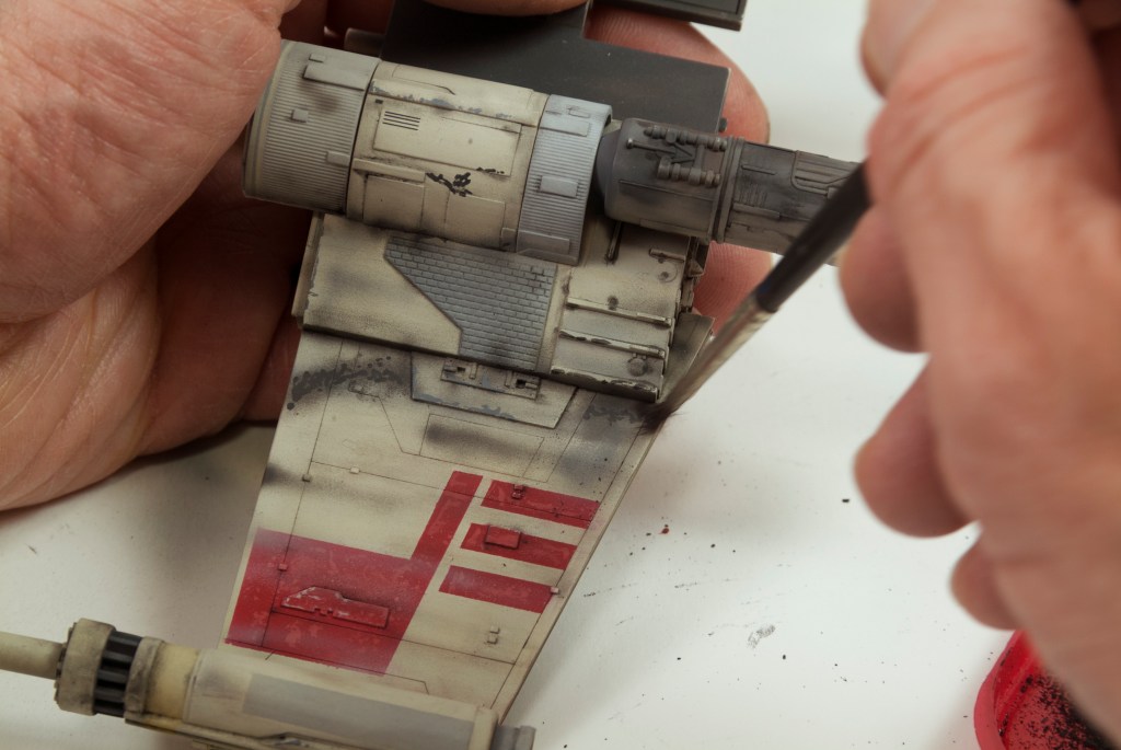

Where there are chips in the paint maybe caused by a laser blast or quickly extinguished fire, gently scrub dark gray pastel powder over them. It helps blend them into the overall weathering so they aren’t so stark.
Now, return the brush to the surface and gently sweep it back from the starting point across the surface in the direction the vehicle primarily travels (typically front to back). The result will be a fine line of color that decreases in density toward the rear.
Scrubbing pastels around laser blast marks adds scorching to the battle damage. There’s no limit to this effect, but if you’re trying to model a ship you’ve seen on screen, find reference images or still shots to help guide you so your model can be as accurate as possible. Then again, who’s to say you’re modeling the ship from the time it was seen in the movie? Ultimately, do what feels right and enjoy yourself while doing it.

You can run tape along select panel lines and brush and scrub powdered pastels along the edges. This produces hard-edged weathering that may indicate where panels have been replaced, giving the vehicle a used feel that all Star Wars ships (unless they’re from Naboo) should have.

Pastels provide a subtle, controllable, and fairly forgiving method of adding streaks and scorching. Start by scraping a knife along several pastel sticks (black, dark gray, light gray, burnt umber, raw umber, and raw sienna) to make piles of powder.
Touch the brush to a point on the model where a streak of color will start. Don’t press hard—just use enough pressure to deposit powder on the surface. Then lift the brush and gently blow the excess off the model.
Wash your hands after handling pastel sticks so you don’t leave fingerprints all over your model. To apply a color, pick up a little on an old paintbrush. You may want to label this brush because you won’t want to use it for paint again. Keep it for applying pastels and pigments.
